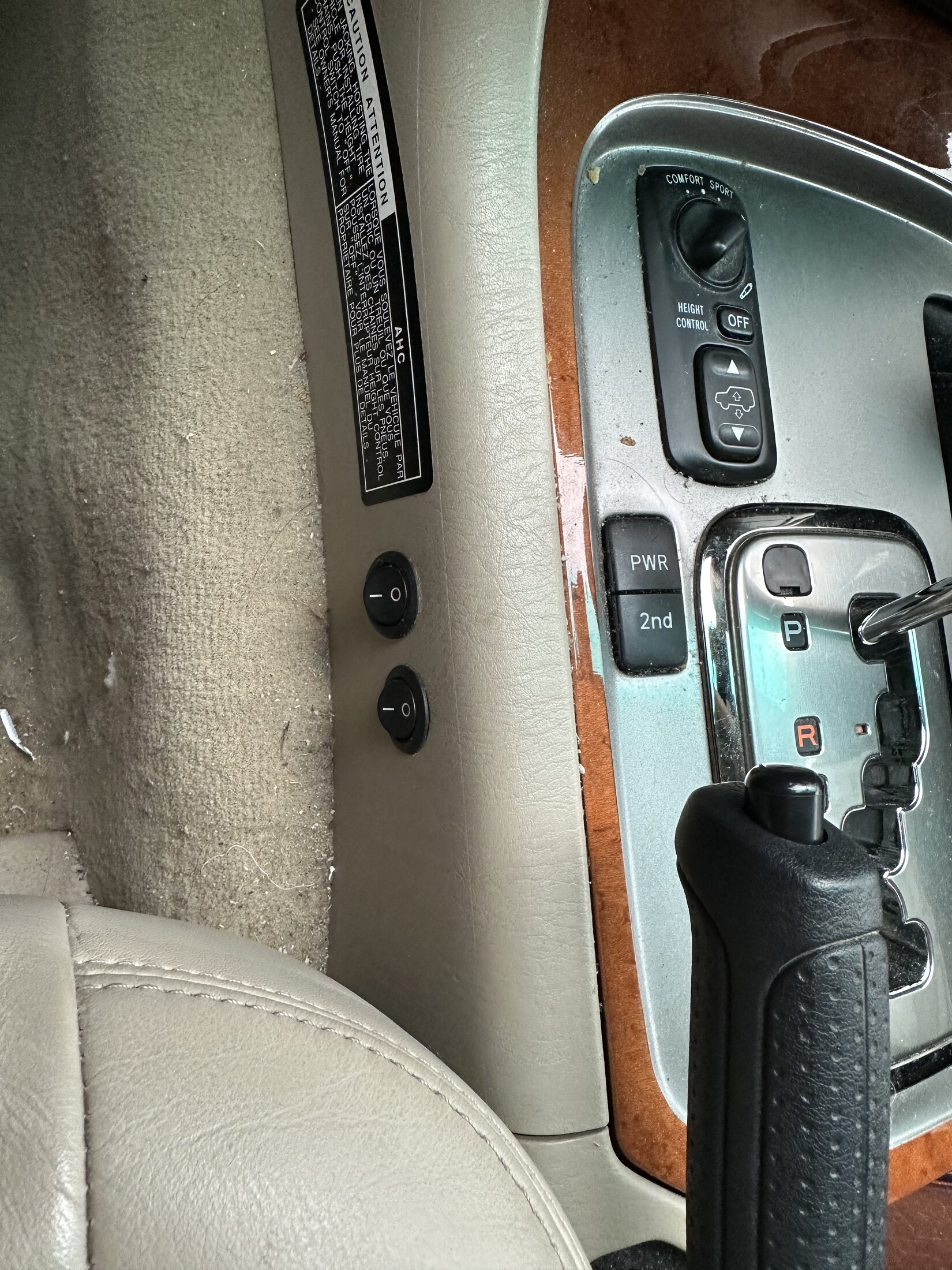

Hi all- I'm considering an '05 LX 470 at a used dealer lot. Generally it's in good shape, strong records, etc., but hadn't gone through detail when I saw/drove it. But there are two items I'd like feedback on:
1) Seemingly random switchgear installed against driver right leg / left side of center console. Truck has NightView but don't believe the switches are related. No aux lighting installed, etc. Are these factory switches or aftermarket? Any ideas on what to look / ask for? (Photo attached.)

Switches look aftermarket to me, but hard to say what they're for.

Thanks for the input. I’m going to ask the sales guy if the records indicate any aftermarket accessories. We turned them on/off and checked lights, brakes, etc, but no luck.
Ignore the aftermarket switches. It's not part of the purchase decision. If you end up buying, follow the wires to find out. The AHC delete though should be investigated more. If you have a micrometer, I would measure the diameter of the torsion bars. If they are around 25.5 mm, they are AHC bars and you'll have to replace.
Btw, the leather looks like aftermarket to me. Just an observation.
You'll have to follow the wires from the switches, no telling what they're for.
