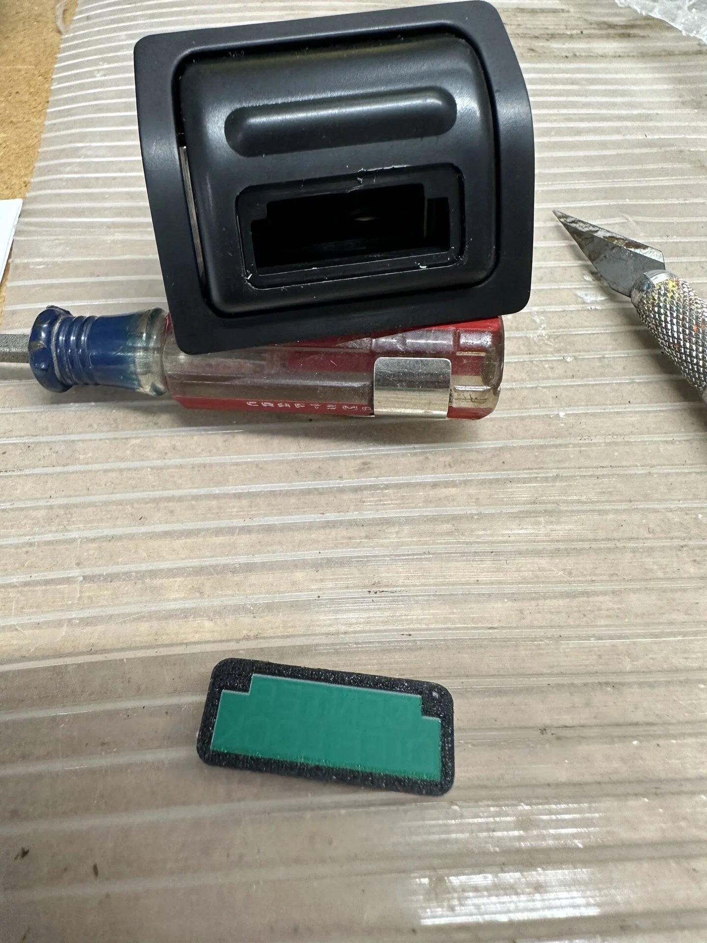

Very interested in making a custom label for my FJ60. Any tips on removing the label window? I've done some prying but I don't want to mar the face of the switch.
A little more fiddling and if figured out that the button face can be popped off to access the label.

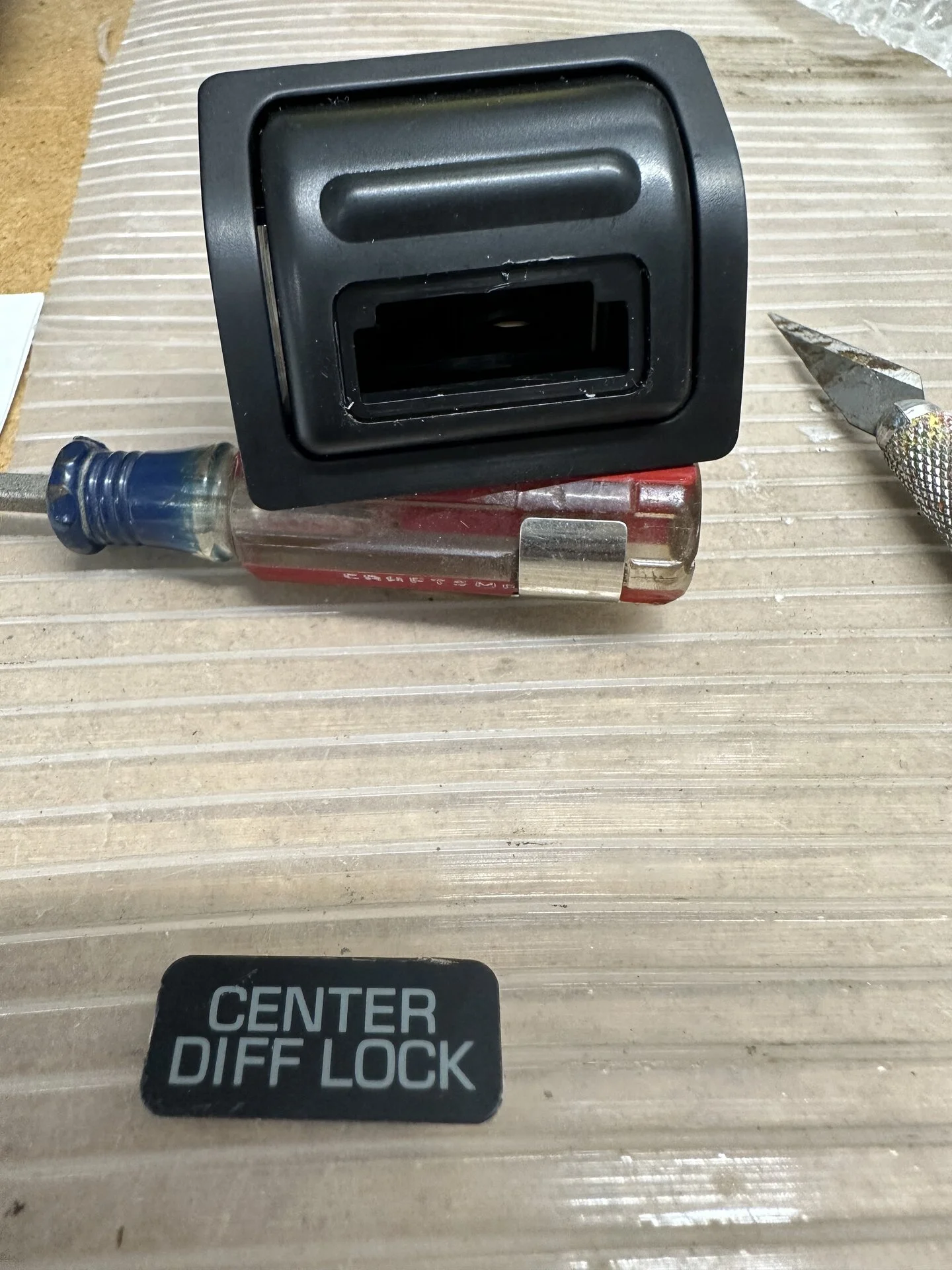

It looks like a similar technique can be used for the early model curved switches. View attachment 3430457View attachment 3430458
To put a pin in this, I made a vector graphic and cut black matte vinyl on a laser cutter. I used 2000 grit wet sand paper to remove the silk screen and put the vinyl on the outside. I had a hard time getting the bubbles out is why I didn’t put the vinyl on the inside. I scotch taped a piece of white paper for contrast.

Does anyone have an elegant way to remove the label inlays? I mangle them up when I try with the razor blade.
I wet sanded with 2000 grit to remove the silk screen.
I’ve had luck heating them up slightly, then getting in there with a razor blade, but it needs to be a very thin razor blade. Definitely requires some caution in order to not ruin it. But I agree with above, wet sanding it helps a bunch before you put the new sticker on it.
