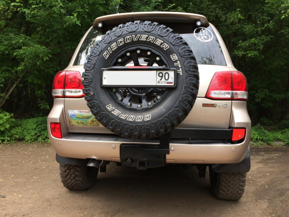

So I am 75% sure this is not a Kaymar now, or it's a significantly modified Kaymar tire carrier, due to the tire being in the center - all Kaymars are only available with the tire at the LH or RH side when closed.
Did however find a Russian one from RIF 4x4 which does have a center swingout that integrates into the stock bumper:
If that RIF 4X4 would fit the LX570 I'd be very tempted to try and acquire one. Such a clean way of relocating the tire. Someone really needs to copy that design in the US if the RIF can't be purchased readily.
It doesn't look like it'll work with USDM 200-series. Our hitches are integral to the rear frame member. Versus this that's hung under. The latch system will interfere with our hitches.
