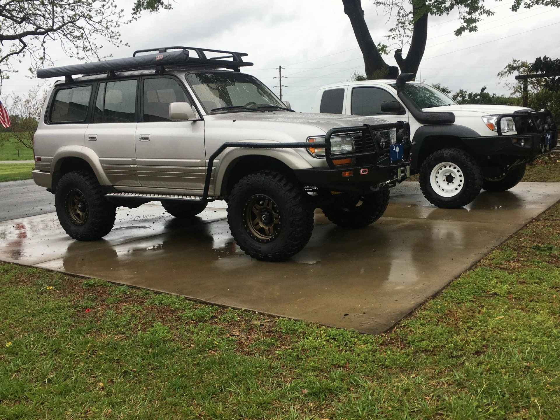

Are you experiencing any driveline vibrations with the new coils? Is your actual lift more than 75mm? I think the front tapered coils are advertised as 3.5”.

The vibes got rougher when I did the suspension for sure. I feel like my OME suspension was getting a little older and maybe not as tall anymore, so when I got the tapered stuff in I definitely sat higher. When I drove into the garage to start the lift, I had to air down to about 15psi, but after we got the lift on I had to remove valve stems to get out, rolling on the wheels. Now that i have the DC driveshaft in there are no more vibes, she's smooth!

I’m on dc shafts front and rear runnng Slee 4” HD’s rear and Dobinson 3.5” tapereds plus 1” spacer up front. The Slee springs lift me more like 5” so I needed the spacer in the front.
I’d like to drop that inch and put the 3” tapered coils in the rear so I’m happy to see your thread. I assume you are not experiencing any rear driveline vibrations? At my lift height my rear vibration couldn’t be cured so I installed a dc shaft and carry a spare rear dc shaft so I’m in $1000 for rear dc shafts! If your rear doesn’t vibrate at all, that means I could go back to a standard rear shaft and rotate my pinion back down and relieve the bow in my rear springs because I’m not so sure the tapered coils would like being bowed. My Slee HD coils don’t seem to mind it.

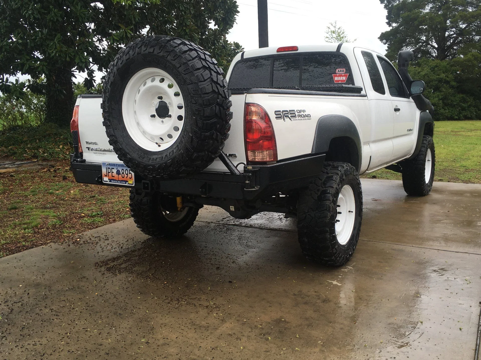

Trey, just a suggestion, but you might want to think about adding this to your list of mods. Relocate your License plate, and license plate light to below your fuel can holder, because your plates almost completely obscured by your spare tire. Not worth the risk of ruining a fun day of wheeling with an expensive ticket, just because the cops couldn't see your license plate.
I think about that all the time and was super paranoid about it going through Kansas on my way to Moab. I need to get to it but I'm feeling super lazy these days, its on the short list though!
