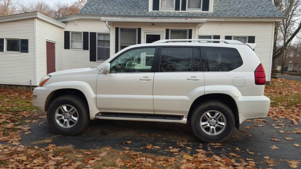

Installed everything last week.
Put washers/spacers on the rear ride height sensors, they spaced the sensors out about 1/4" so it ended up lifting the rear about 3/4".
This worked out perfectly as the truck sits pretty level. I left the Icon coilovers the height that they were set at from Icon.
The suspension feels incredible, even with the stock rear suspension.

The 275/70R17 Cooper Discoverer AT/3 tires haven't rubbed at all yet. I have only done some light off roading with it so far, haven't fully flexed it yet.
