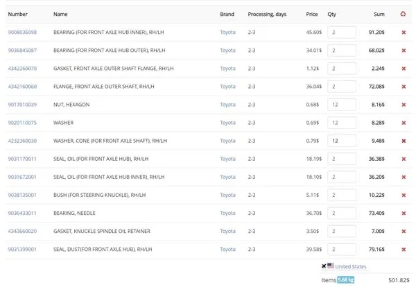

I lifted my 100 and swapped to new shocks, new UCA, all ball joints new, new bushings LCA.
Now, as I still have a rattle, I ordered all parts to have a complete makeover of my knuckle. You will also have it in your hand when redoing ball joints.
Inner/ outer seals, wheel bearings, spindle bearing and bushing, new hub flanges incl mounting hardware.
All that was ~650$ at Partsqou for both sides incl tax/ shipping.
Also decided to throw in front DBA rotors and pads as I’m replacing the bearings already.
I think that goes up to the max you can do.
Here’s my parts list for the sake of completeness.
In my case partsqou and the diagrams via my VIN helped me to not forget a part :-)
And on top of it: I properly treated knuckle, dust covers, LCA with a POR treatment to have peace of mind for the future.
