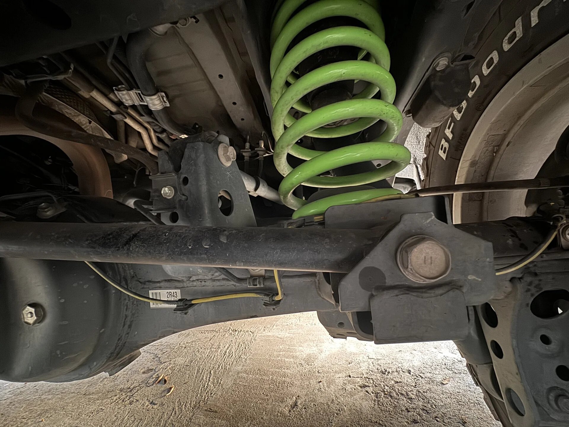

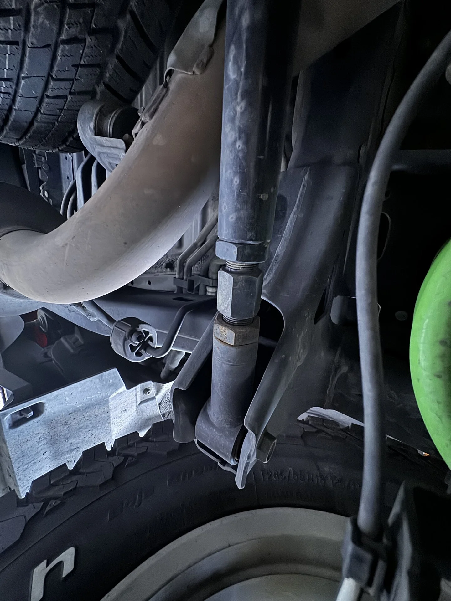

adding the panhard correction bracket made a ton of difference on my truck. suspension is BP-51. also, once the panhard bracket took that member to much closer to horizontal, it elimiated the unreasonable amount off a$$-wiggle I was getting on speed bumps/humps.
So I have the adjustable panhard bar but no brackets. Which bracket did you get?
Go with the DR.KDSS because it's a bolt on solution, EIMkieth is a weld on. This will fix the wiggle over dips and bumps. This will not fix the pull to the right. To do this you need to lower the front by adjusting the collar lower on the strut.
Interesting! I never found the bolt-on during my search. I just did the Panhard Correction Kits - https://eimkeith.com/buystuff/pck/#200.
There are a bunch of threads about the geometry question here, but it boils down to: the panhard should be as horizontal as possible. The adjustable (which I also got at first) does not do this; it just helped get my wheels back in line. The bracket (either bolt or weld) will do the goodness you seek, at least on the back end.

Definitely have some stuff going on. Ordered the dr kdss panhard correction bracket. Going to install that when I get it and level out t the front and go from there.
Stock front height is approximately 19.5" and rear 20.5" or so... about a 1" rake. Most lift kits are designed to handle extra weight. I don't think you have much added weight. So, the rear is high. And then the shop tries to match the front to the rear... so now the front is high. The front lift should not match the rear on this vehicle.
Get the front end down to 21.5-22" and you'll see a drastic change. The rear could be lower too but you'll need different springs. Find out which springs were installed and go from there. You might be happy just dropping the front end and installing a Panhard bracket.
Thanks for you reply, I appreciate all the helpful information. I found a part number on the rear spring and I’m gonna call Ironman tomorrow and see what rate the spring is. The panhard bracket should even out the rear end right? After that I’ll shoot for a minimum of 1” rake in the front. Thanks again for your help
Yes, the Panhard bracket will help in all cases where the rear lift is 2" or more. But the main issue is with the front end.
