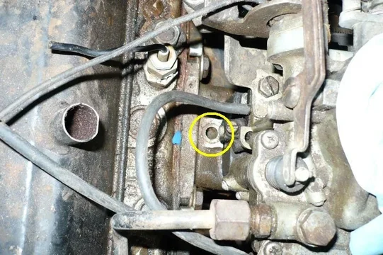

new question
looking down at the intake manifold, between the carb and the valve cover.
i can't tell if this hole goes all the way through, didn't notice it till i was checking for vacuum hoses.
any idea

ooohhh
thanks, i think except for the brake booster line i have everything else done.
