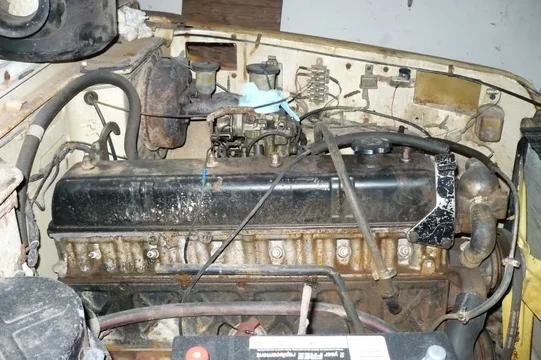

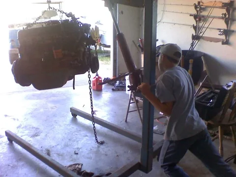

I got this pig 2 summers ago, the 1F motor had been pulled, dissembled, bored out, and was ready to go back together.

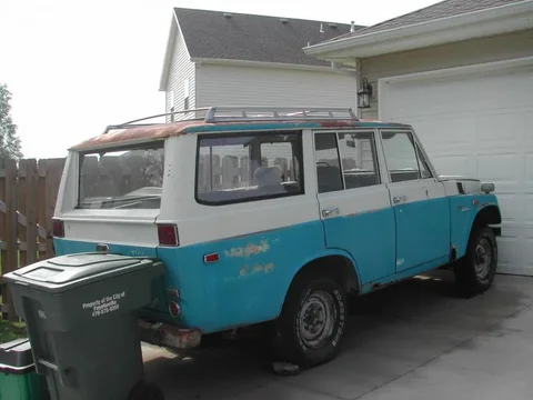

The pig on pick up day.
Picked-up from Arkfay. thanks again

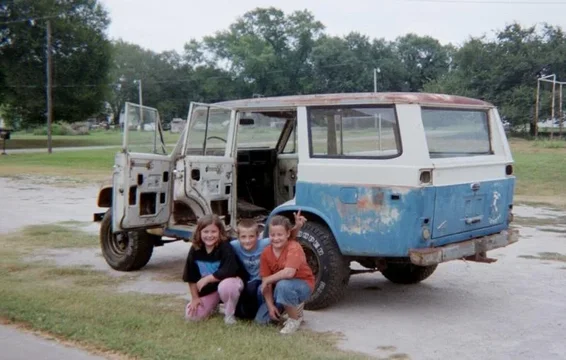

My kids took a couple of days a stripped down everything they could get off. Seats, lights, exhaust, etc.

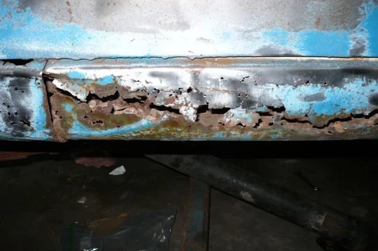

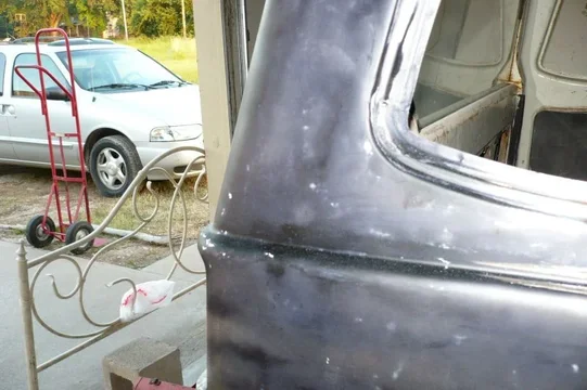

told me the rockers would be shot, boy was she right. it didn't look too bad till i started wire grinding, but......
here is the back passenger corner, it is not finished but i thought i'd put it up
terrible pic, but it doesn't look too much better in person.
not yet :D
edit: that's the primer that turns bare metal black
The typical fix for those rockers is to cut 'em out & replace w/ 1 X 3 or 2 X 4 3/16" wall tubing or maybe Iron Pig Off Road : Toyota 4WD experts has made another run of their sliders ready to weld on. I used 1 X 3 & braced to the frame & left about 1/2" from below the door sill to weld to. I had to refab the front & rear areas of the wheel wells too:
