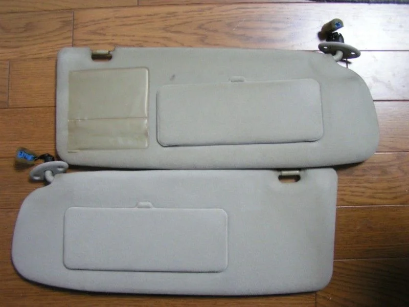

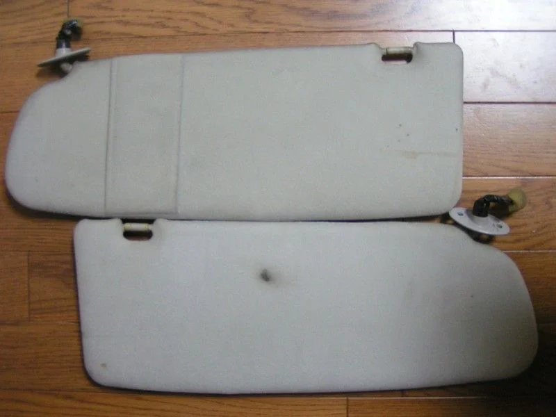

These are the ones, I believe, out of the VX Limited model with the light/mirror.
Do they have ears or these came out of the non-overhead-cosoled cruiser, too?
I'm not here to argue, I just want to know/source the "correct" ones.

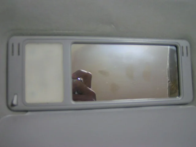

Yep, those look like the right ones that would be needed. No ears, made for the overhead Pod. With mirror, flap and lighted to check one's makeup after a hard days night :)

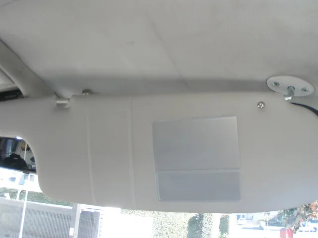

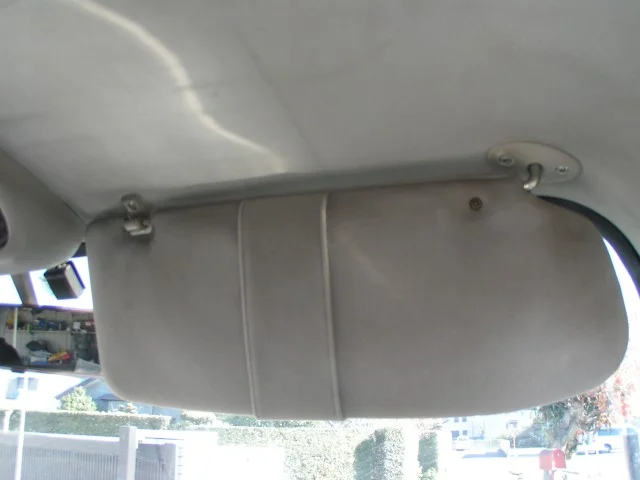

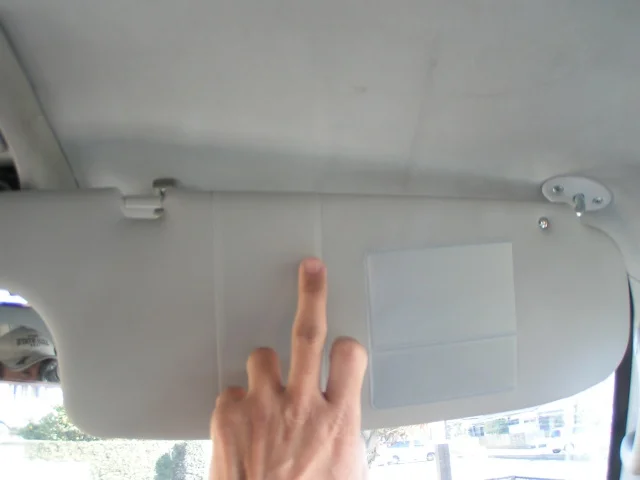

Just to prove that I knew what I was talking about concerning these visors, I had to install them and take pics so I can shut some of you guys up for good.
Pic 1: Original visors in my '90.
Pic 2: The new one just installed.
Pic 3: Voila!!!
Just in case you didn't catch it, it doesn't fit.:D
I'm going to talk to the dealer and see if he would take them back as I told him what I was looking for, etc...
If the color/material of the interior of my rig looks identical to yours in the US I'm going to get the visor PN off of my vehicle info which dealer often requires to get the correct ones.

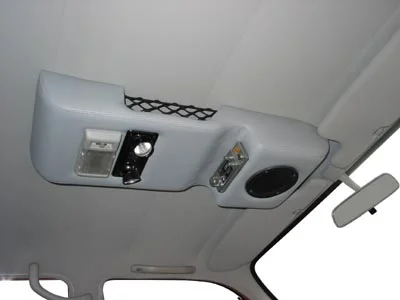

In post #18 with compass/Altimeter it shows it fittting but are the US 80's wired for this option or does this require additional wiring?
Also are you saying the ear less mirrors are required for both addtions?

You have to build a harness and fabricate a non-magnetic bracket to mount the magnetic field sensor in the center of the roof. It is a huge pain in the ass and I would never do it again.

You'll ask Dan the Man here who has performed this mod to get exactly what is involved.
But IIRC you'll need to do your own wiring and if you want the compass then you'll have to wire it with magnetically shielded wires, etc...
I can get it (currently trying to help a couple of members), but it's not a cheap mod. Again, IIRC, I think Cdan said that it cost him something like $700-$800US for all the parts.
