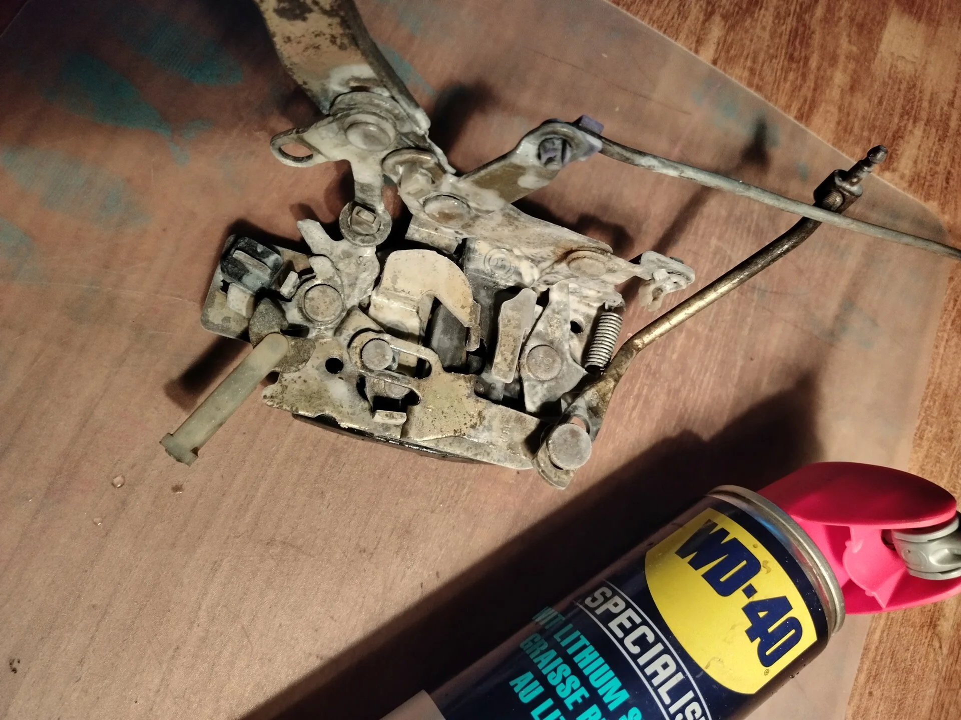

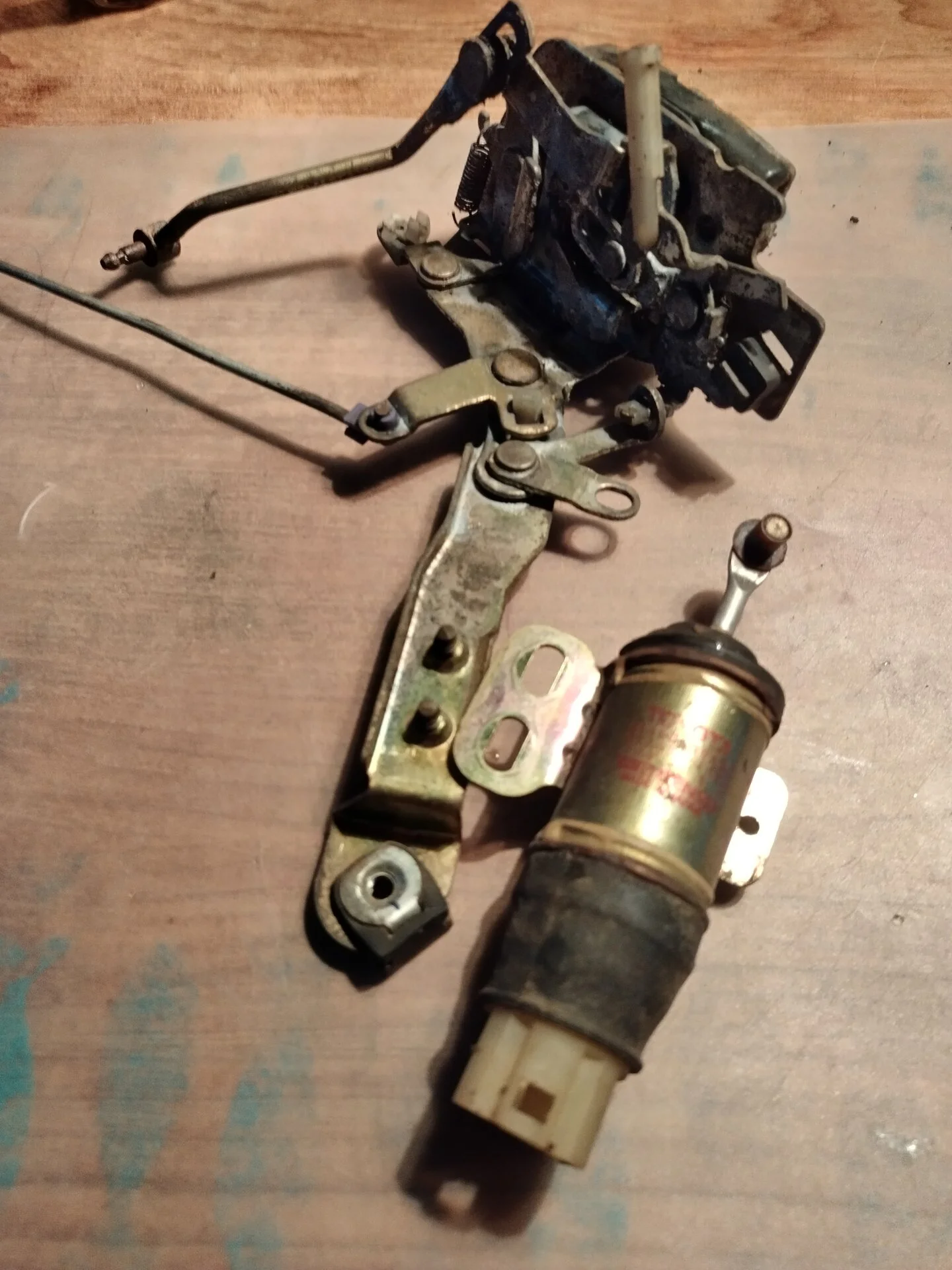

I took the lock assembly out and there were 2 problems:
1) the solenoid was not moving in and out very subtle, so gave some extra fiction in the system
2) the frame assembly (nr 900 on the picture) was touching the locking assembly slightly
I removed the solenoid, cleaned the lock assembly with lots of break cleaner and sprayed all the moving parts with lithium spray. When reassembling the parts I bend the frame assembly in such a way that it was absolutely not touchig the lock assembly anymore.
The door is opening and closing like never before! Feels like just-out-of-the-factory.
