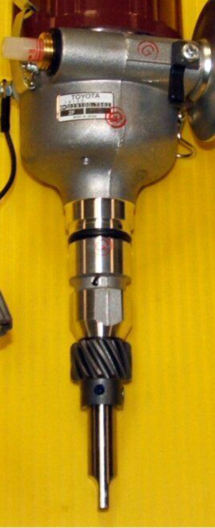

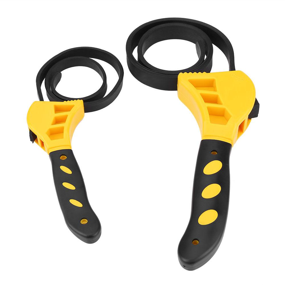

Let me first say, I'd go the penetrating oil over an extended period of time route, post #9 above. If still stuck after the extended period of time, I might try a strap wrench tool like below to try and twist the upper dizzy housing after more penetrating oil. Note, I'd take care as to not damage the dizzy, so I'd be sure and locate the strap below the advancing pot and wouldn't apply a ton of pressure.
