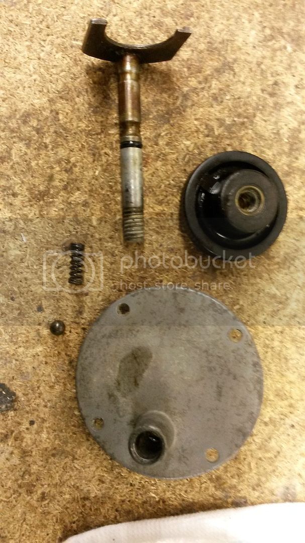

I compared it to the OEM and it's so close to being a perfect match I can't tell any difference. BTW: I'm elbow deep in my own 8274 resto:

My current rebuild will be going in a portable mount from Davesport:

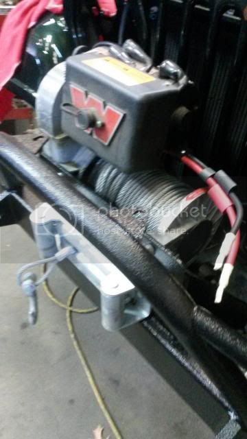

I've already got a 'new' old 8274 on the front (yeah, it's a Jeep):
Looking good.

Had aluminum sandblasted and spool sandblasted then had the spool powder coated black and aluminum grey i was pleased with the results of the finish. I plan on synthetic rope to keep the paint on the spool. Well at least for a little while.
Without having to search all the posts: Which contactor is that? Is it the Superwinch one? What sort of parts are you using for the remote plug? Do you have part numbers for them?
