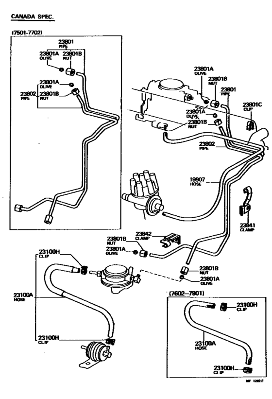

The correct fuel line Nut is :
- 23801B NUT , Union compression
- U will also need a Olive ( Compression Ferrell ) 23801A
Both part #'s are available at your local toyota dealer ,
U will need to simply tube cutter off your existing flare , install Nut & ferrell and insert your tube into your Now @Racer65 Carb. Fuel inlet Union
this method using the correct OEM parts will be way easier then trying to monkey around with adapters , i can see u have a SAE
Brake line fitting , and going from metric to SEA compression will be VERY challenging ..............
@Vae Victus
Note : the tube size correct OEM is 5/16" inch to mate with the union on your @Racer65 carb

I personally buy a 5' Long Brake line straight stick of CNUI , Copper Nickle Alloy from advance auto parts , and NOT the roll ,
this way u start out with some nice straight lines , I start from the pump and work my way up to the carb , i have found this approach gives way better results then carb down
5/16" is the toyota metric equivalent in SAE , there is little to no difference
I did a 1979 FJ43L-KC Fuel Lines not that long ago , I had a return line too , double the work ! , take Note of My routing & bends Locations

I do think that there is enough slack to try cutting off the flare and replacing with the right nut and olive and using the existing line. We will see.
Rainman has also said he'd come over and do a custom line with me if needed, as he has some of the nicopp 5/16" lines. The steel tubes used by whoever made the existing line is a little crimped in the 90* bends, so it may be better to make a new one.
