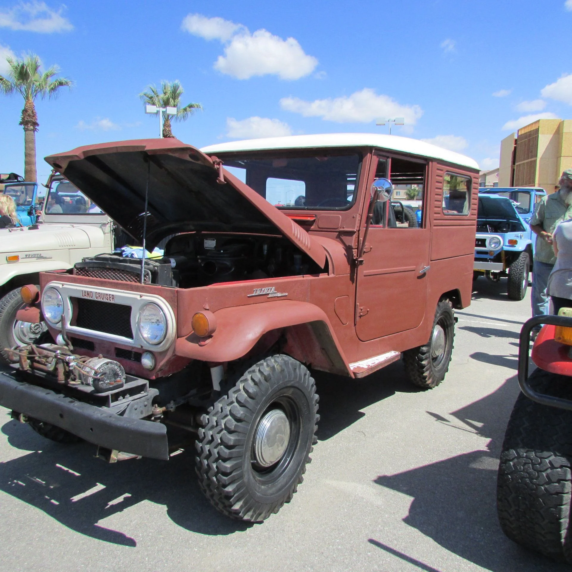

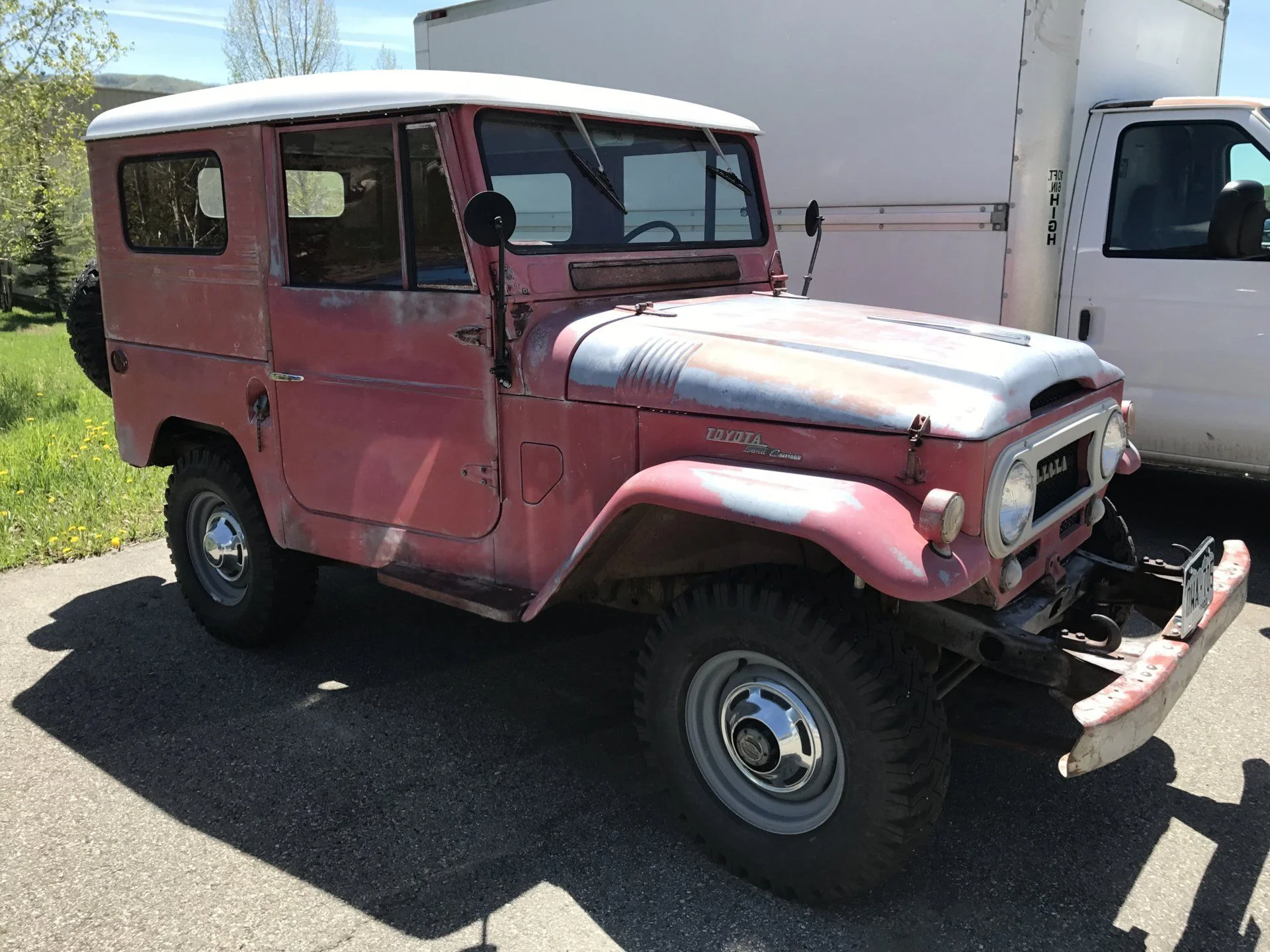

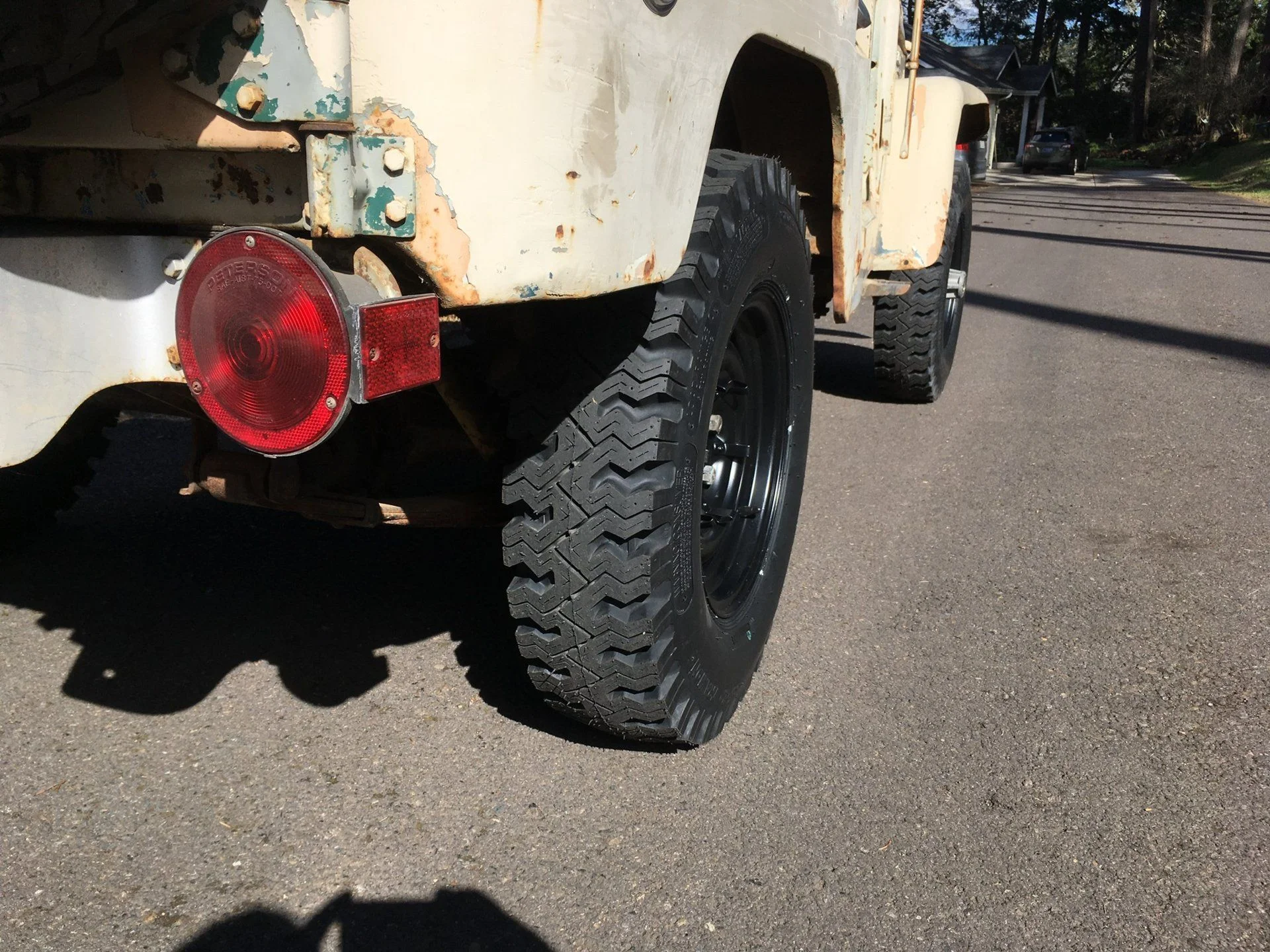

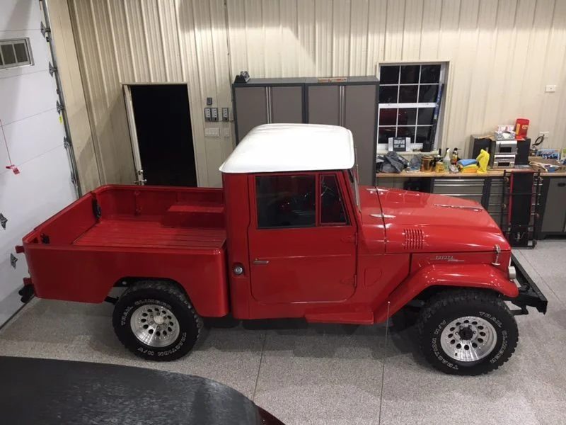

I just put the 7.00-15 Super Traxion on my '64 FJ40 on the original riveted wheels with new tubes. I like them a lot.

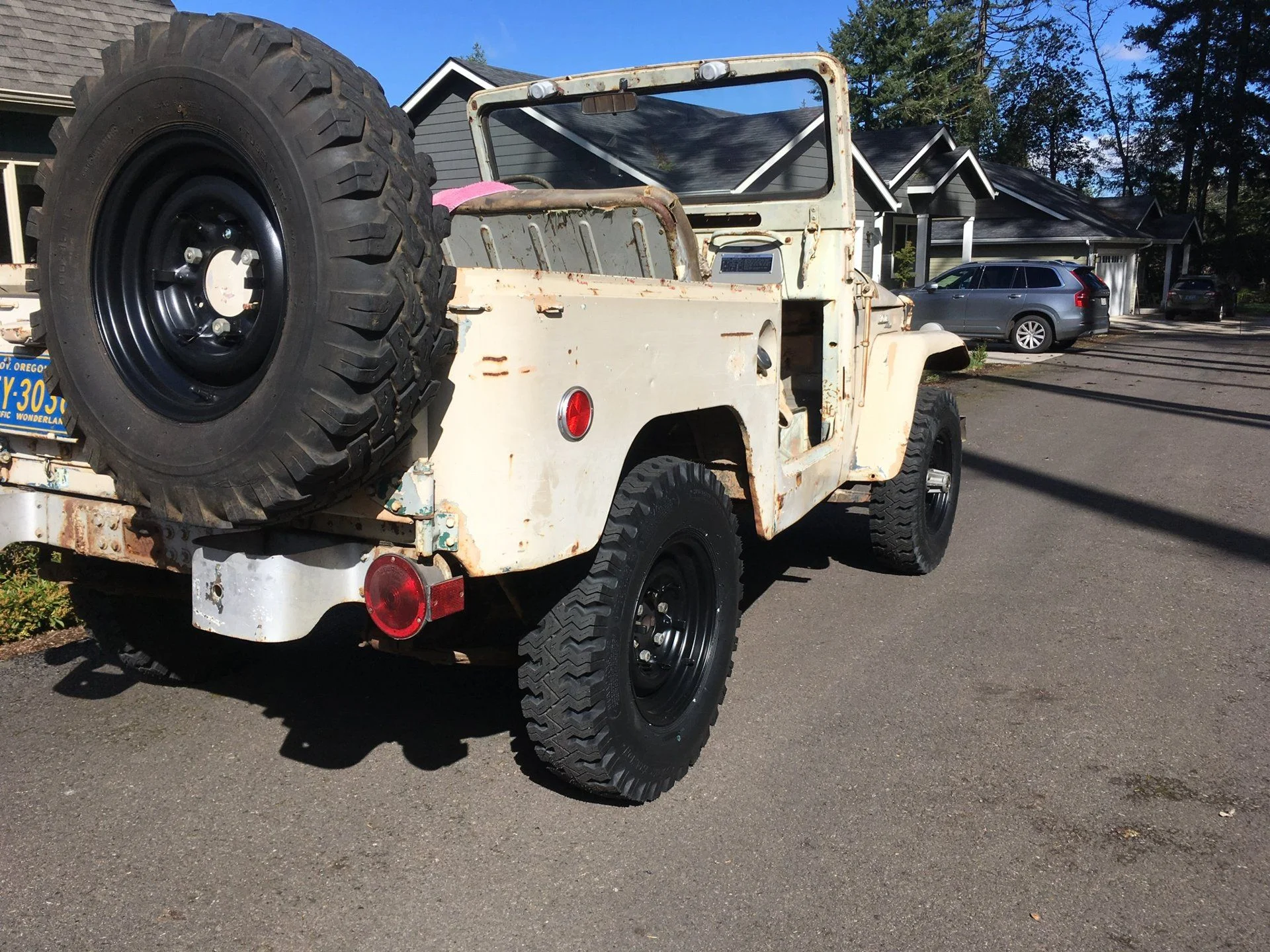

I Went the same route as OregonFJ-- after seeing his rig

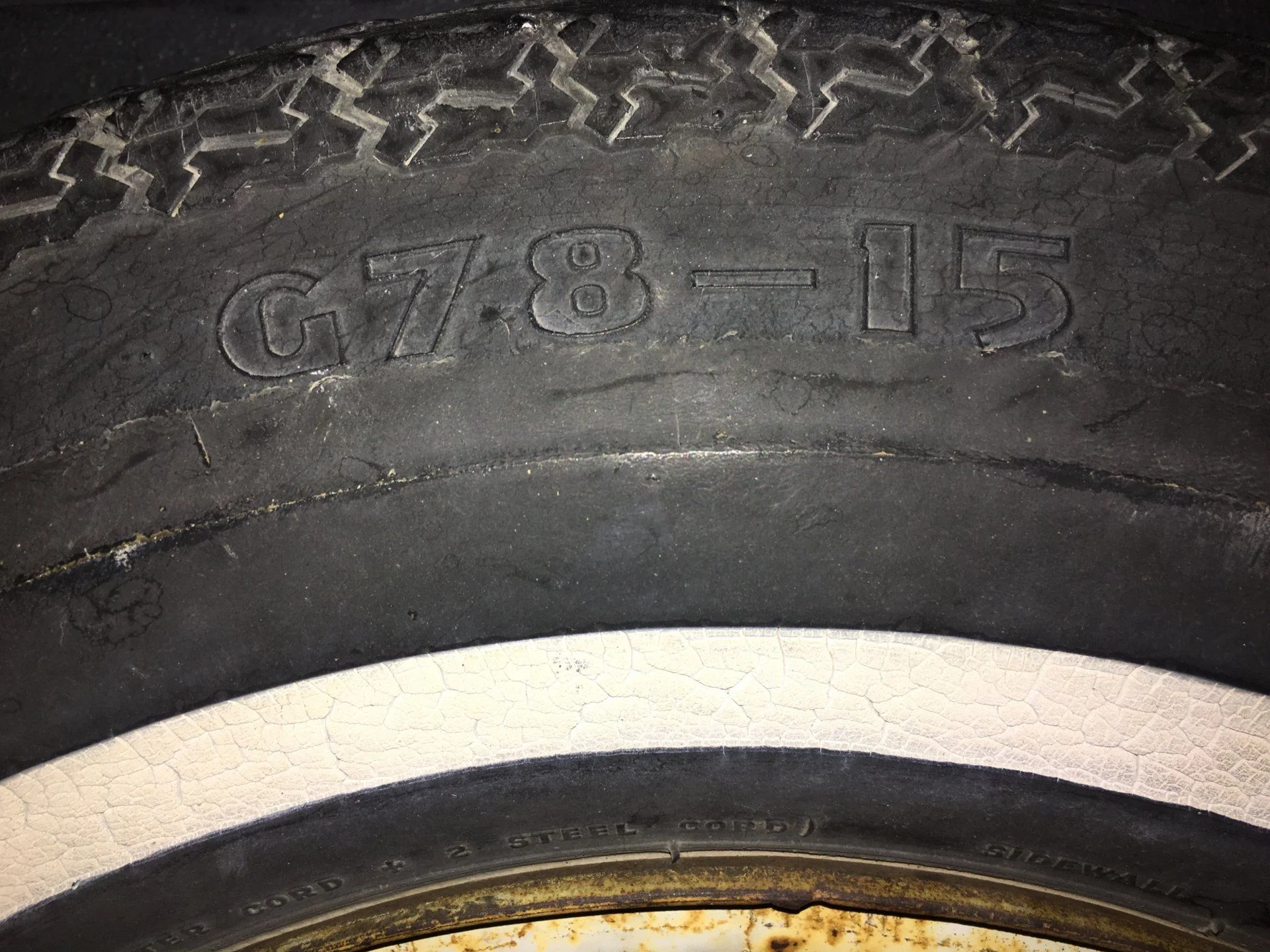

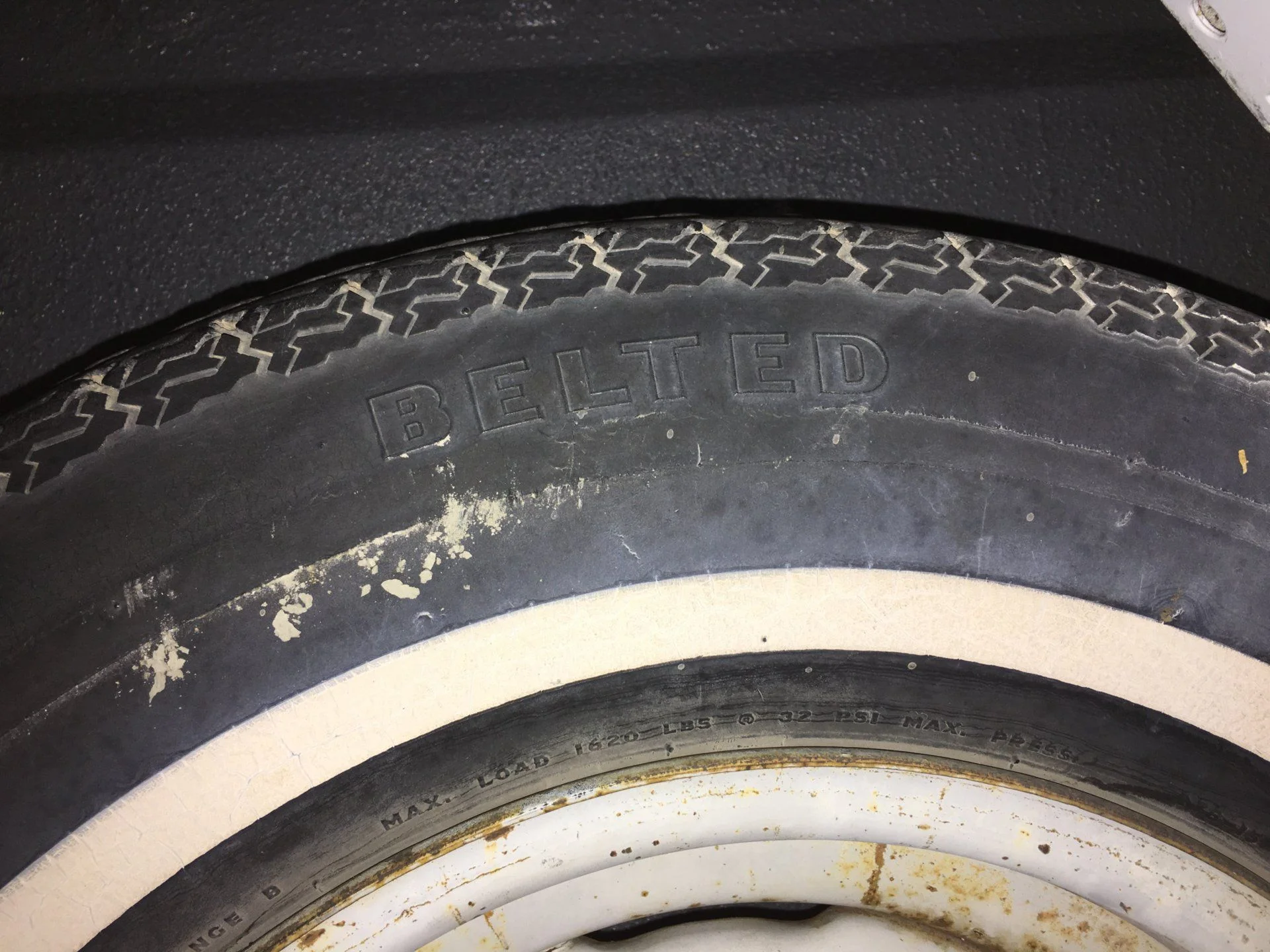

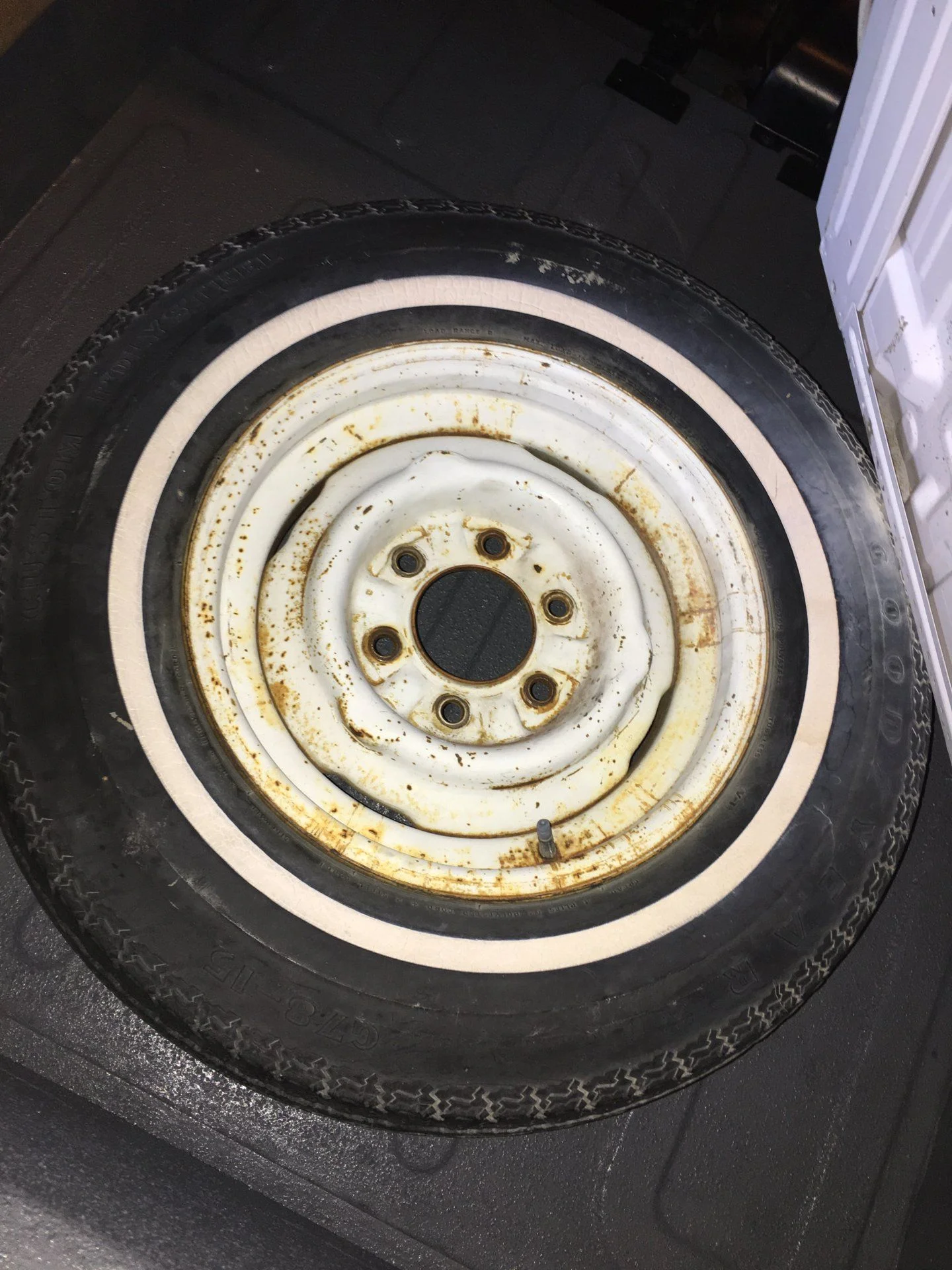

As far as I can tell this is the stock spare
edit- for my 1974
Can those STA Super Traction’s be run in a tubeless manner or do all bias ply tires have to be with tubes?
The set I got (from Summit Racing) are tubeless, as long as you have the later welded tubeless wheels.
Nope, that's a Chevy wheel. Tire is one size smaller than stock on the later FJ40s, and is not a Japanese make. Plus Toyota never fitted whitewalls, ever.
