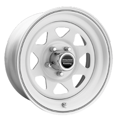

Hey, folks. Could someone please tell me what style of wheels came stock on 1974 FJ40's? Both with clips for hupcaps and simple wagon wheels? And in what colors? Any help appreciated. Does the wheel below look like a stock 1974 wheel (although painted ... shudder)

your rims should be hubcapclip 15" gray steelie rims (welded was stock for 74' model)
Rim info...
Rim Colors for USA market
E-60 body color
61-67 black rims
68-72/73 gray rims
72/73-7/80 gray outside only
8/80-84 white wagon wheels

FWIW, those are the later original Toyota wagon wheels. I like them on an earlier rig.
Wheels look to be painted steelie wagons
Looks like the wheels used on the FJ40 starting with those from 8/80 (81 model) and later painted. Not sure what a wagon wheel is. Seems it was common for dealer to put a white spoke wheel on the FJ55s but these were not stock. 60 series had these wheel but were chrome. The center can fit either as well as the solid steel wheels used on pickups.

The steel wheels with the clips were factory yet a lot of dealers switched them out with the common white wagon wheels as an up grade.The wheel you have is of a later 40 or 60 that is OEM based on the design although it would have been either white or chrome.

Those were not stock on a 74 40, but someone else mentioned that.
But those wheels did come stock on 1st generation 4Runners. I had a black 85 with gold graphics and gold "wagon" wheels like that.
