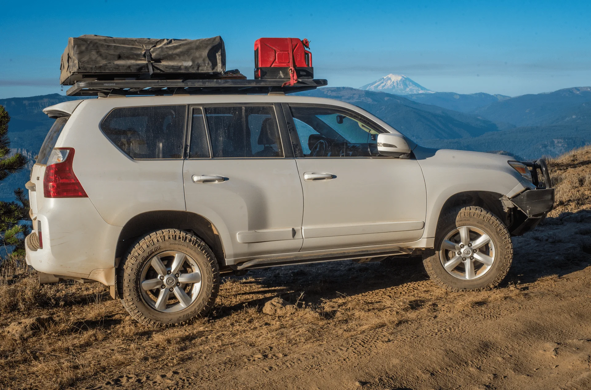

I ran mine like this for a few months before I went to 285's on aftermarket wheels and bumped the lift another .5-75". This is a Ironman FCP lift set to 2" with 255/70/18's (32.1x10x18) on the factory wheels with NO wheel spacers.
Wow, I really like that look, I went through your entire thread a couple of months back and I think thats where I got the idea for the lift with the stock wheels. did you have any issues with tire rub and how did it drive and handle?
No rubbing, it handled great, probably the best the truck rode including when it was stock. I should have stopped right there lol.
Haha no, I'm glad you kept going that thing is a beast! Did a spare that size fit under the truck. Also, would you have gone any taller? If you kept that configuration?
Yes the full size spare fit, but that would be the maximum tire size you can squeeze in there. I don't think the bump from 2" is needed with that size rubber and setup. I really didn't need the extra 1/2-3/4" bump I gave it with the 285's but I just couldn't help myself and it was purely for aesthetics and stance.

Hey, did you lift the front just 2" or a bit higher to "level"?
In that pic it was 2” up front. I’ve since bumped it another 1/2-3/4” for larger/wider tires.

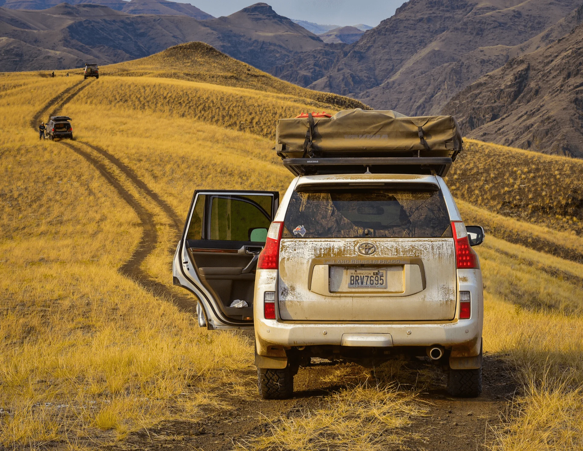

Like Tex68's original setup, I upgraded to 255/70R18 on stock wheels (GY Duratracs) and have been happy with that balance for snow in winter and trails in the summer... I haven't been able to put the spare back under the truck. I'm tempted by 17inch wheels but would rather put the money elsewhere.
I went Radflo 2.5 adjustable coilover suspension and have been happy with the ride. I selected this to find a balance for the terrain I drive and avoiding need for UCAs.

The other cosmetic tweek for fun, was some global trim replacements for rear of truck (remind me of f-road & Kakadu NP travels)
That picture is epic. 👊 But has me major confused lol. Is that Kakadu? The Prado has washington plates. Whaaaa?
I like the prado fording picture from Iceland.
To clear the confusion, this is my Washington licensed GX (in Oregon) with license plate surround from ebay Japan and swap of "L" to "T".... I don't have the patience for the full prado swap that a few folks have pursued, but I made this minor cosmetic tweak for fun. Most people don't notice (fine) - some Toyota LC folks get a laugh...
