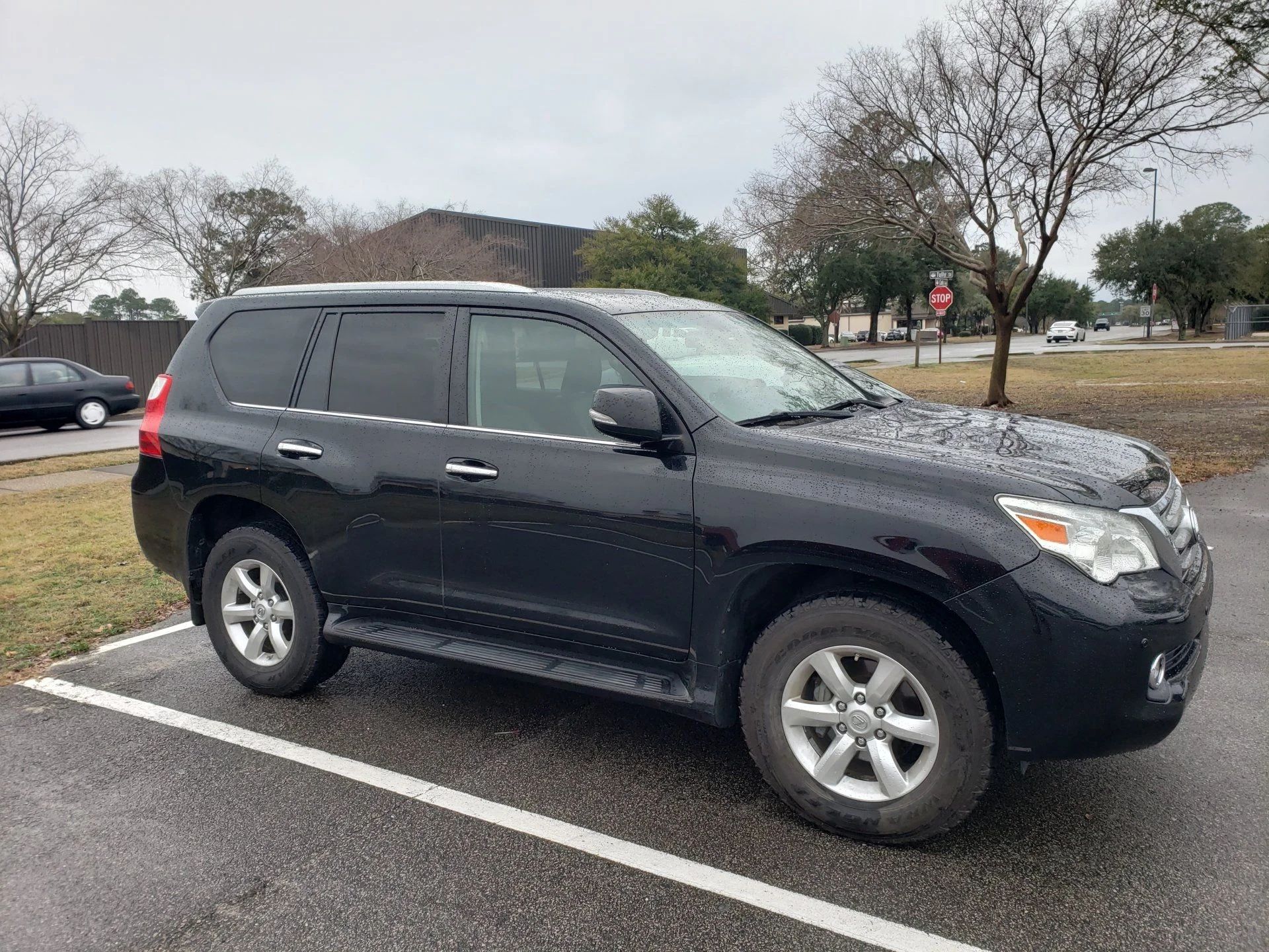

I've got 255/70R18s (32") on my non lifted GX right now. I only occasionally get a rub while braking+turning into my driveway.

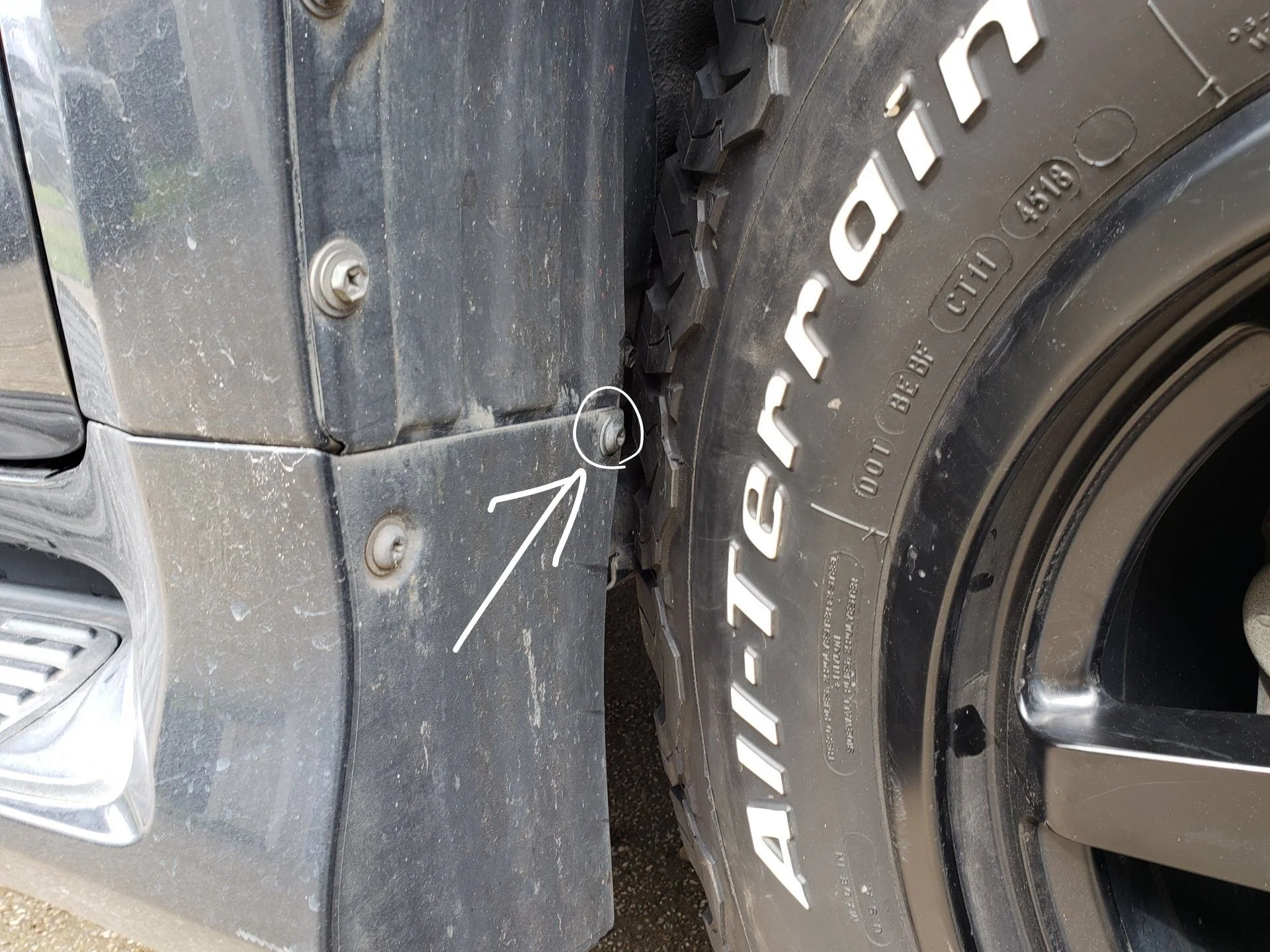

The culprit is this bolt. This pic has my 285s that obviously won't fit until I get my lift installed.
I’m running 275/65/18 duratracs on stock height. All I had to do was heat gun/massage from fender liner and I removed the pictures above bolt and zip tied the plastic back.
I've got 255/70R18s (32") on my non lifted GX right now. I only occasionally get a rub while braking+turning into my driveway. View attachment 2650904View attachment 2650905

I have a Dobinson 2 inch lift, SPC UCA's and I did have 275 65 18 Toyo AT3's on factory 18 inch rims. It rubbed but I did not modify anything at that point. I put a Firestone 275 65 18 AT tire on spare and it fit without factory hitch installed. I subsequently put Black Rhino 18 inch rims (w zero offset) on and kept the same tires. I also had the factory hitch installed and it was at that point that the spare did not fit. I have since broke out the heat gun and now have no rubbing.
What rubbed before you broke out the heat gun? would a narrower 255/70/18 prevented the rubbing?
Narrower would not have, shorter would have. The front and rear of the wheel well. When I had the factory rims and the 275 65 18's, they rubbed on something else.
