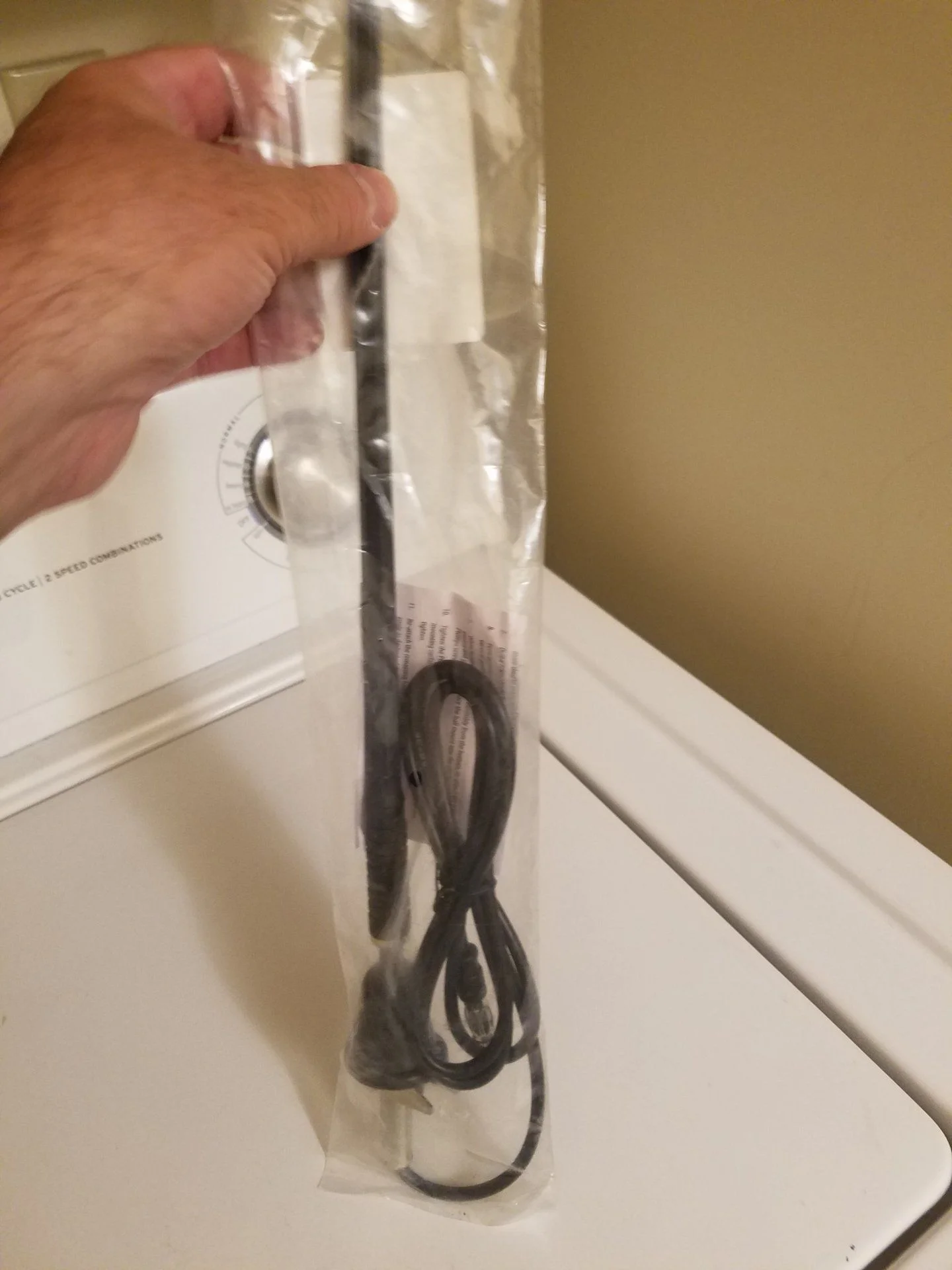

I need a new am/fm antennae for the 60. I've broken 3 since I took the stock automatic one out (or broke it). Any recommendations for a good flexible off-road fixed one?
here is a pic of what I bought, yet to be installed. I assume that it came from Amazon. I also bought an extension cable since my radio is in the console rather than the dash.
Thanks Elbert. The only thing I really hate is that little plastic taper ring that mounts to the fender. Those things crack and break over time and then it's junk. I'm looking for something with a heavy duty base, metal preferred.

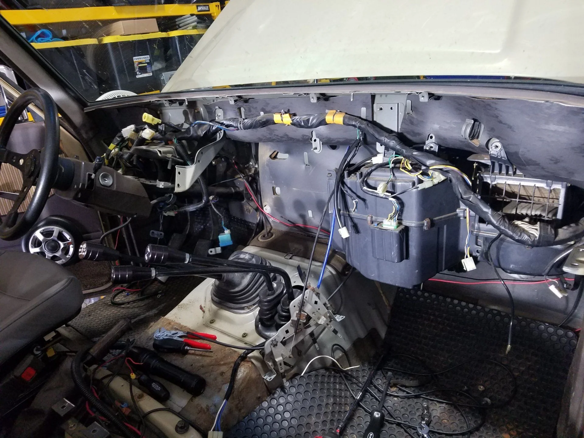

For anyone who's had the fun of swapping out the heater core on a FJ60...did you find that it required removal of the two heater hose pipes that run through the fire wall, or could you leave those in place and just mate the heater core with the pipes once you removed the old heater core? I'm hoping the small clasps that hold the heater core to the pipes that run through the fire-wall do not break when I get there to remove them, because I have no idea in @##$#& where you might find replacements.
I'm hoping to make headway on this heater core project ...this weekend. Of course I prepped the dash about a fewyears ago in my attempt to set a world record for longest time working on same project....someone has to go for the gold! :)
So I haven't seen a 60 up close, but I'm guessing you will have to disconnect the hoses from the engine side before you can pull the barbs thru the firewall. Unless the hose connections are separately removable from the core, but I can't say that I've seen that configuration.
Wait, I reread your post and it sounds like the pipes do separately from the core? If that is the case, the if there is room to move the core around enough, then I'd see no reason why you couldn't pull it all as a unit.

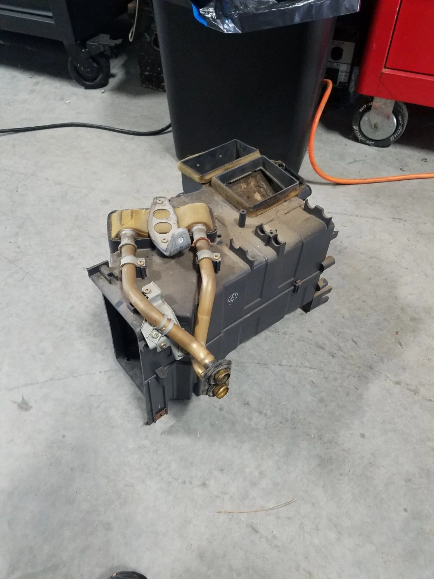

I've done heater cores on normal cars/trucks and on those the pipes that run through the firewall are part of the heater core. ON the FJ60, the heater core has two short pipes that mate to the heater pipes that actually run through the firewall, so one heater core, and two seperate pipes, that join the heater core by some crazy ##$% butt splice with o rings and some clasps. (Yeah I'm not a big fan of the design). I'm getting advice to pull the heater pipes out with the heater core as one and then separate on the bench. Throw out all pre-conceived notions on a "normal" heater core arrangement. See beautiful diagram here Page 188 Land Cruiser 60 and 62 Front and Rear Heater
front heater core

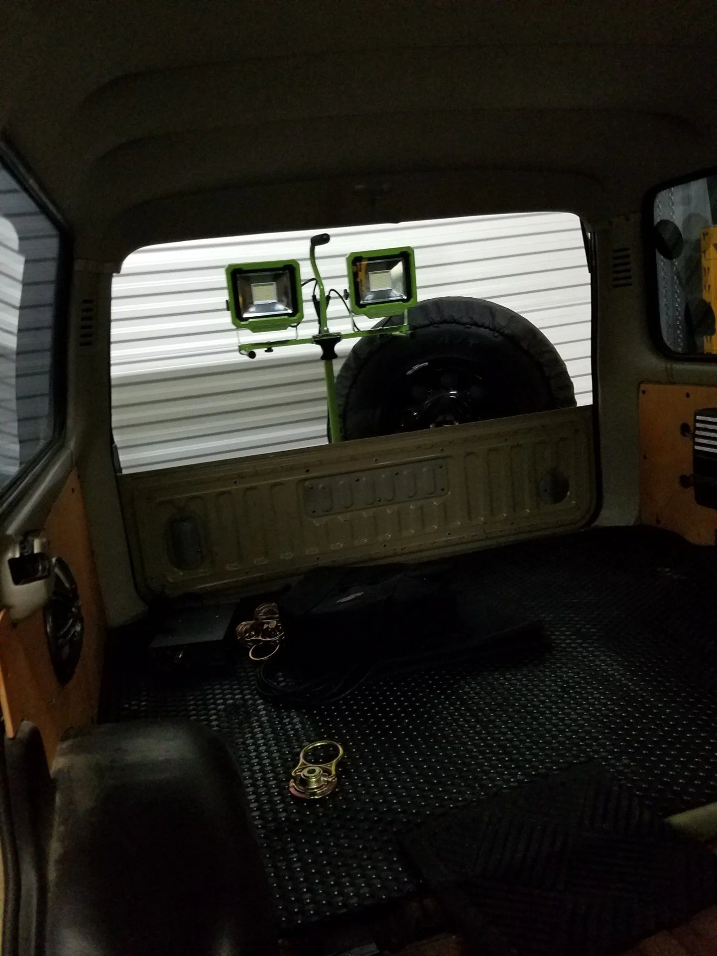

you need one of these too, dual head LED shop light....its bright as ##$% and does not put off much heat. I put the light at the rear and let the rear seat down and its working great without getting in the way or giving off a bunch of heat.
Well after a few choice words and frustration combined with aggravation, here is where I'm at.
I posted up some notes in the main forum on the thread I linked to. A couple of notes (a) the evap core does not have to come out nor do you have to discharge the ac (2) as you can see I took the entire dash out (3) shifters don't have to come out. (4) yes it sucks. Do you have to tear down teh entire dash...maybe not, but I was trying to ensure I did not break anything and I expect the more that comes out the eaiser it will be to get the heater core back in. I'm wondering if the heater core pipe grommet is installed from the engine side right now. I may not get to fired up on working on the re-build for a few days since I have to get some ear surgery next week which I hope will not be too much of a pain in the @$$ itself...yet to see. Anyway, the magic now will be the install and getting everything working right. Just about all the foam or what use to be foam in the duct work crumbles like dust on touch and its useless. I'm considering on how I might deal with that.
