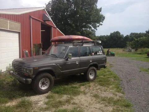

Trail rigs are never done, they are all under construction to some degree.
Mine is currently in the shop for paint.

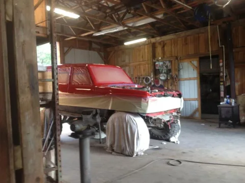

painting a trail rig... same color I assume..getting all over new exterior?
I need to do something with my roof...I may get it coated/linexed or something.
Nope , she's a red head now
