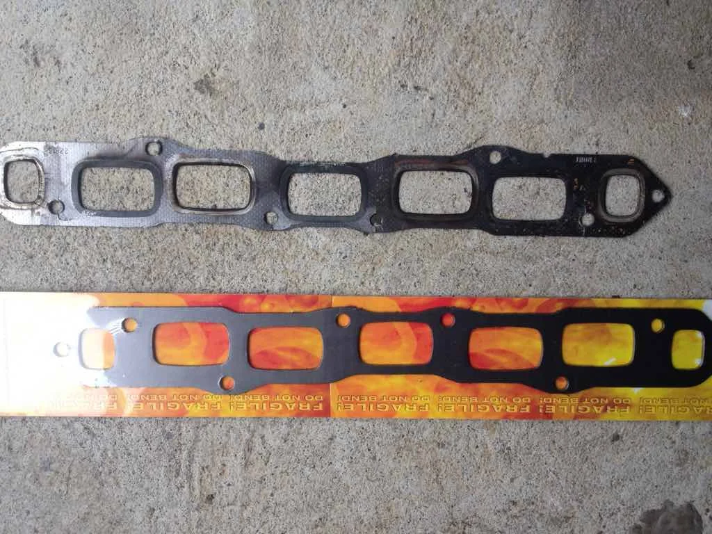

Well it starts fine and runs fine over 2k rpm w choke on. As soon as I dump the choke, it stumbles & dies. Drove it around the block, pulls great w new 488s and has plenty of power but I'm guessing still vacuum leak. I'm outta town all week so i dropped it off at a shop down the street. I know the guy well & he knows 2Fs. We will see but I'm tired of FN w it :(

Gotta call from the shop & I feel like a dumb ass. Apparently the underside of intake manifold for 5/6 had a slight air gap & it sucked in the gasket. Can't see from above, guy said he had to go underneath w flashlight. I ordered double thick remflex gasket & new intake to head bolts. Stay tuned for more fun.

That Remflex gasket is the shiznit. Well worth $50 plus ship. Also used all new bolts. Thanks for all the help guys & for listening to my bullcrap. See ya soon
