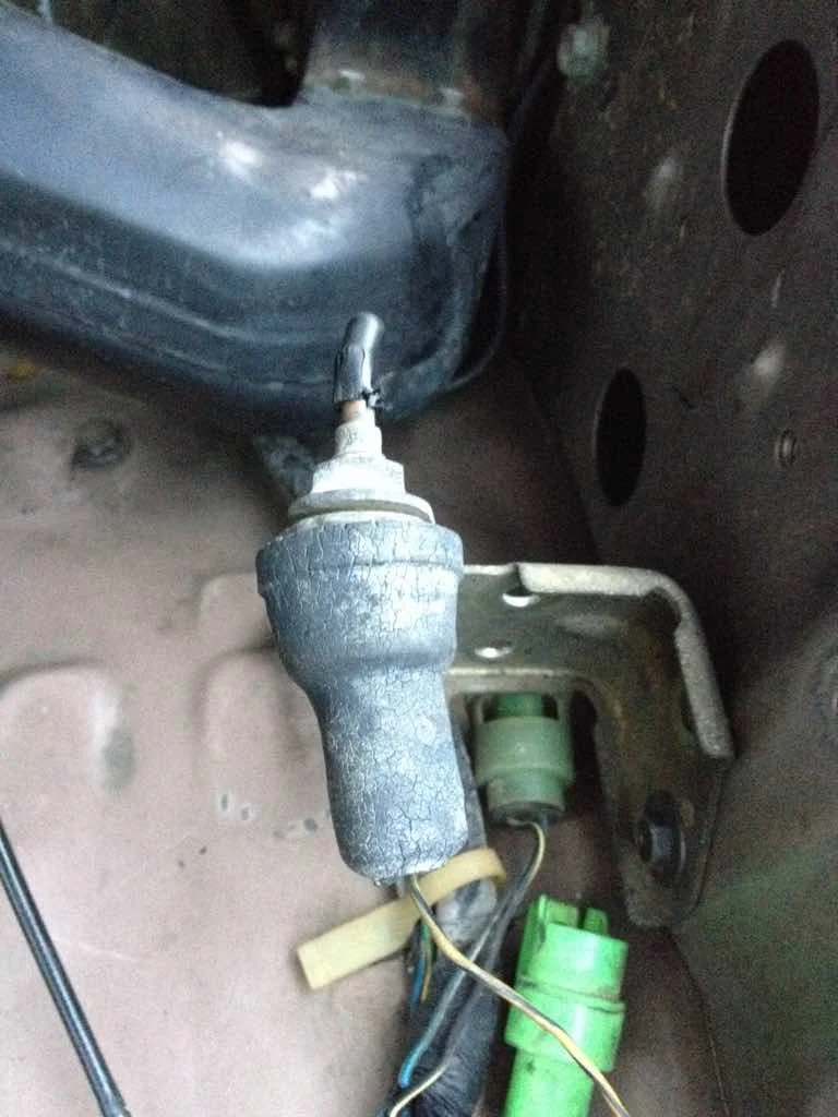

Is the fuel cut solenoid getting power? Mine came unhooked and it would run at speed, but it wouldn't idle.
Do you mean the solenoid on the carb or the fuel cut vacuum switch on the passenger fender? I know i have the carb solenoid switch hooked up correctly because i can hear it click on/off when i hit the key. At some point, I was told to just cap off the vacuum port on the fuel cut vacuum switch (i think Trollhole told me to) but now i'm wondering if i need to apply vacuum to this? My new TH carb doesn't have a FCVS port on it so i wasn't sure what to do with it. i'll try and post up a pic, it might be a 60 only part that came with all that nice BS emissions crap.
FCVS

My decel fuel cut thing on the fender was removed when ULC/ACC did my desmog. It idled fine, but cut the idle circuit off above 1800 rpms. The fix (since I didn't have the part) was to ground the wire going to the decel solenoid thingy. It might not hurt to try that.
