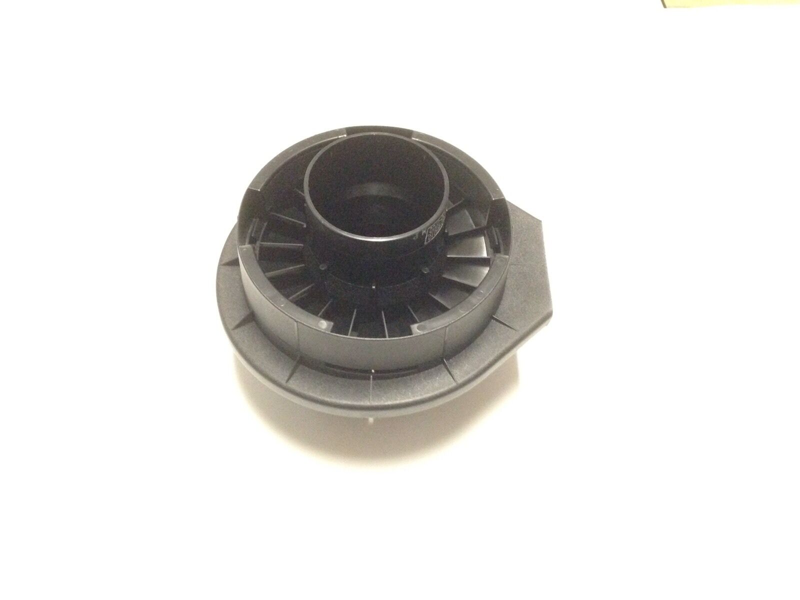

Any particular reason you prefer the mushroom cap?
I did it old school ..... With pencil and paper.
My answer was somewhere between 2.5" and 5".
The ram head got a pretty thick ice sheet on it, which reduced its ability to evacuate water (or freezing rain) due to this. The channels on the head became iced over. A significant amount of water was in the air filter housing. I am trying to decide on a donaldson clear cap (the ones you can empty) , mushroom cap as you call it, or a Top Spin HD.
I like the top spin and the clear cap, does the mushroom cap have any precleaner capability or is it a proper cap..... does it have any vanes like the top spin?
It has vanes but the design appears to be somewhat simple.
Thanks all, i think im good now, just need to measure my end and order. I really appreciate the pics Charles, and sean thanks for the part numbers.
How much boost you planning on the turbo. My pre cleaner became a big restriction as it was only good for 450cfm. 10" bowl 3" snorkel
Thats why i went with a top spin when i had my supercharged nissan. Not for a while im afraid. the turbo sadly is near the bottom of my list at this point. Took her through the mountains a few weekends ago, was slow but manageable. I much rather address the rust, get a rear tire carrier and cash for road trips at this point
