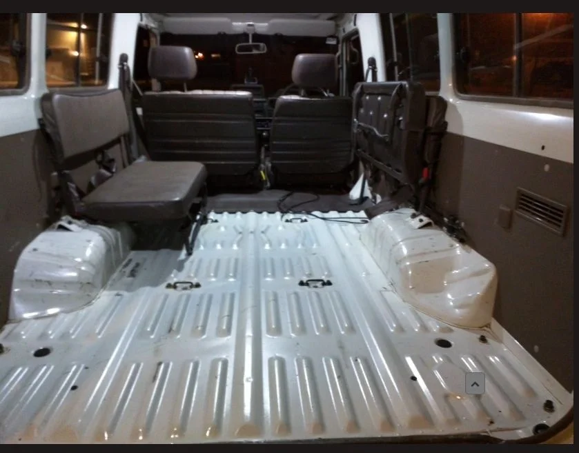

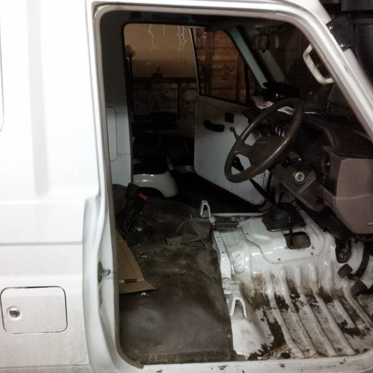

Working my way forward from the rear doors, taking apart, cleaning and reassembling. I wish my before picture came out,it was too blurry. Took me 4 hours to start at the rear door hinges, take the doors off, disassemble, clean, treat and reattach. I could not figure out how to get the rear left barn door interior panel out. I removed all the clip inserts, removed the screw for the door opener, but it wouldnt come off. I hate forcing things so if anyone knows a trick or two let me know. Ive reassembled for now and will address later.
Essentially all the stripping is getting removed, inspected and cleaned. The surfaces are washed with degreaser, then rinses with clean water. I went through 4 buckets in the first hour. There was red dirt everywhere..... Have some ospho in a spray bottle which i used to treat the rust spots. Im planning to repsray in a year or so, so in the mean time I am using a rattle can clear i can use to cover the ospho with until then.
So far ive made it to just behind the front seats. Need to remove the last set of rear seats before i dig inot that area. Im getting old... my back is yelling at me but i am happy with the results.
Things found so far:4 6 oz fishing weights, various nuts and screws, another cassette tape: unknown music, a "toyota" labeled open mouth wrench (presume to be from the stock tool kit), a metric s*** ton of the scariest bug carcasses i have ever seen.

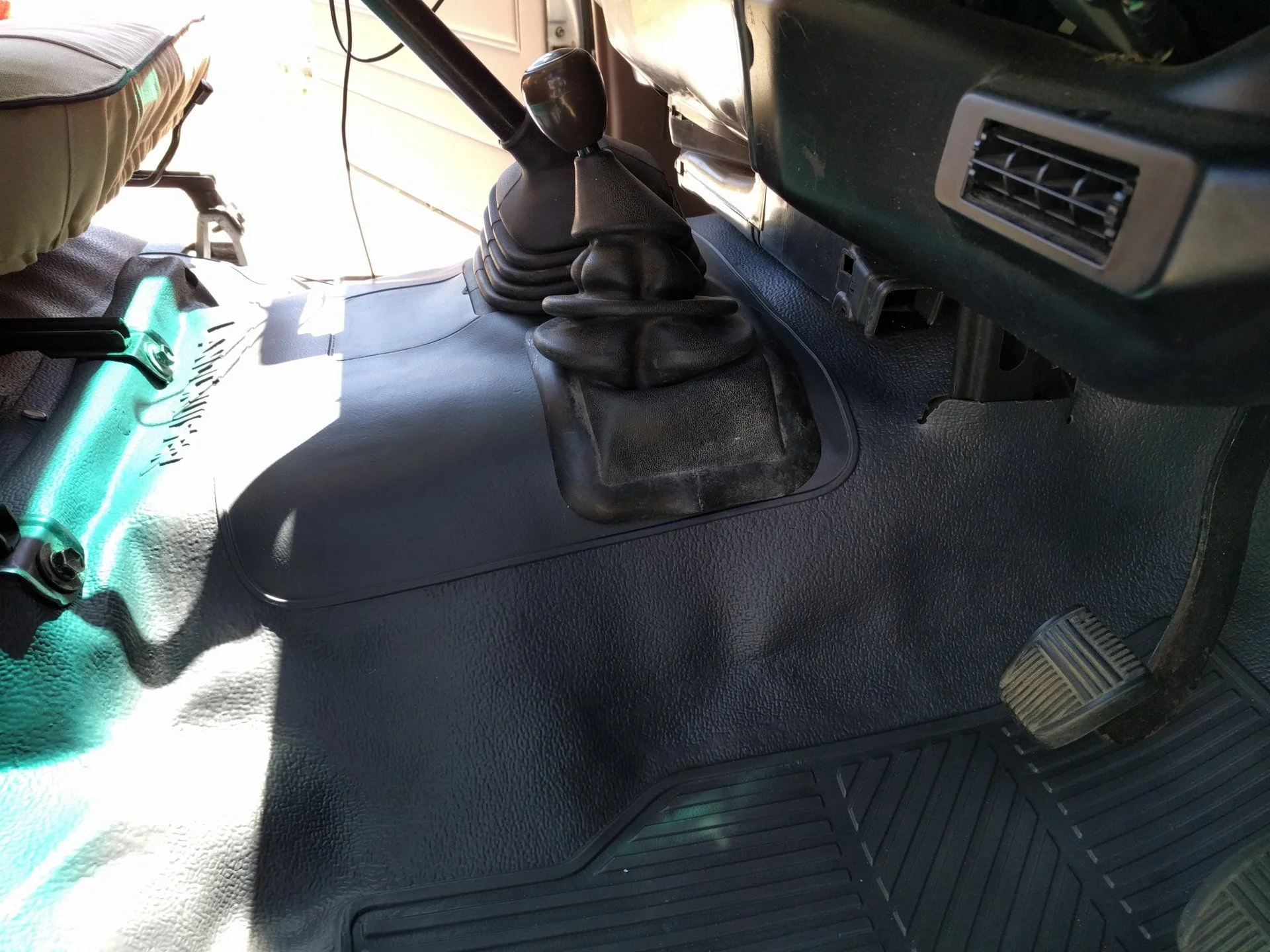

Siflersmom, this picture shows the forward front mat, and the shorter piece behind it, if that's of any use to you. Behind the shorter piece in my Troopie (a '92 non-RV model) is an after market, single-piece of rubber mat, about 1/2"-3/4" thick.
