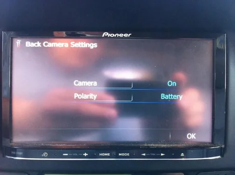

I'm am using an Aviv z2. So I tapped the acc pwr and grnd at the metra and it worked. I am obviously having a problem with with my 12v circuit. I will start a different thread for help with that matter.
Thank you all for your help it was much appreciated I hope to repay the help to you all
You said z2 before and i forgot. :o
Glad you got it... most folks forget to set the type of camera on the headunit.
