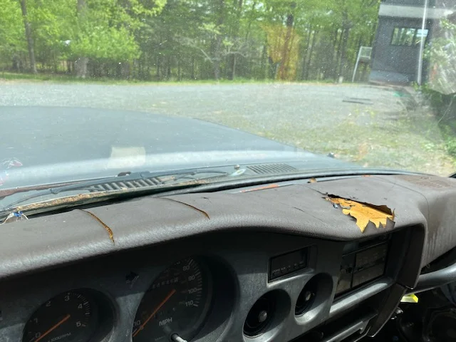

Needless to say, the truck was pretty nasty inside. We cleaned what seems like decades worth of crap out of it. Most interesting find was a 15 year old can of sardines...

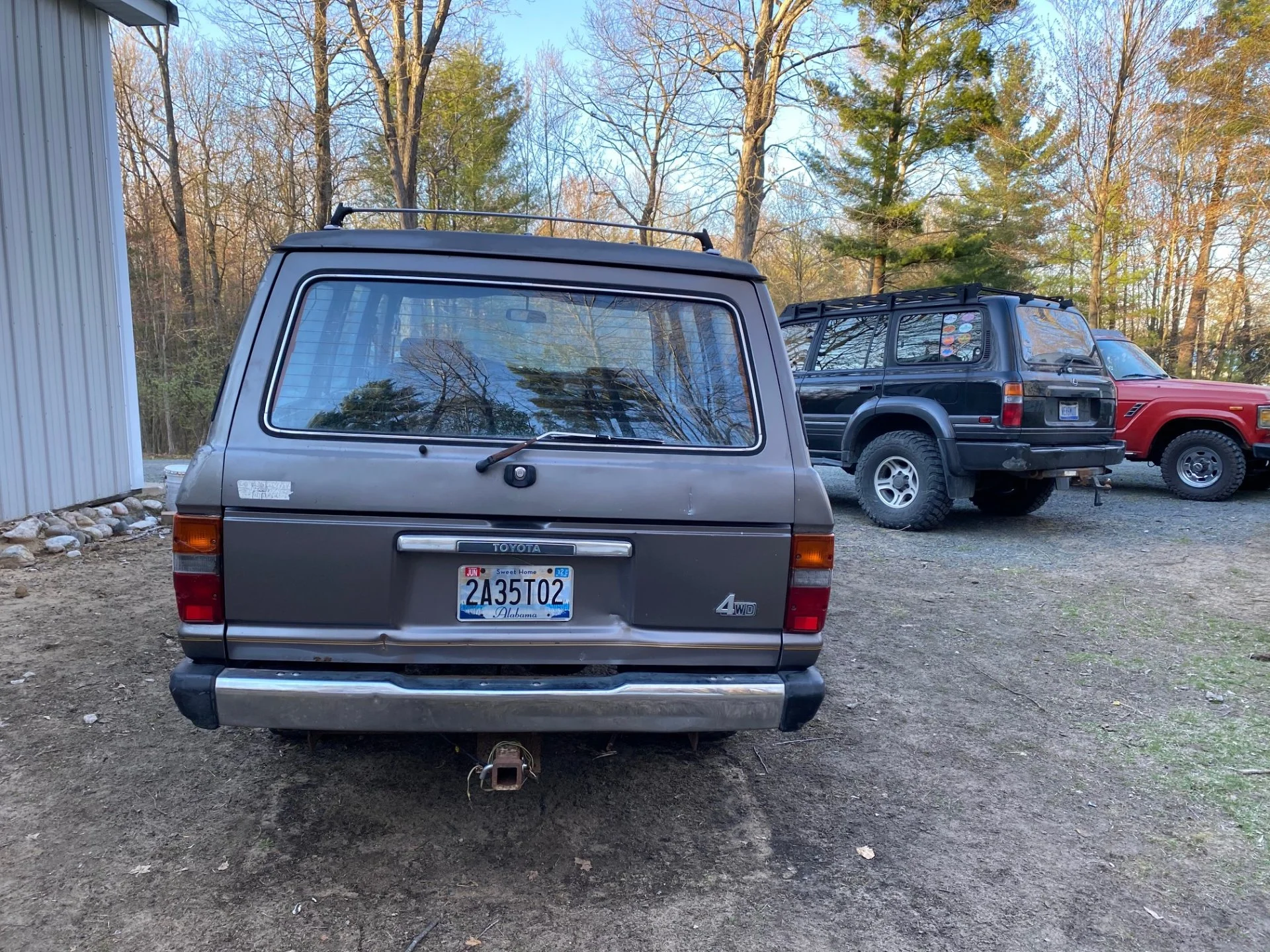

The body is in decent shape and the frame is solid. According to the plate, the last time it was registered was 2012 in Alabama.

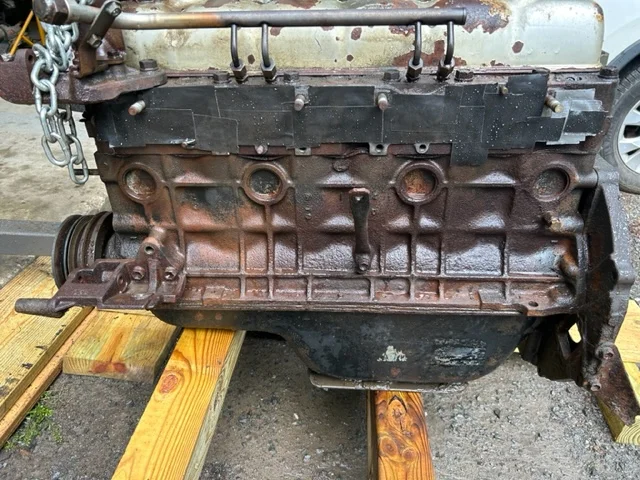

This summer I found a donor somewhat locally that was used to haul people around an off-road park. Body was shot, but it ran great with only 137k miles on it. It is not street legal, so I trailered it home.

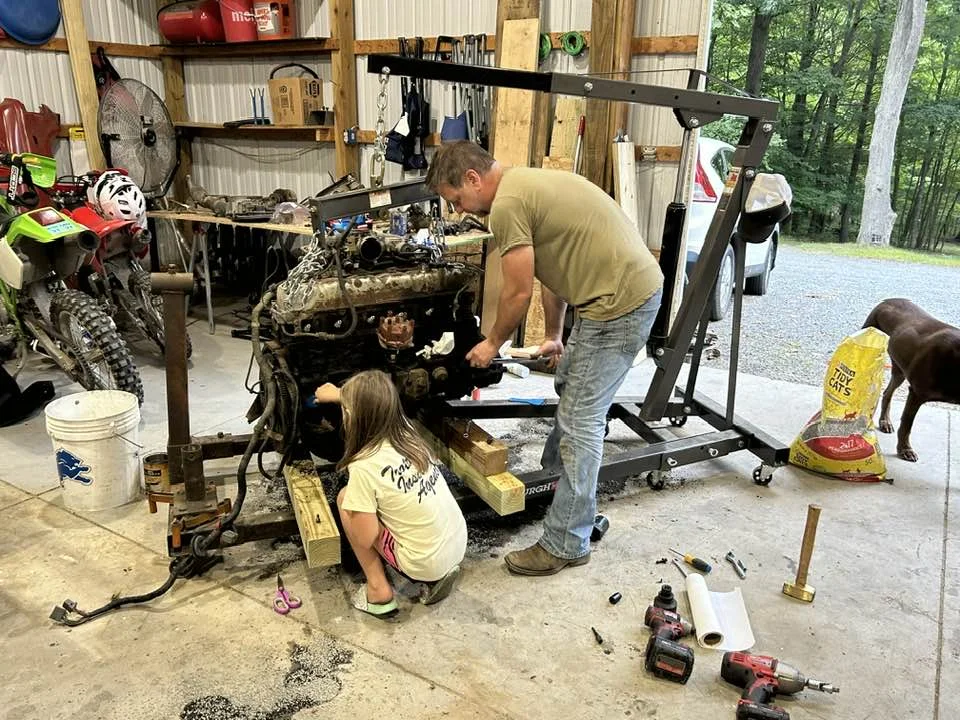

Plan is to pull the engine, refresh it with a bunch of new parts and stab it into "Stella"
This past week I was able to get the parts truck into the barn and pull the engine. That's always a treat., since I basically have zero idea what I'm doing. It usually entails much bourbon and many texts to cruiser people smarter than I.
Got the pressure washer out and removed as much mud and grease as I possibly could.
I spent much money on parts, thanks to George, CityRacer, and McGeorge Toyota....
Pretty sure every single gasket, seal, hose, and clamp that are available have been purchased, along with all the other standard fare.

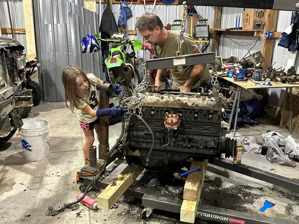

Once the engine was fairly cleaned up, I painted the block. It looks like crap, but better than it previously did. It's not going to be a show truck anyway.
Had some trouble getting the distributor out, but thanks to a quick search here, a block of wood and a hammer did the trick!

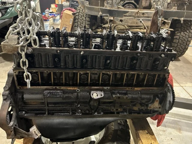

Removed the valve cover and it there was no sign of a gasket on there...not sure how that happens.
Removed the side cover and the gasket is no bueno. Hard as a rock. Started scraping it off the cover, and that was slow going. Will do a search for removing hardened cork gaskets.
I have a fully dressed 3FE I want gone if you need parts.

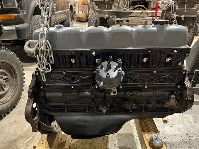

Finished painting the engine and got the distributor back in with new rotor and cap...hopfully it's correct. I took pictures with the cap off prior to removal and attempted to re-install the same. Painted the side cover and installed it with shiny new hardware, along with a new gasket. Next is to remove the oil pan, clean it up and install with new gasket. Once that is done, I'll start putting everything back on the engine.

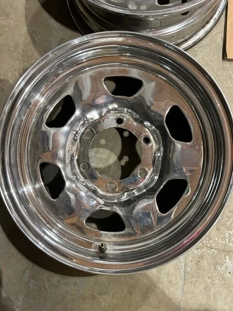

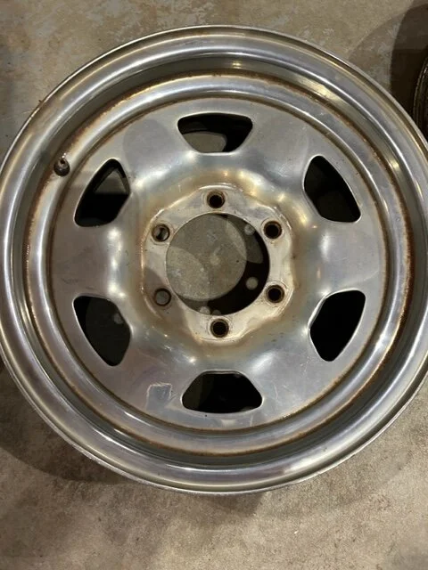

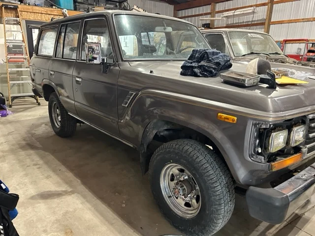

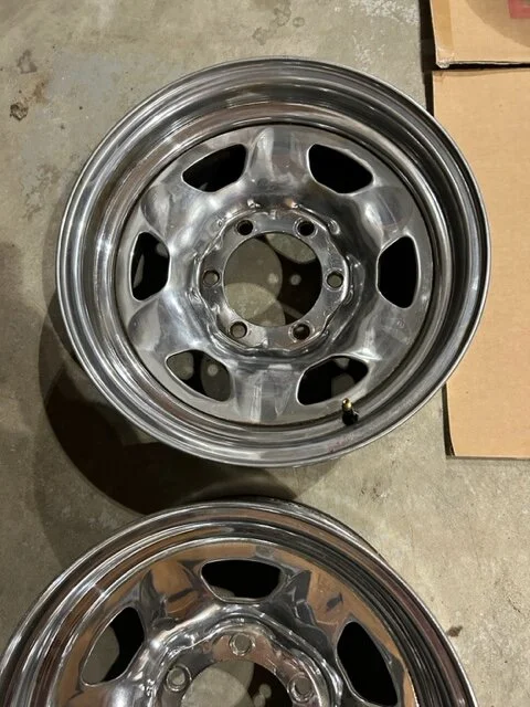

Finally got the truck in the barn with some good ole fashioned redneck work. Took a old set of stock wheels and cleaned them up a little bit.

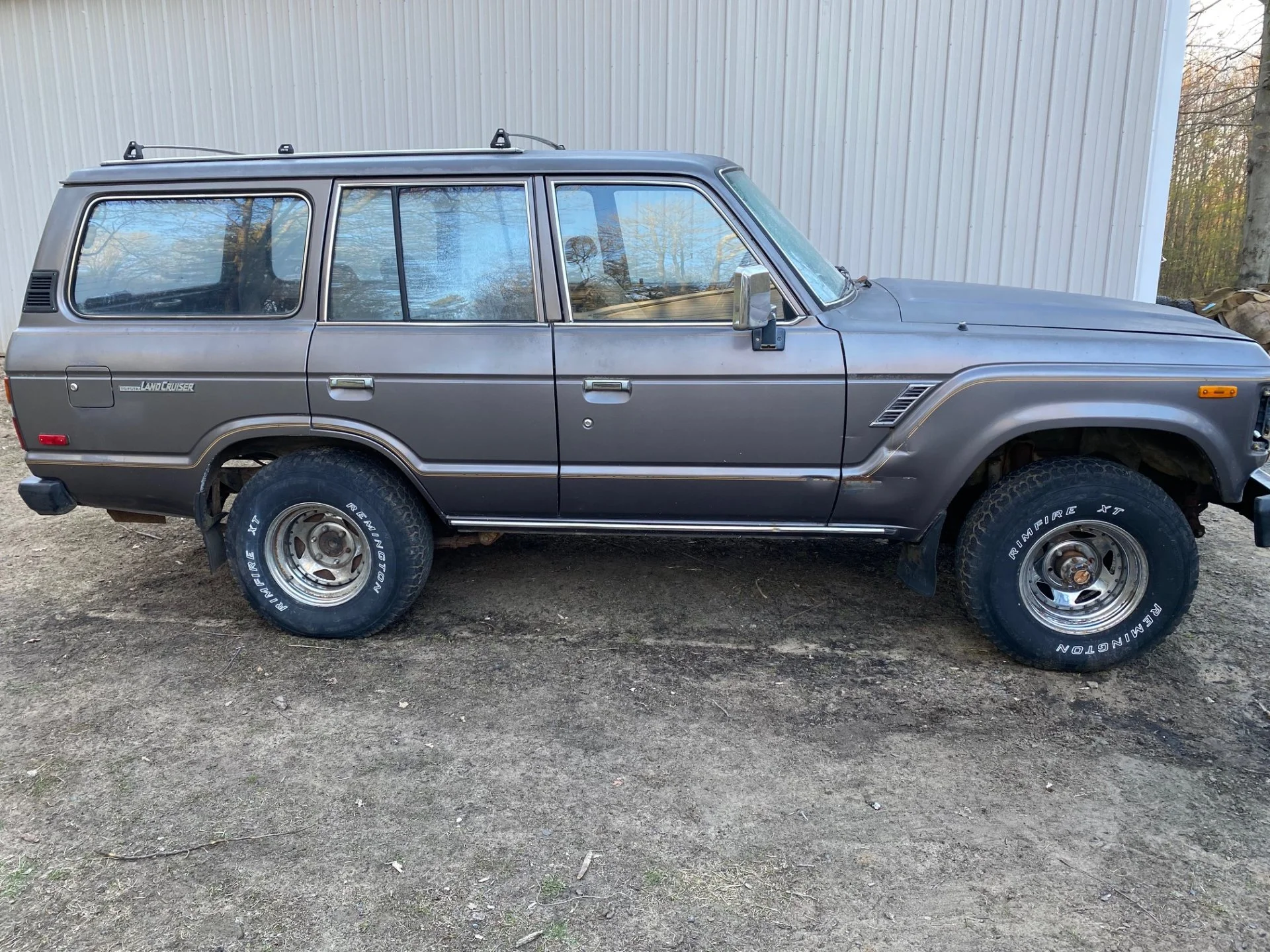

Purchased some new tires and had them installed. Went with some Falken AT Trail, which I had not seen before. Got them home and mounted on Stella.

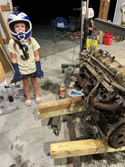

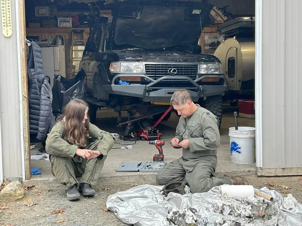

Whenever I am working on one of the trucks, my youngest wants to be there to help. She's usually out there trying to do anything I'll let her do. It tends to make tasks take twice as long, but it's worth it to me.
She's also a giant goofball, which I thoroughly enjoy.

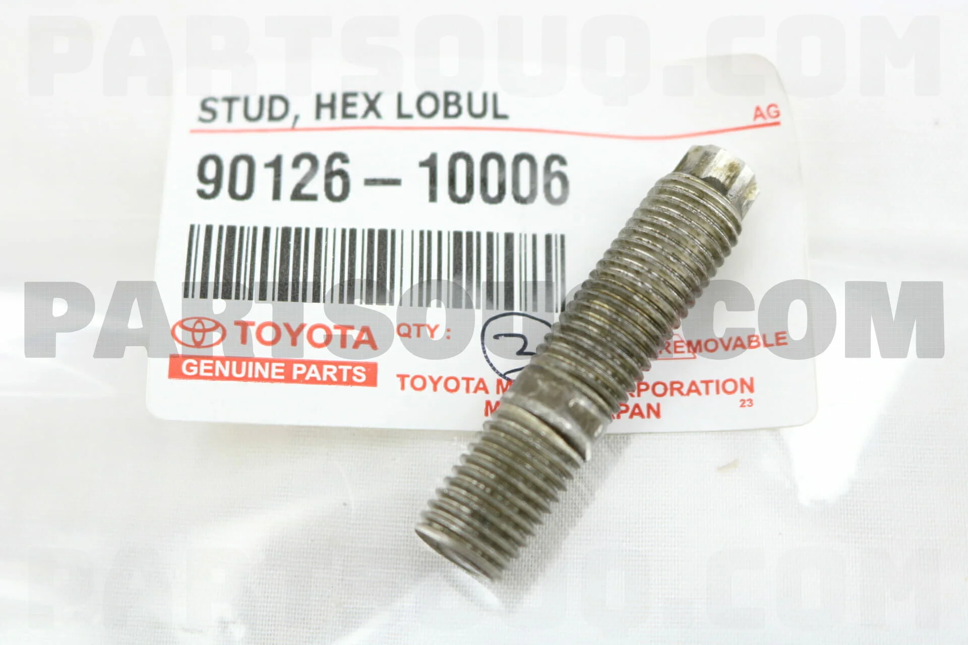

The bolts on the exhaust manifold studs are stripped. They've been soaking in pb blaster for over a week, and still no bueno. Also, the exhaust manifold heat shields were rusted, so will need those...and maybe the entire exhaust manifold if I can't get the nuts off (so to speak)
Unclear about which studs are stripped. If it's the studs for mounting the exhaust to the exhaust manifold and you are going to replace them use these from an 80 series. Hex end makes installation easy.
Yep, thanks! I plan on replacing them with these from the 80 series. Did the same on my wife's 62. The studs and nuts that are currently on the manifold have apparently not been off in 30 years. It's awesome :)

My 14 year old starts driver's training next month and she is inheriting the 80 series. She is super excited to work on the truck and learn. This summer she rebuilt the front axle, installed new PCV valve/grommet, new hoses, seat gears and an accelerator cable. She has been awesome. She does it all on her own, I just hang out and help if she has questions. My mother-in-law asked her what she wanted for Christmas, and my daughter told her she wanted truck parts.
