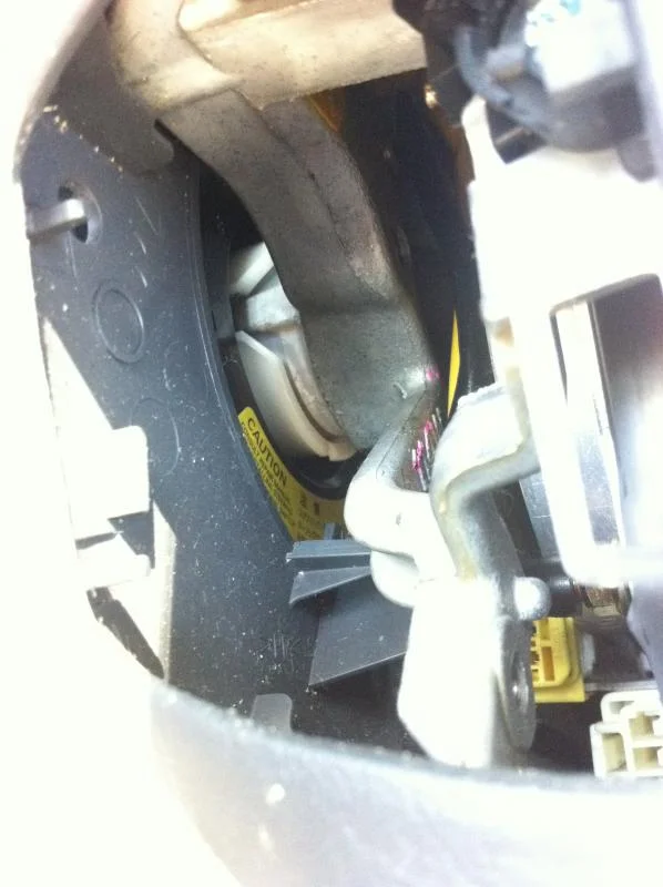

I listened very closely to the noise and it's location and determined it was behind the steering wheel. I removed the upper and lower cover of the column at the dash and listened more. It's coming from the clock spring area. That of course has been discussed, but it's not coming from the area behind those covers. It's coming from inside the wheel! Well the area covered behind the airbag.
Thankfully Toyota has access panels for steering wheel controls (Cruise on the right, blank on the left in my case) I opened both panels and gave a healthy squirt of HD silicone from each side - into the shaft and spring area. Problem Solved.
If it comes back... 2 minute fix. You're welcome.
Access Panel on Wheel
Inside the wheel from left side
