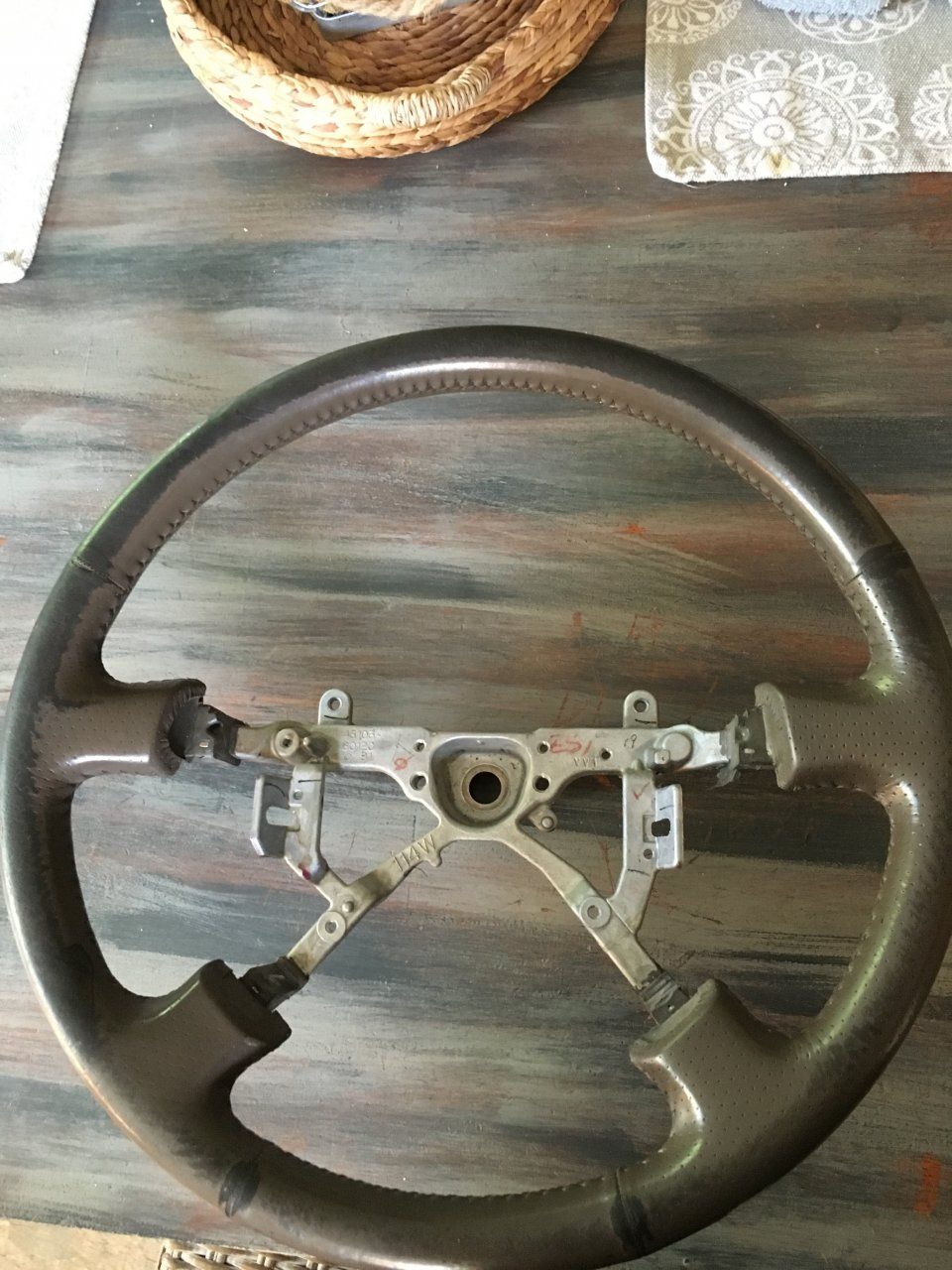

How it goes, I guess. What's a second hand wheel worth? Does the chain breaker want to sell me their ill-gotten wheel?
@clayinho might have an extra wheel. At least over a year ago they did. Not sure if there are differences between pre/post 03 wheel fitment though.
