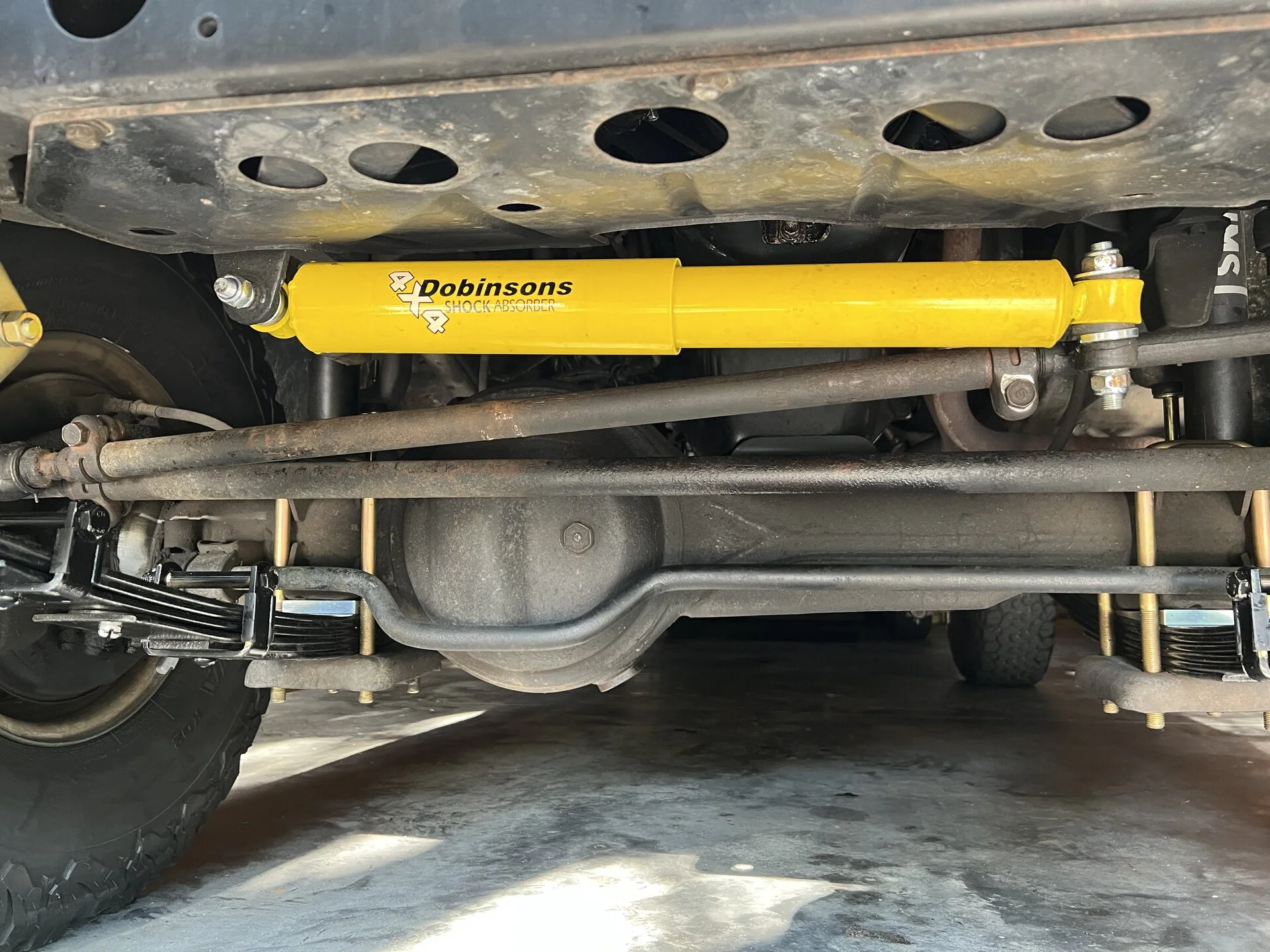

Here’s a pic for good measure, loosen the clamps and rotate the rod with tires straight - just did this a few weeks ago after installing my Dobinsons kit. My steering wheel was crooked to the right, it was trial and error figuring out which way to rotate the rod but overall was very easy.
Mine is also cocked to the right . Which way did you have to adjust the rod ?
Thanks guys . I will try this tomorrow. Mine is also cocked to the right . Which way did you have to adjust the rod ?
I honestly can’t remember, I had to turn both ways to fine tune - I think rotating the rod toward the front of the vehicle makes the wheel turn clockwise so you would want to rotate toward the rear of the vehicle. Sorry if that is backwards!
