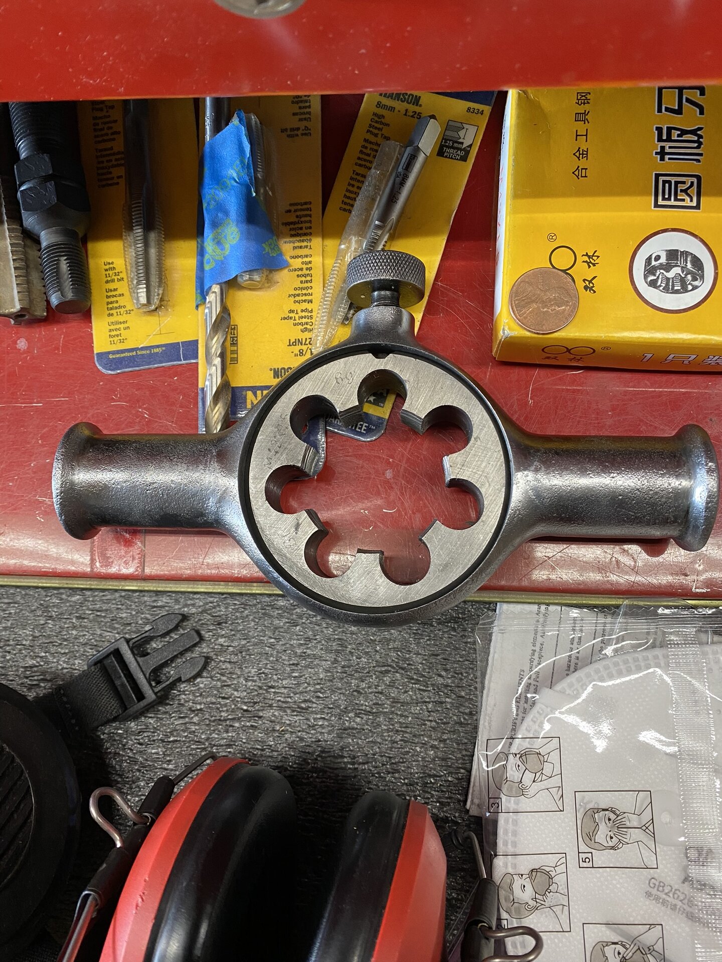

The ID of spindle make no difference. Provide no burrs protrude into center rubbing on axle. Which is not likely any burrs long enough to.
The threads are a different matter. You'll need to chase or file the threads. I once spent 5 hours filing spindle threads. No more!
Now I chase with a 42mm:

I'm picking up one of these rethreading files (will use the 1.5mm pitch side) to work on the outer thread damage on the spindle/knuckle, plus a triangle file.
