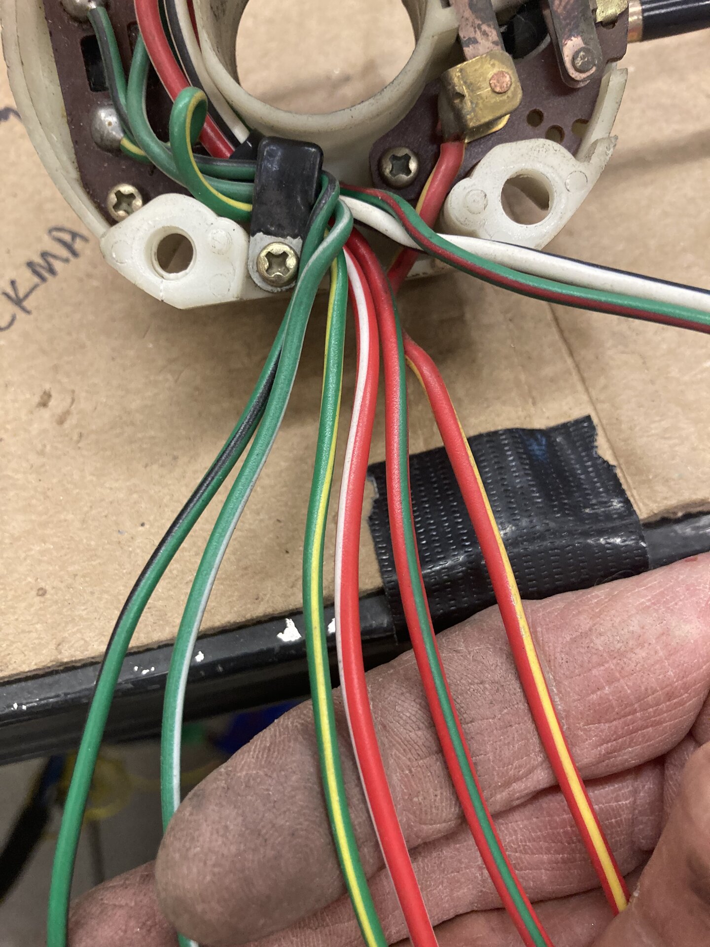

Can anyone ID these wires from the turn switch of a 78’ fj40 for me. I’m doing a new chassis harness from American autowire. I have searched a ton and still not great. success. Thanks.
Look in the factory service manual. The electrical diagrams have the wire colors and routes.
There is a link for the FSMs in my signature.
Thanks guys. I have reviewed those. Still confusing regarding which Toyota wire from the steering column correlates with the GM plug. I was able to get the rear turn signals to function properly but stuck there. Getting close and was wondering if someone had done this and could save me some time. Body off resto mod are super time consuming and getting close to being done.
Thanks again
Turn signals, hazards and brakes functioning. Just need to figure out dimmer on the column. I have dimmer switch that is functioning from the new wiring harness from American Autowire but I want to run the original!
