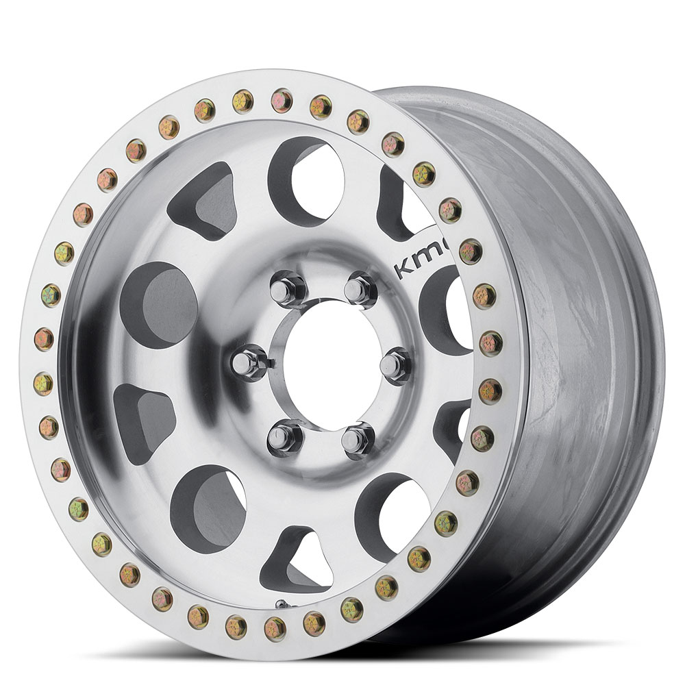

These will be mounted on 17" KMC XD222 Enduro Beadlock Wheels:
With Cooper and KMC both on board, our sponsorship for KOH 2019 is officially full. We'll have more to show on the tires and wheels, and from our other sponsors over the coming months.
