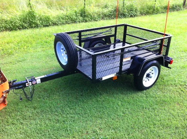

I live in rural setting and go town to fill 6-8 fuel cans (plastic) with gasoline and diesel about every two weeks. I simply use a small trailer to haul it all in. I recognize not everyone has a place to keep a trailer and lifestyles are different but you should NEVER have fuel inside your vehicle. Do whatever you need to do....to correct that if by ('strapped in the back')... means you have it inside.

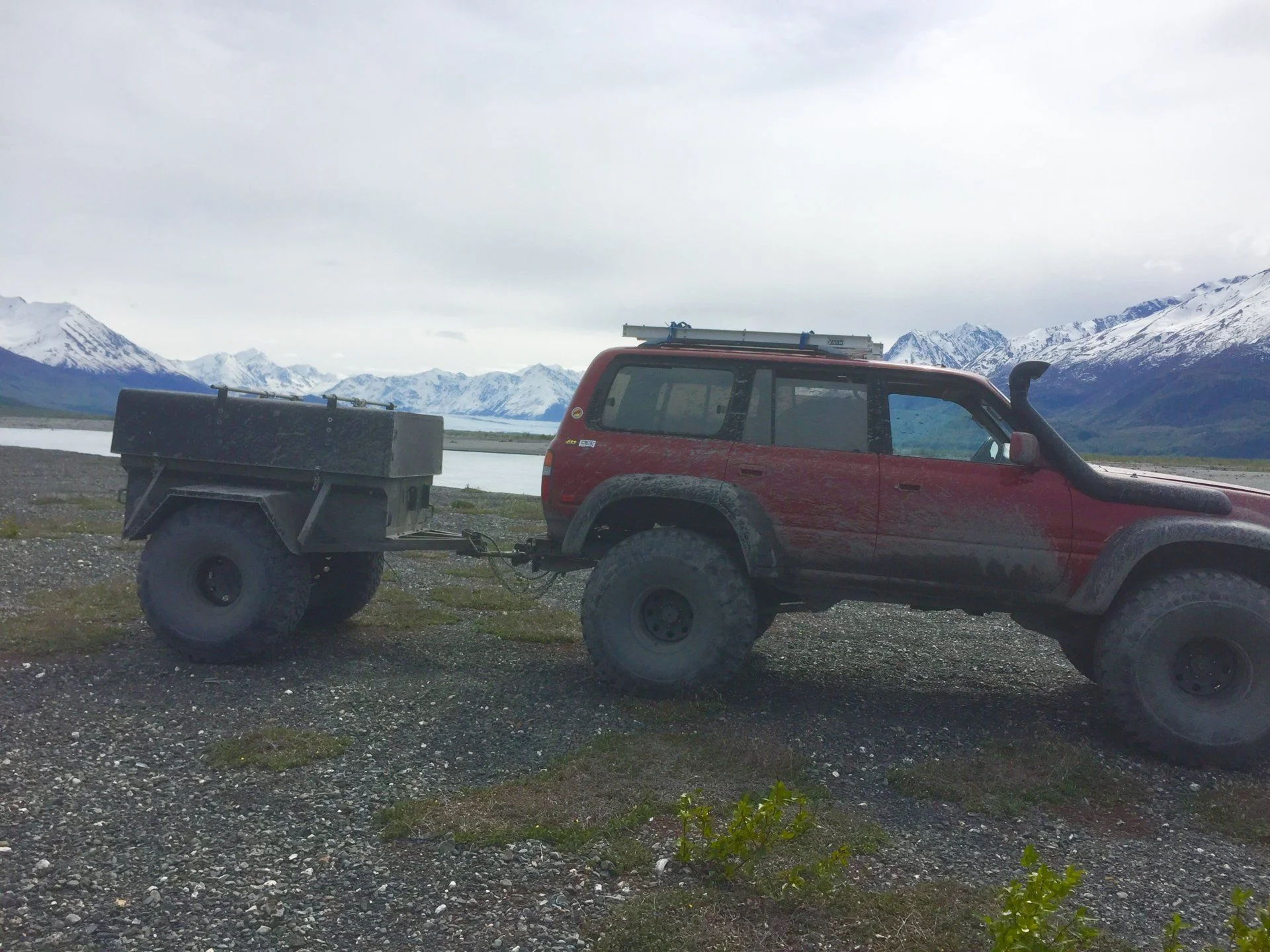

I’ve built a trailer, but she’s not ready for this trip. That’ll be the long term solution for some of the crap I currently strap down inside.
