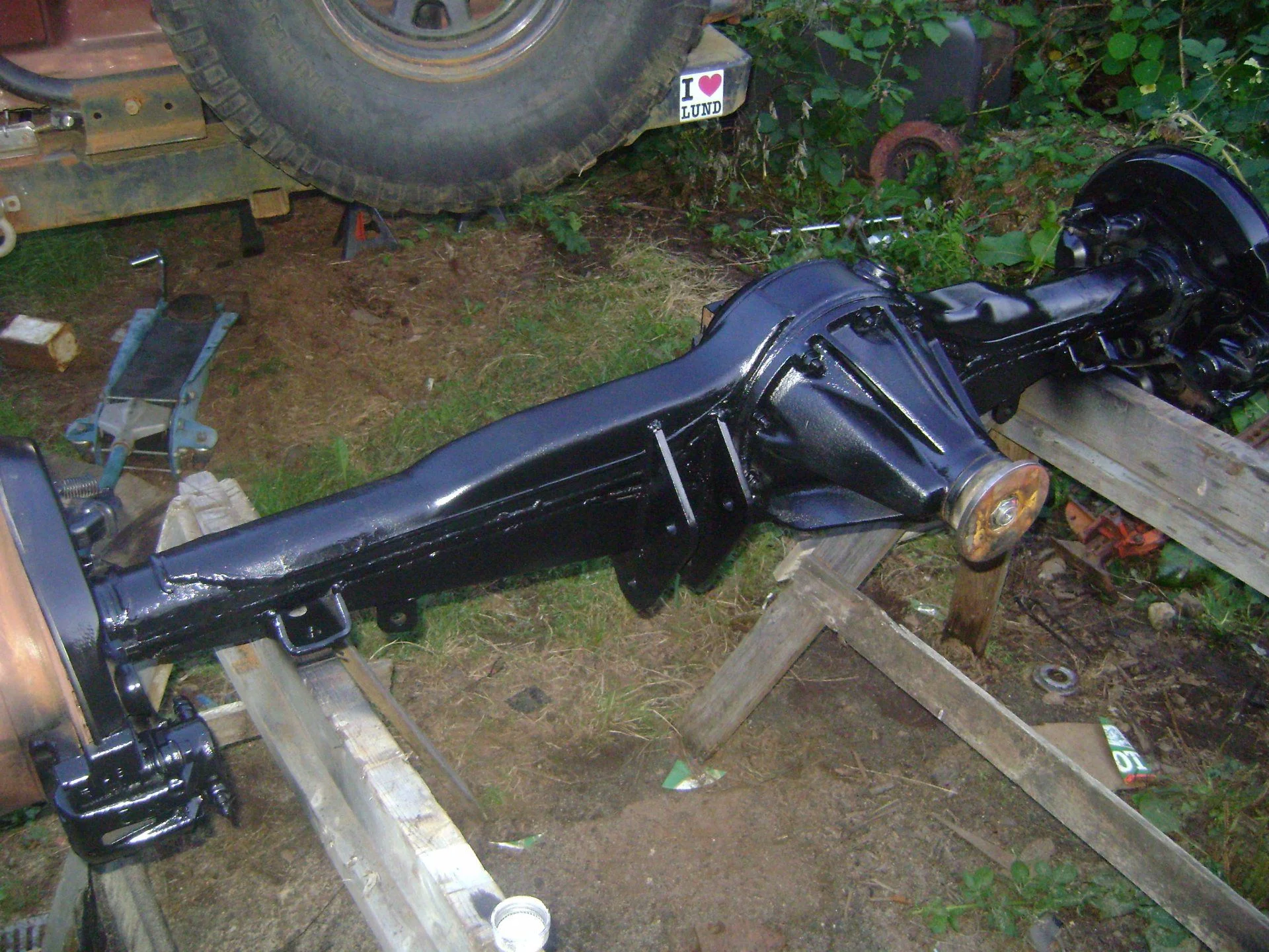

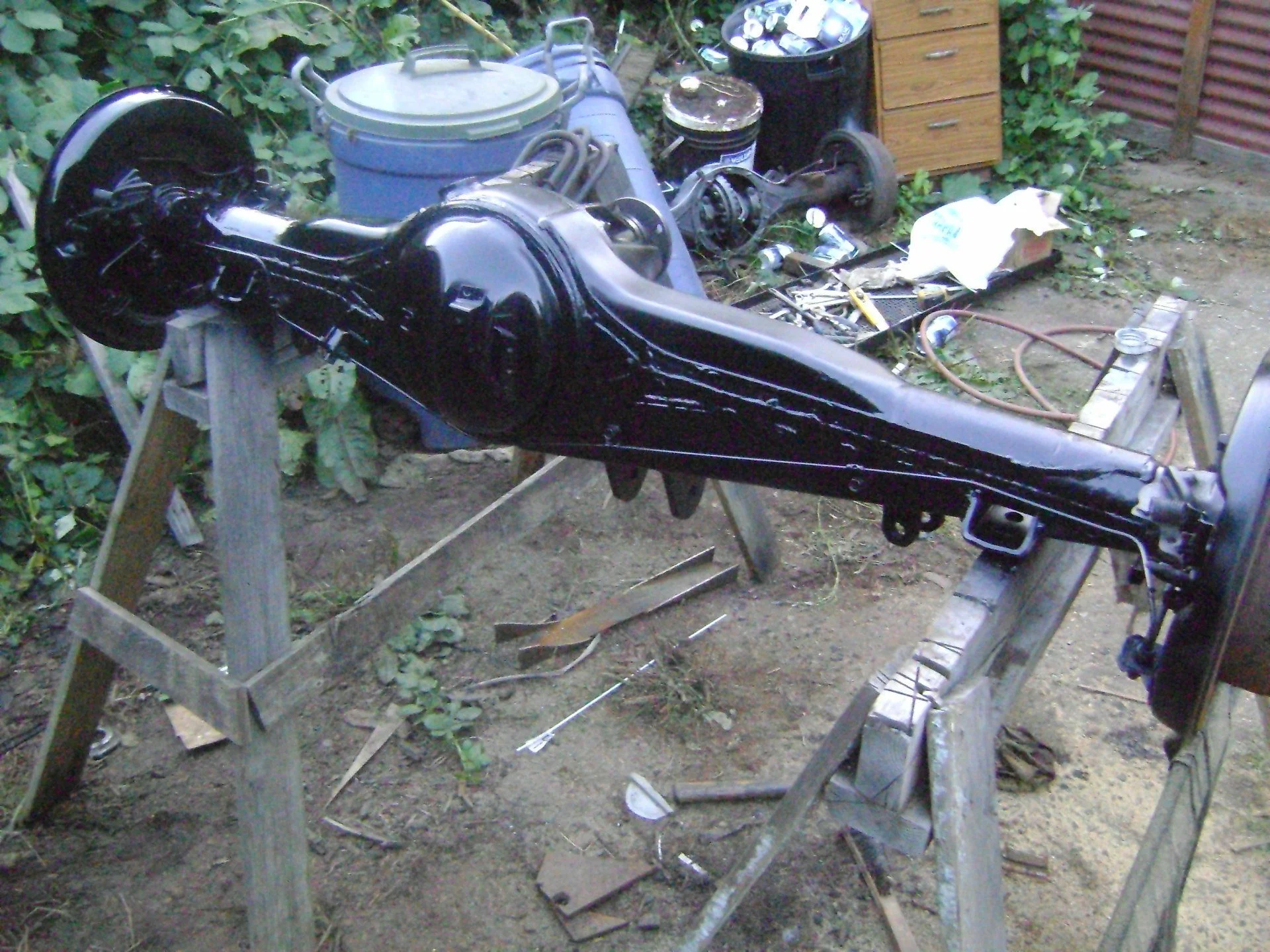

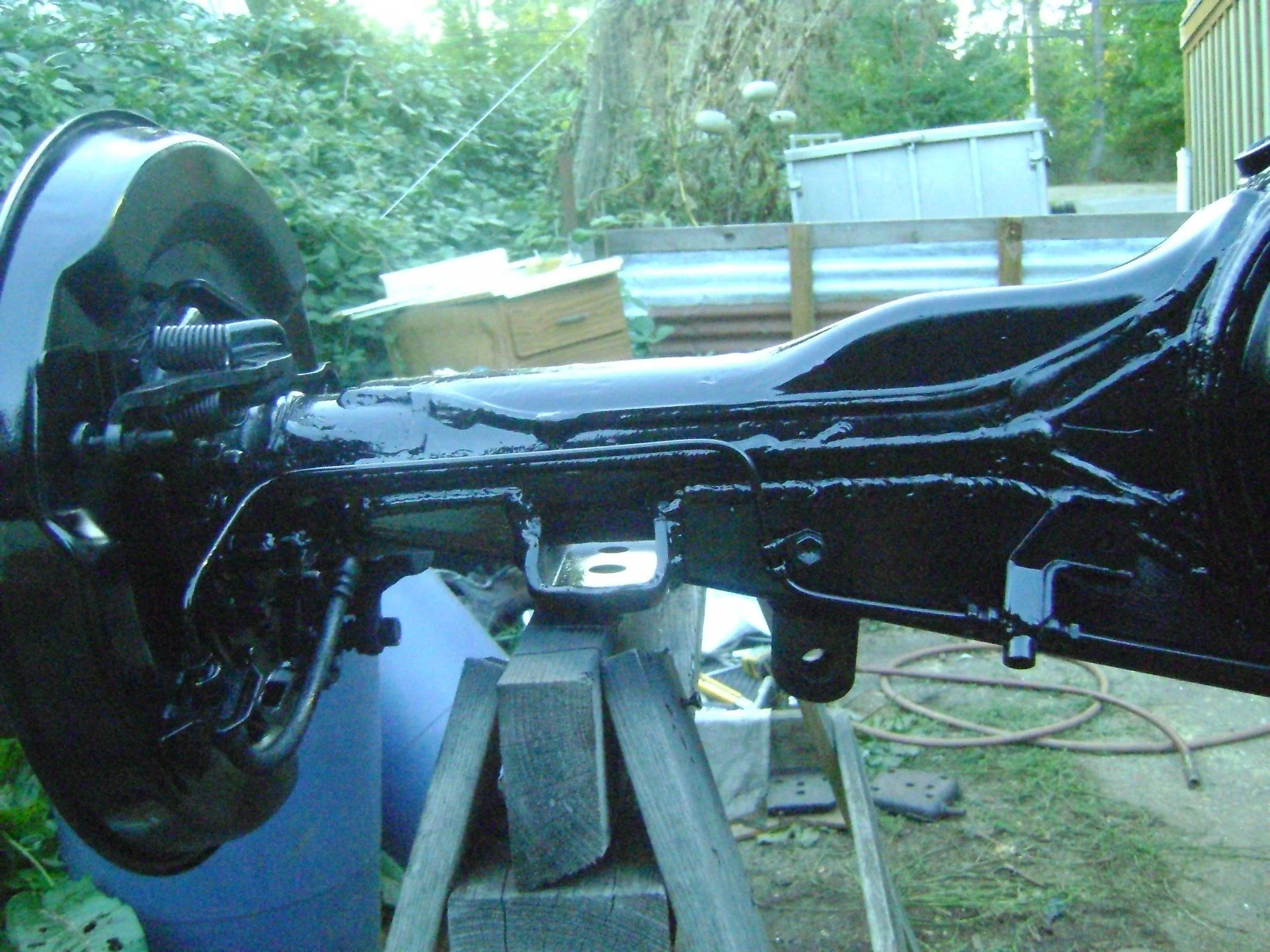

So I bought a double flaring tool and put it to use right away. I Slapped some tremclad on there and called it a day. I just reduce tremclad with 10% paint thinner. Its cheap and effective. Now I have to drill out the pinion flange to mate to my drive shaft and drill out a new breather.
Well looks like the camara flash caught my s***ty paint job. I was getting dark and I ran out of paint. second coat tomorrow.

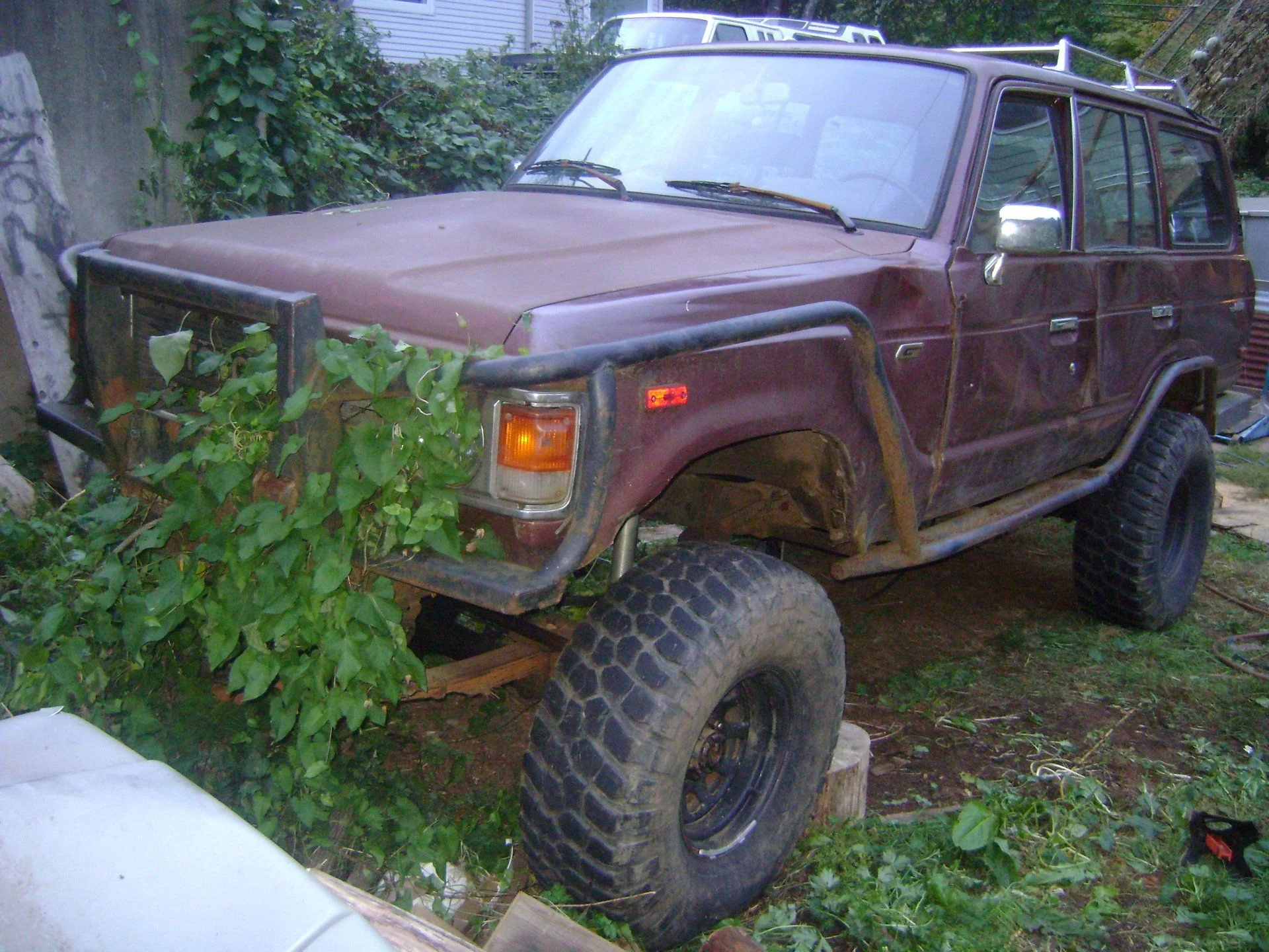

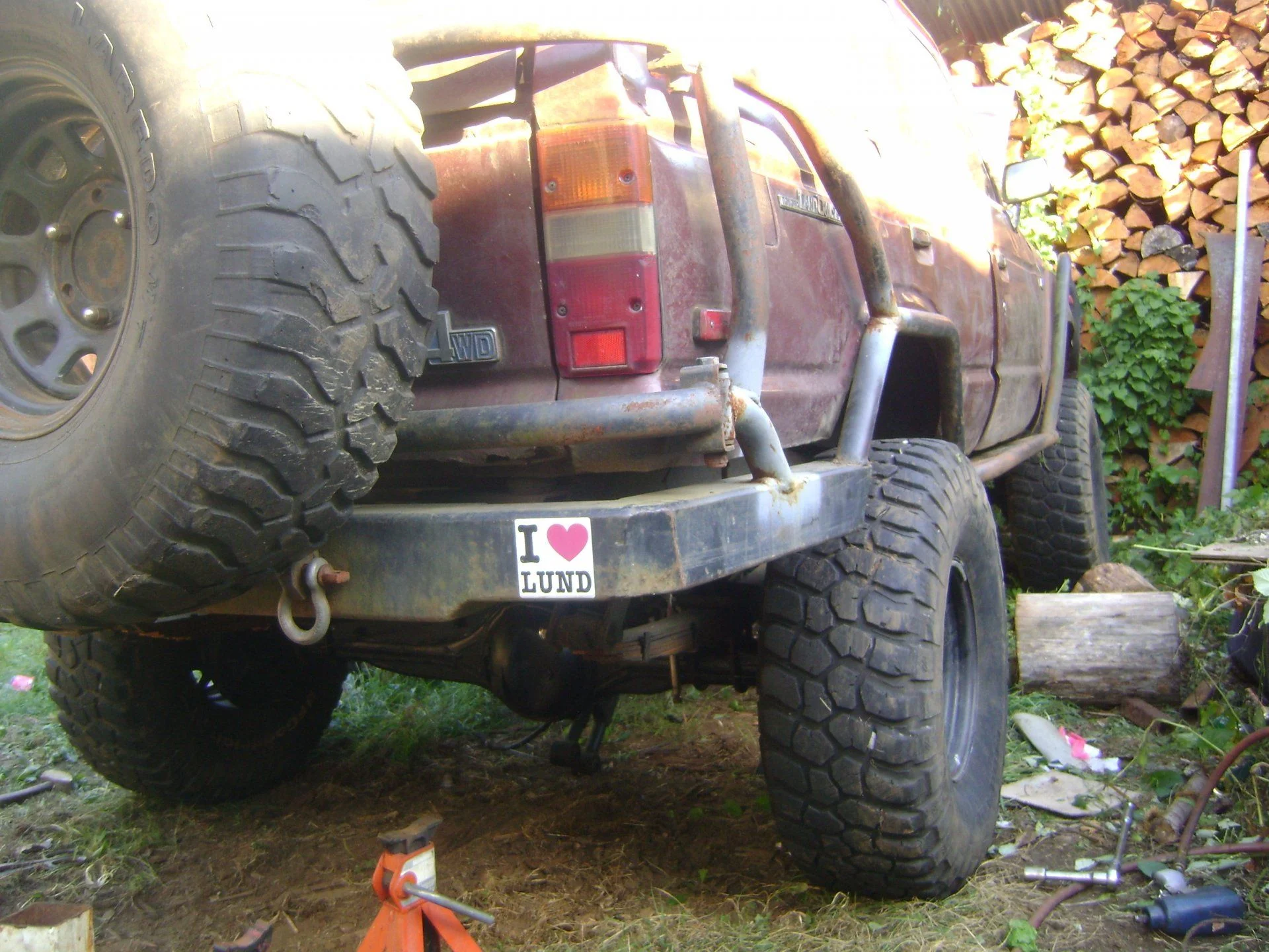

This thing you call a landcruiser has been sitting here for way too long. Zombie weeds are taking over my truck. This ol biatch needs a good ol s***t kicking. Hope I bring my camara.

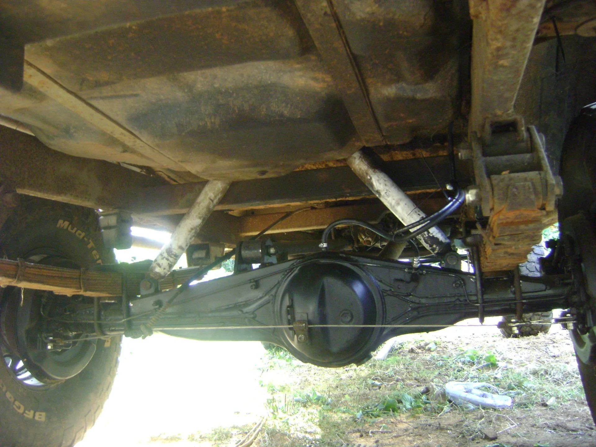

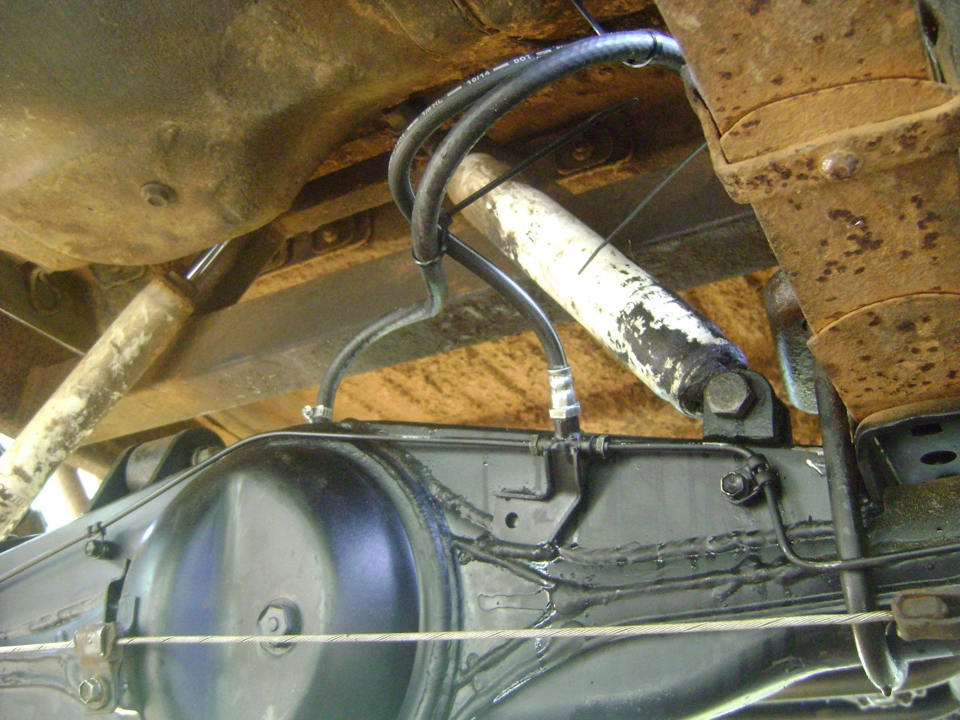

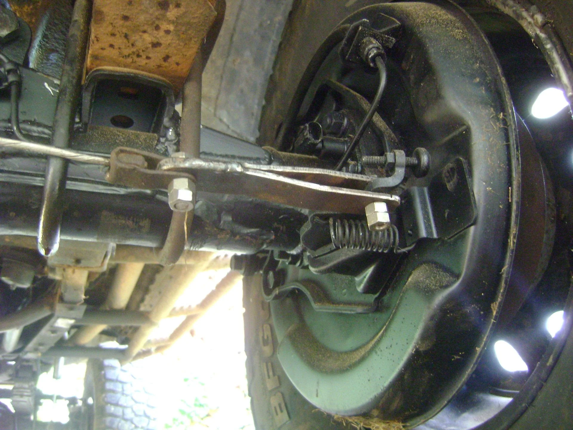

Installed the parking break with an uber awesome extended adapter. Save myself a few bucks. Installed new oem flexible break hose and axle vent, which I routed up to inside the rear quarter panel. I don't like the stainless flexible break hoses. I have seen to many fail. I bled the brakes by myself which isn't exactly the right way to do things. But I have a friend coming over later today that will help me bleed them again.

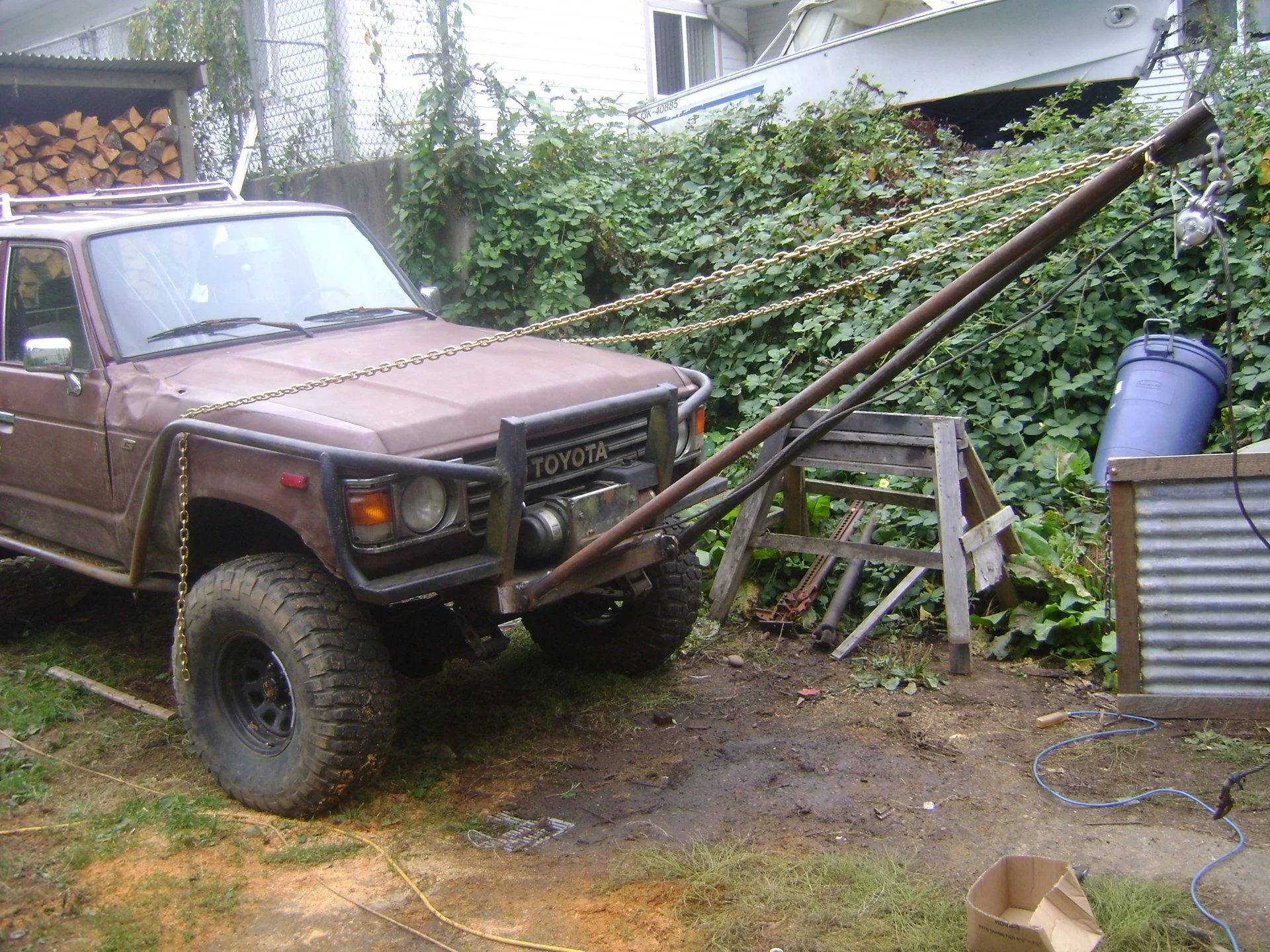

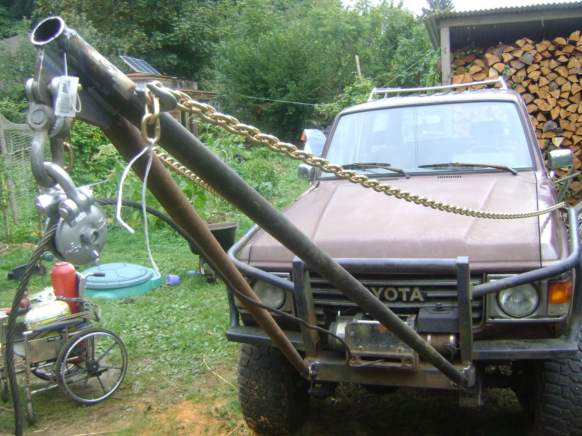

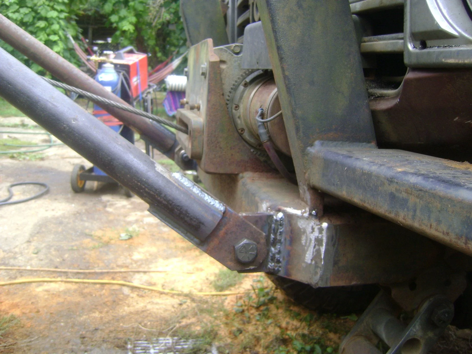

Hows this for a super sketchy crane of DEATH? LOL I am heading over to the mainland to pick up a sawmill. Figured this would make the job easier. Just under $200 for all the hardware. I am sure it can pick up at least 1000+ pounds.
