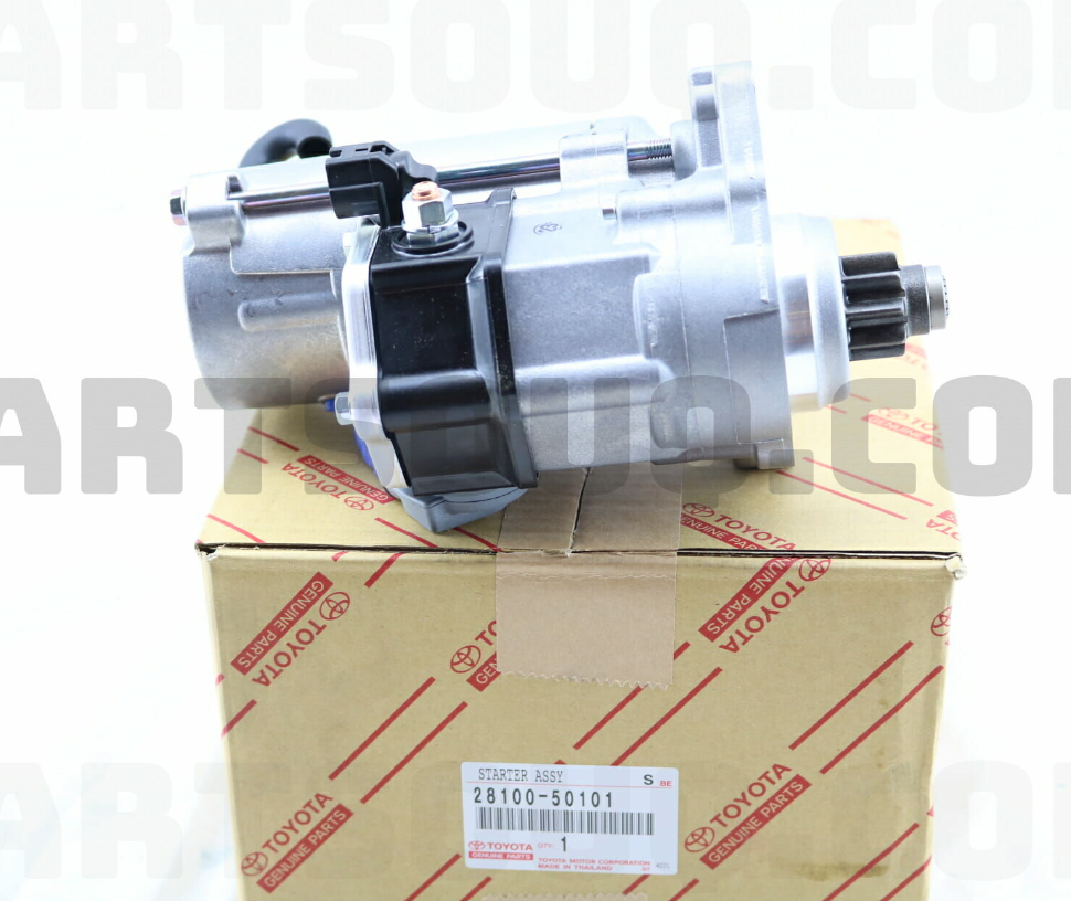

You can indeed get brand new 100% genuine Toyota starters. Your local dealer will not carry it, and may not even have access to order it. Thanks to global supply chain and e-commerce though, you can buy one!
When you're looking at part numbers the "-84" suffix signifies reman. If you find the Toyota part number with no "-84" and it's priced around $500-1000 through a reputable source, it should be genuine new OEM. Nearly $600 for an 06 via Partsouq as of today. Well worth picking one up, IMO.
Seems like a hard sell when both are legit Denso starters, but the new one is 6X as much as a reman and requires shipping from overseas (the Denso remans are USA-remanufactured). My OEM starter only made it to 136k and 13 years before the solenoid started clicking.

I was on team "just buy a Denso" up until about 2012-2015 when I had multiple Denso reman parts (one a starter) fail straight out of the box. In my experience, Denso reman in Mexico is not the same "Denso" made in Japan (often within a Toyota campus).
The genuine part is definitely $$$$, but the entire Toyota/Lexus market is built upon the idea that the "best" parts are worth substantially more than the "good enough" hardware. 🤷
My Denso was purchased in 2020 and was USA-remanufactured.
I just got a peek at my starter. Remanufactured "for Toyota" with -84 designation on part number. Denso name is there faintly but it is hard to see.
Unfortunately I don't know when the previous owner had it replaced but it looks like it has been there for at least a little while. FWIW
