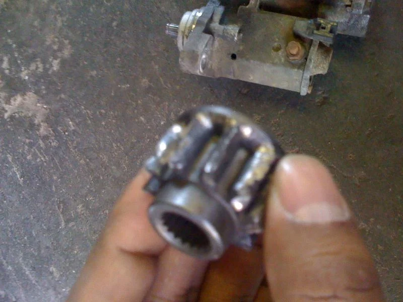

Change that starter ASAP mate! You might soon find your self stranded like me :). Here are some pix how the teeth looks like when they are done. It's crappy pix but that shaft on the starter that had worn out on me over time. I used to hear that noise often during startup until it gave up on me. My guess is when it goes, your engine won't crank or you will hear a high pitch (sort of) noise when you crank the key.

Wow man.. That's toast!
Did you find any damage to the flywheel it attched to at all?
I will centrainly get around to it soon after seeing these pics.

No damage on flywheel. For me it spun couple times as I tried to crank or turned the key and then the starter basically locked up. As the teeth portion dislodged itself from the shaft stuck itself sort of diagonally between the teeth of the fly wheel and itself (inside). Right after that called the tow truck. Then when the mechanic dude unbolted the starter, that teeth ring looking thing fell to the bottom. I got an after market starter, didn't have much choice, brand name "World Wide". Never heard of it but so far it is doing well. One of these days I'm going to get the real thing from Dan.
As far as I know our fly wheels are pretty beefy compare to that starter teeth ring. However, if that teeth ring some how spins out of the shaft when the fly wheel is in a reasonably fast motion, things could go wrong :eek:. It seems like there is enough space in there so even if that thing comes off, the fly wheel will probably kick it to the bottom but not sure.
