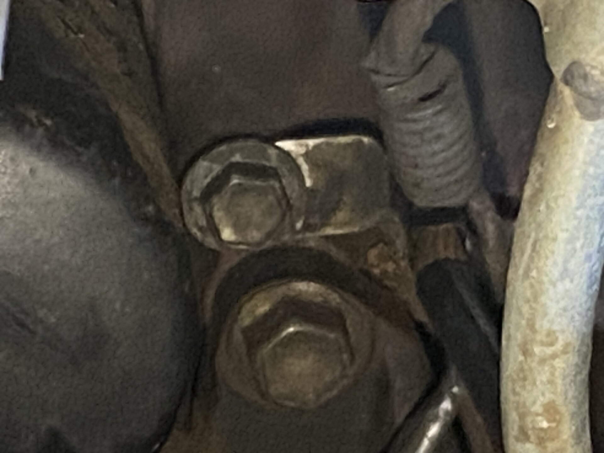

On a '96 1fz, there's a ground wire in the harness close to the starter power wire. Where does that ground attach? Frame? Starter bolt?
I'm swapping an engine from a wreck and failed to document where I detached that one.

There is a ground wire in the harness in the same branch as the starter power wire. I assumed it's associated with the starter. Don't know where to connect it.
Probably the one that goes on the back of the intake manifold.
Thanks.
There's a heavy ground wire that bolts to the block beside the engine mount.
There's two smaller ground wires that bolt to the intake manifolds.
