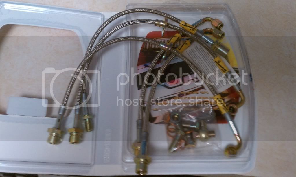

Here is rear caliper line routing. Because of Goodridge's banjo adapter line does not fit in slot to keep it from turning. The Stoptech lines do fit in slot.
Those are the 21126, stock length for non VSC (has 5 lines), mine are the 2-21127, 2" longer and for VSC (has 6 lines). The front banjos on the 21126 would work without mod for mine, not sure why they have the other in 21127 kit. Got mine a little over a year ago.
So we now know 21126 bolts in and the 21127 needs front lines same as 21126 kit.

Steve, you need Goodrigde part number 21127. But take look at how fitting attaches to front caliper. And refer to my previous post with a number of photos,
https://forum.ih8mud.com/100-series-cruisers/175109-stainless-brake-hoses-2.html#post5658410
if your line looks like the stock Goodridge line you are good. If it leaves caliper the way my modified line does, the 21127 may need to have fitting replaced on front lines. Hoser may be making progress with Goodridge on lines might wait to hear back from him.
