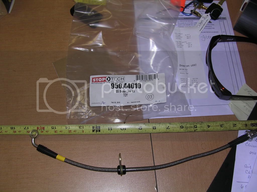

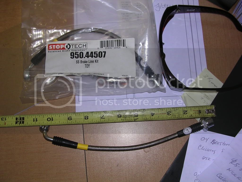

I just got a set through our stoptech supplier a few months back...I would call them and find out for sure, I would bet they have some sitting on a shelf somewhere
I found the Stoptechs in their catalog and a online retailer. They are approx $90 front/rear.
Where they the same length or longer than stock?
Im not sure...they are still sitting in the rear cargo compartment of the lc...waiting for when i have to do pads/rotors in about 5 months.
I will pull them out and see if can measure them tomorrow..I have to leave soon to go set up our booth here.. http://www.audiexpo.com/
From RedEuro's pics, Stoptech still does not have the line(s) from chassis to rear diff (VSC = 2 lines, non-VSC = 1 line). It is chassis to rear diff line(s) and fronts that should be longer for lifted rigs.
