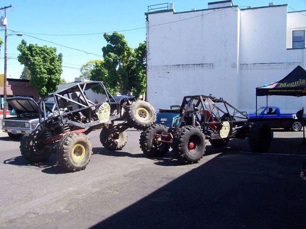

I wheel with a guy local who's run a couple different square tube buggy/things, and witnessed him rolling one of them. Other than some scuffs in the paint, the rig was fine (it was a pretty hard and fast roll). I don't think he's on here, but if you search W Harold, you may find some pics of his rig.
Here's a pic.
Do you recall specifics on what tube dimensions and wall thickness he used mostly? I'm thinking that 1/8" wall 2X2 with plenty of gusseting and triangulation would be sufficient since 1.75"X.120 wall round tube is the norm.

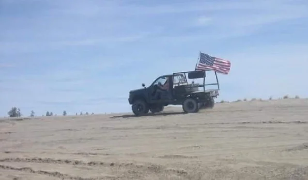

I'm no expert but I am building a interior/exo hybrid right now on my FJ62. I started welding 12 years ago and was lucky to have an experienced teacher who helped me buils a flatbed/bedcage out of... wait for it... square tube! The guy I sold it to flipped it 3 times with three passengers in the cab and had zero deformation. That said, exception does not prove a rule and there are a ton cheap bender options out there like the JD2 and my personal favorite Affordable Tube Benders, tube notchers, metal fabrication welding of which I've owned both. I use the Affordable bender now, it stores easy and works great. Just doesn't bend over 90 and is 7" radius.
