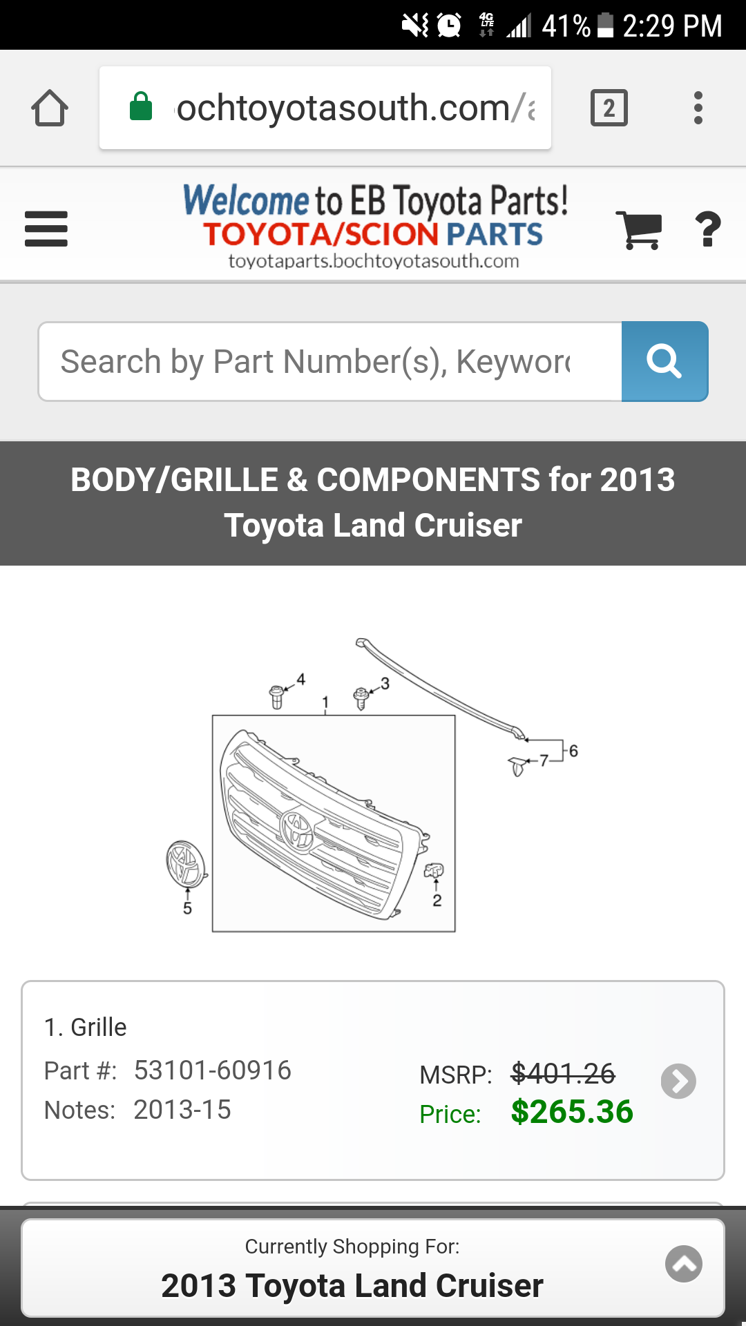

90159-50388
90467-13075
53117-60060
That's everything that holds the grill on for a 2013: 2,3,4

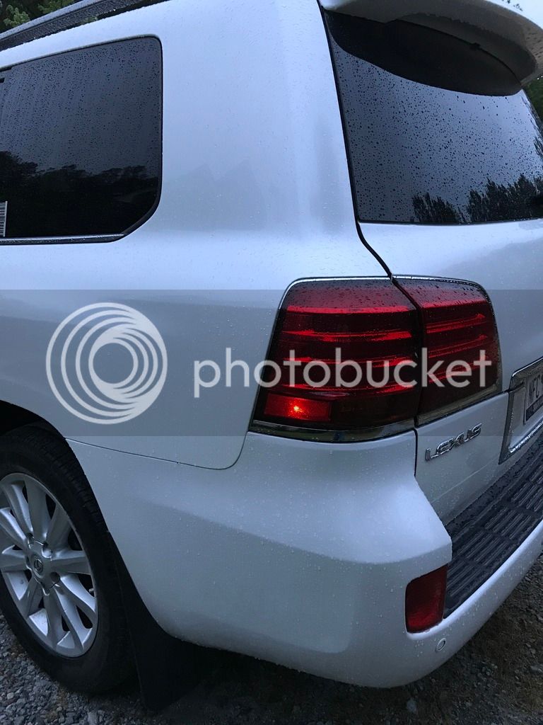

I'm completely stumped. Even my Google-Fu has failed me. I don't believe the truck has been doing this until yesterday but now I cannot get these tiny corner lights at the rear to go off! I checked all doors and rear hatch to make sure they are seated good. The interior dome lights are off also indicating that the vehicle also thinks all doors are closed good. Tried the headlight switch in the "ON" and "OFF" position also. Tried locking manually and then with keyless fob; all to no avail. They go off when the doors close but when the interior lights auto dim to off these little guys on each rear corner kick on and stay on.

Wild guess, but could it be related to proximity of your key fob? Does this happen when your fob is <<insert minimum distance here>> far enough away? E.g. park it down the block from your home, lock it, walk back to house and hang up you key fob, walk back to your LX and see if the lights are still lit?
Good thought. Just took the remote and buried it in a store room at my office and tried the lock button with no response so I think it is out of range. Little lights are still on.
have never noticed those lights coming on before on either of our LX's. you did some electrical work on it maybe something got shorted or crossed?
Definitely potential for that to have happened. I have finally picked up that it appears they are acting completely inversely to the interior dome lights. When the dome lights go off these 2 little guys come on. I've been changing the overheads to LED's also and perhaps it could be related to that?
ETA: It's pouring right now so can't do much more troubleshooting until it lets up. I'll tinker with bulbs in the overhead lights and also check the back driver's side access panel where the USB socket and CTEK display were installed. That's about the closest thing to those lights that have seen any work.
I didn't even realize that those lights were there... Now, I "need" to go look at mine...:rolleyes:
Was just heading to lunch and checked on that light. On mine its just a marker light that comes on with the other markers/headlights and shuts off when the lights turn off. It does not come on like the interior and puddle lights do when you approach the car. If you have had a ton of rain you may also be getting water ingress somewhere that may be shorting something out. If its had a replacement windshield I would check carpets under the a pillars closely to make sure water is not getting into fuse box or relays. Was a common issue on 100s.
Yeah the addition of rain definitely worried me that it could be an ingress issue there. One thing I have done in the rain is figure out that if I approach it the 2 rear marker lights go off and the interior/exterior courtesy lights come on. When I retreat, those go off and these come on. So it sounds like these may be wired into the wrong circuit or were hooked back into something errantly when we were dealing with wires in the rear. It's too consistent to be a moisture thing. They behave consistent. Just consistently backwards/wrong! :hillbilly:
