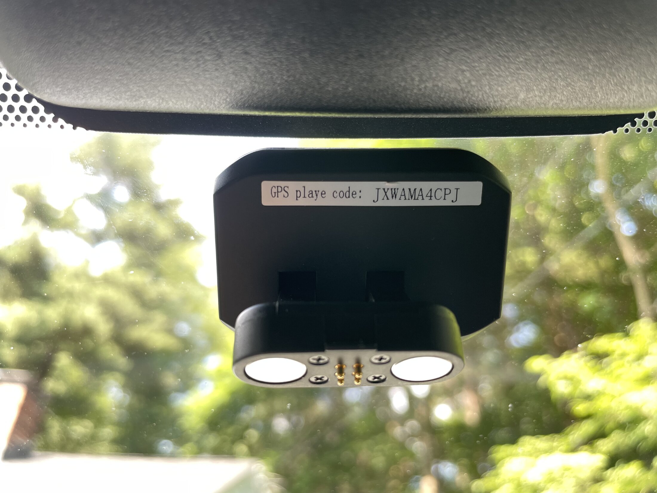

GPSPlayer comes back as a dash cam company, I’d guess likely aftermarket. Not sure anything oem is coming with a homemade label maker network ID.
