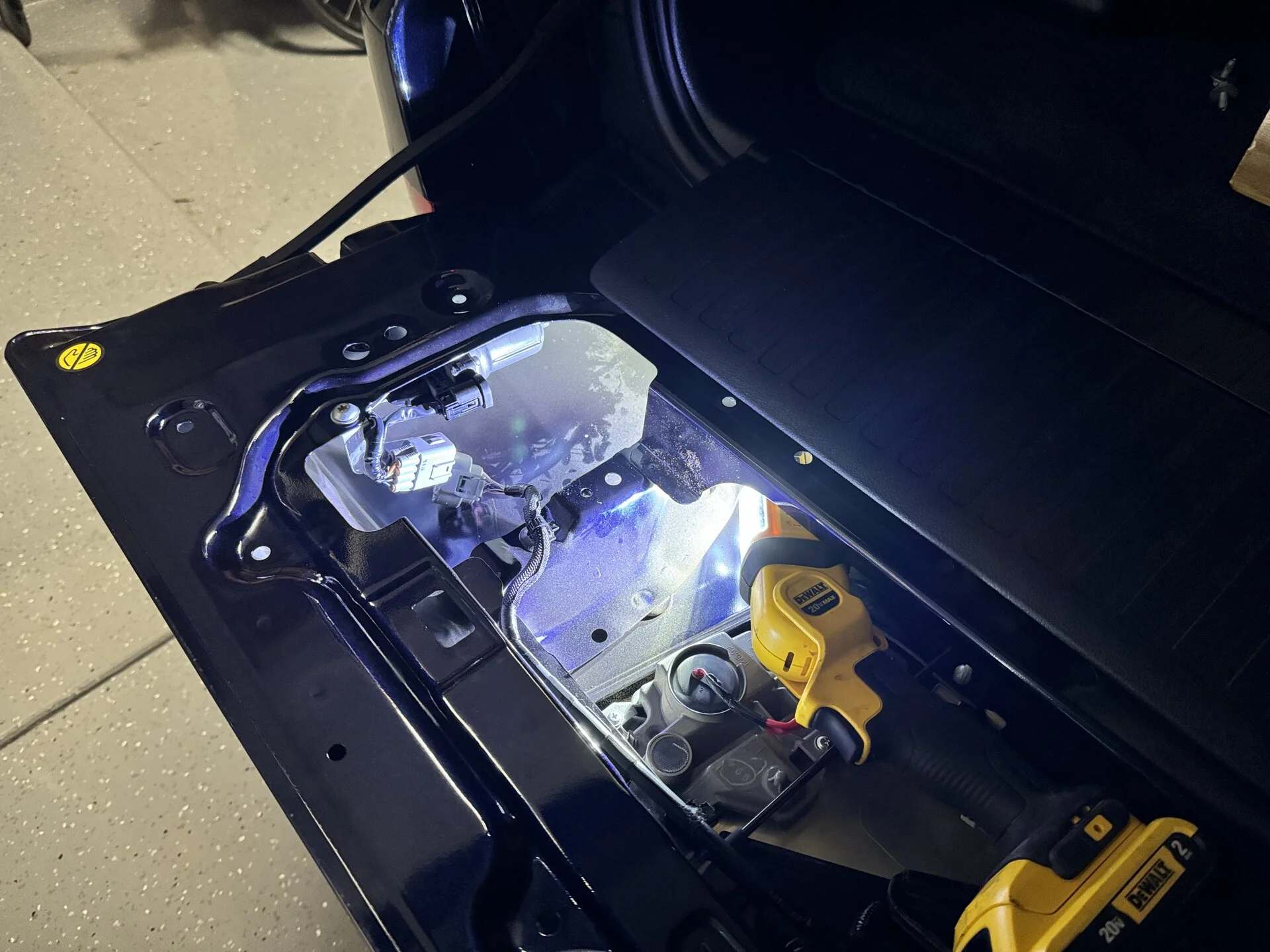

The tailgate has two lock assemblies (left & right). Toyota added the power assist lock assembly in 2018. If one fails, there is absolutely no way to replace it without getting the tailgate to drop! There are three bolts securing each one that are only accessible from the side of the tailgate which can't be accessed if it's still latched and one bolt on the top of the tailgate (in my case had to remove Trail Tailor locking storage to access that bolt).

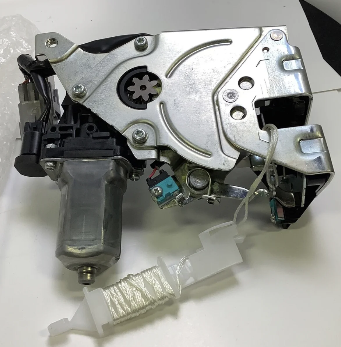

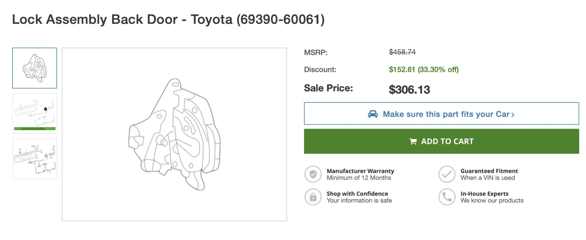

Ordered a replacement lock assembly (different or each side). Examined the part in detail since it's rare to ever get an actual quality photo when ordering online Toyota parts. Example:
Notice the updated part has a string attached to a lever. Hmmm. Why didn't my 2018 have this?

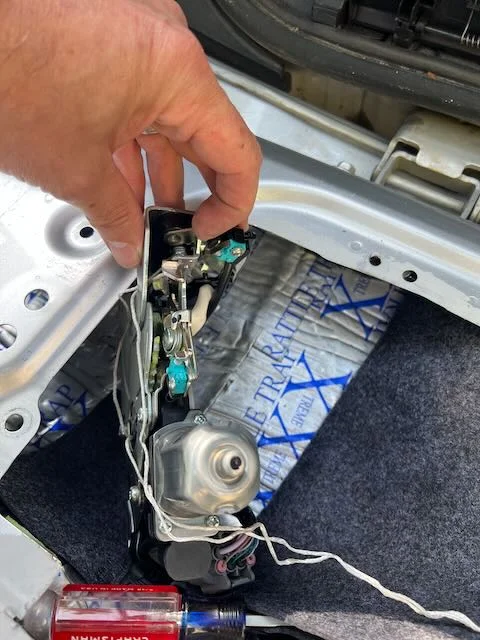

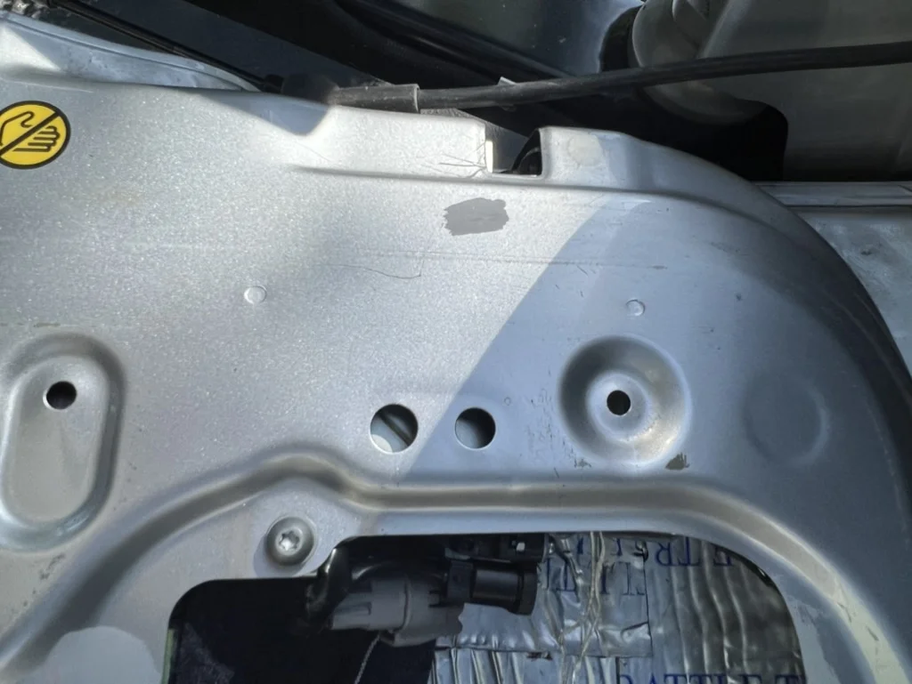

This gave me some clues. Inserted a borescope in the tailgate to help me locate the lever, pressed and the lock assembly released and tailgate opened. Detailed photo of my finger on the location of the lever.
While I had everything opened up, I removed the lock assembly on the other side and added a string (it didn't have one) in the event it ever fails.
This apparently is a design flaw that Toyota later recognized. Much easier to pull a string to release the locking mechanism.
FWIW - if you have drawers, it's going to be a big hassle to remove the factory storage area where the jack tools are installed as there isn't much room to work with when the tailgate is up. I was fortunate that I had the TT locking lid without a lot of gear in there where I could slide my hand and arm in there to release with my fingers. If this ever happens again, the damn string better work.

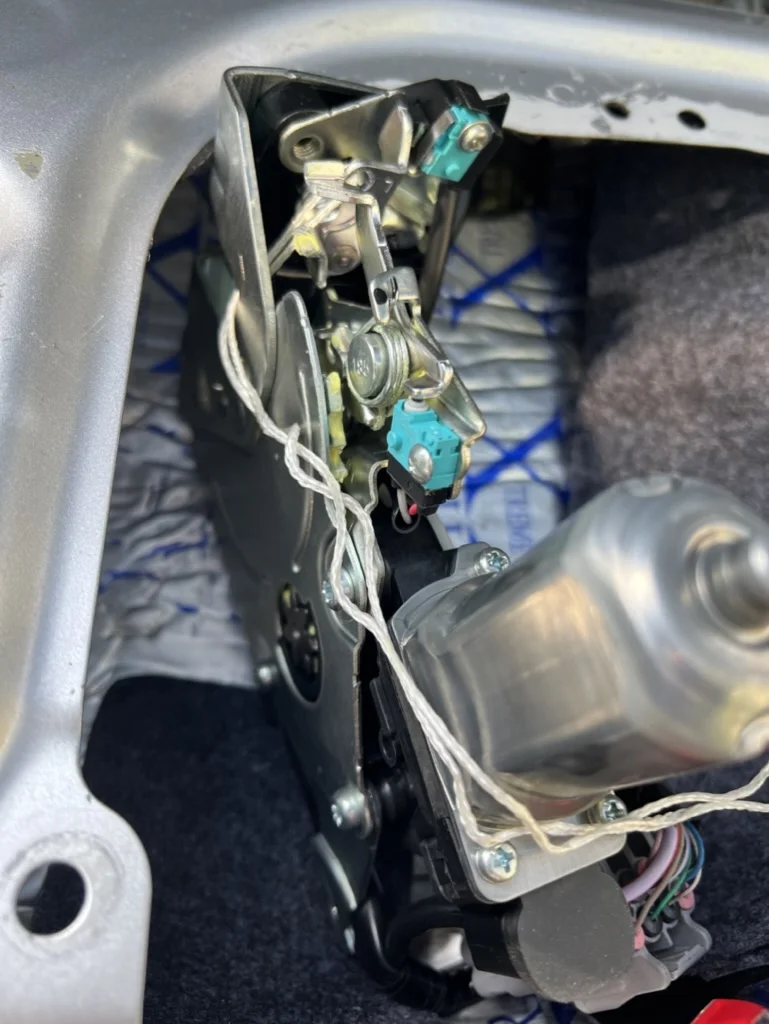

I dug up some pics from mine. My original (2018 LC) did not have the string. Here is a picture with the replacement with string. Notice where it connects. That lever that it's tied to is what you want to locate. Try and get a finger on it or extension and push it. From memory, I pulled the fuse so it didn't try to keep engaging.
The one that crapped out was on driver side. Pics below.
I took the right hand side out and added a string just in case it ever craps out. Pic below.
