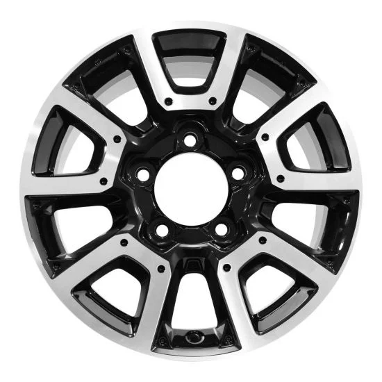

I'm getting some Tundra wheels (with the Tundra lugnuts) installed on my 2010 LX570. Do I torque them to the same spec as the original 20" wheels that came with my LX (95ft-lbs I think)?

I'm getting some Tundra wheels (with the Tundra lugnuts) installed on my 2010 LX570. Do I torque them to the same spec as the original wheels (95ft-lbs I think)?
Yes, 97 ft lbs for any M14 lug on our cruisers, doesn't matter the wheel
Yes, same torque. TPMS sensors aren’t correct, so you’ll need the swap them out. At least on mine, they were different.
Thanks. I used Denso 550-0103 TPMS Sensors and they synced right up.

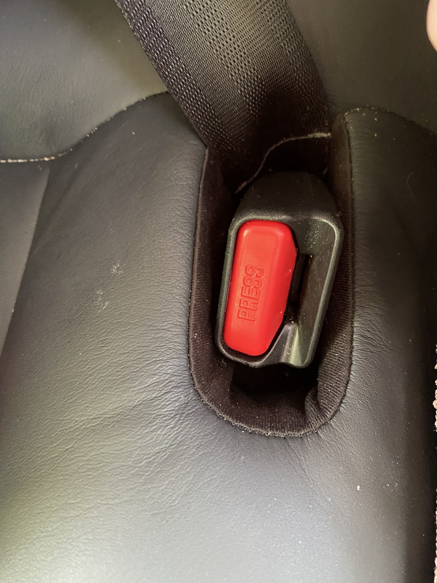

Hey, my kid just dropped a gobstopper in the buckle area of the rear of the driver seat. Is there a way to access this area to remove it. I ask because it’s 100 degrees right now.
If you mean the B pillar area, you will need to remove the sill plates of the front and back door then yank on the bottom of the plastic cover. It is not easy to remove.
Taking out the seat is only 4 bolts. I don’t think you can remove the plastic without taking the seat out.

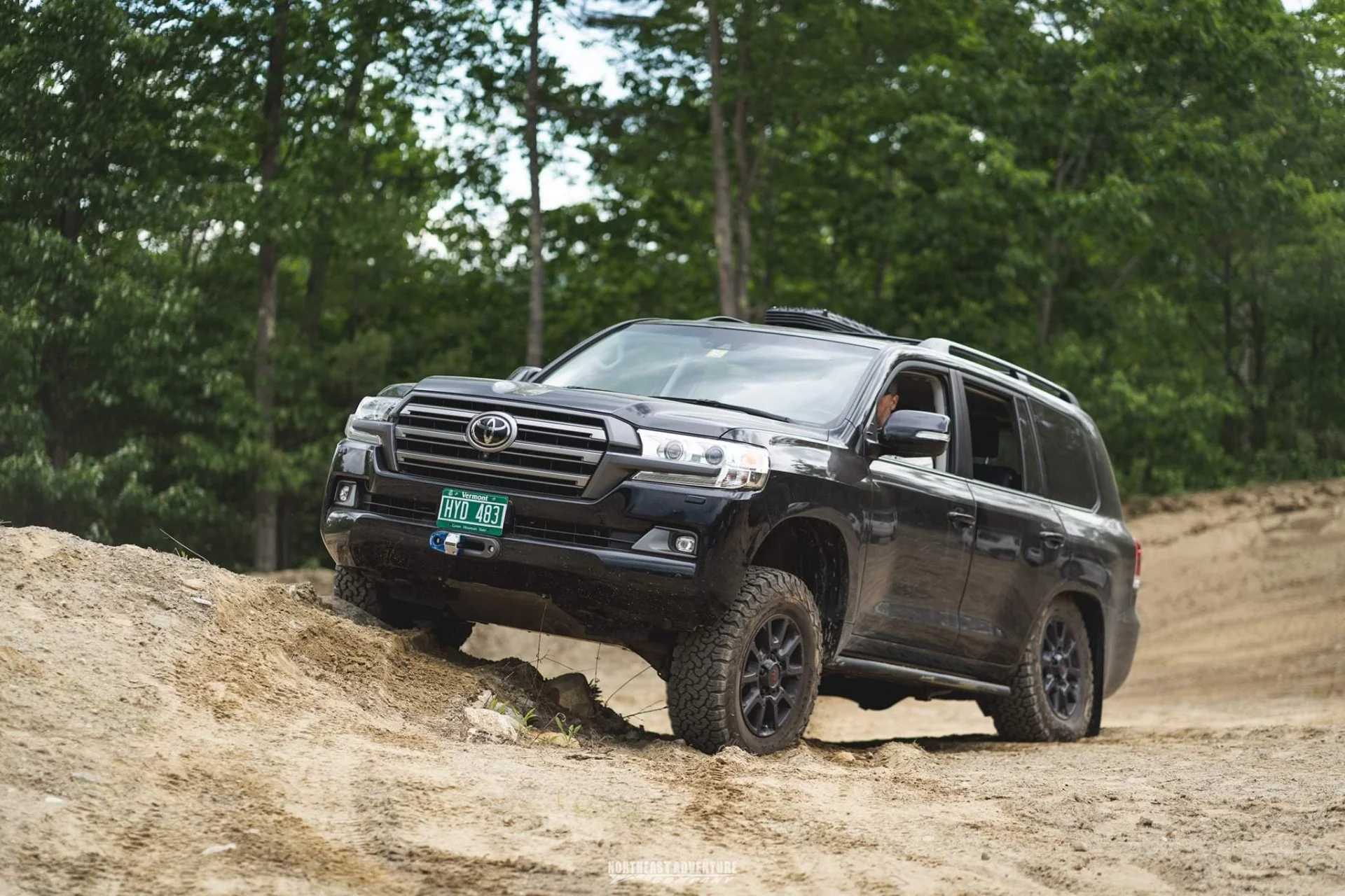

I’ve been doing some more technical trails and noticed that the rear mudflaps get hit when I come down off things (like a controlled roll down the backside of a good sized rock that drops straight down, for example). Are people trimming or removing the rear mud flaps to avoid this?
I've removed mine but it's a lot smarter to trim them. If you remove you will get dirt/mud/whatever else flung into the bumper skin which makes cleanup that much longer

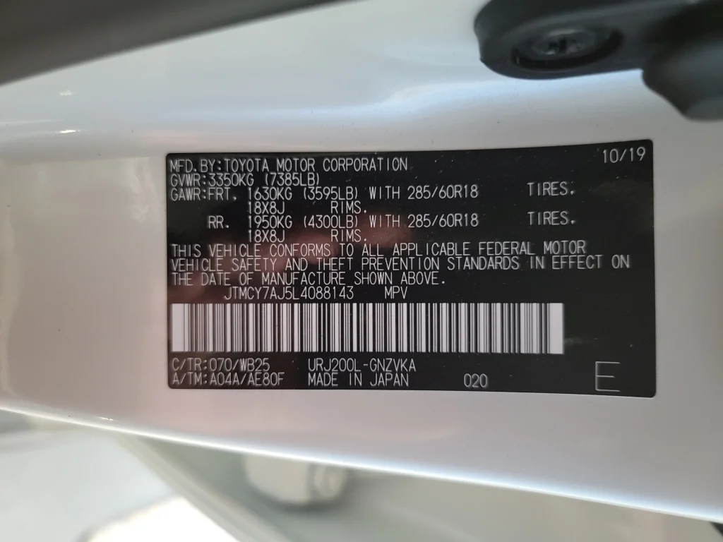

Anyone else with a 2021 Heritage Edition able to take a picture of their data plate on the inside of the driver's door? I'm away from my truck until mid July because I'm overseas, but searching for travel trailers. Looking for the "no s***" weight that Toyota is saying our trucks Gross Weight is. I'm tracking the Gross Combined Weight Rating is 14,400 lbs.
I know I need to weigh my own individual vehicle on a scale but looking for what Toyota has put on the sticker itself. I've read the towing thread, and definitely don't want to go over 7,000 pounds for a trailer.
Not a '21, but maybe a '20 HE will do?
Thanks brother! That matches the numbers I've seen online. While Toyota lists a curb weight of 5815lbs, with a listed max payload of ~1340lbs (610kg), I'd guess that the weight of just the vehicle with options is a little over 6,000 pounds. That gives me a great starting point, thank you!
