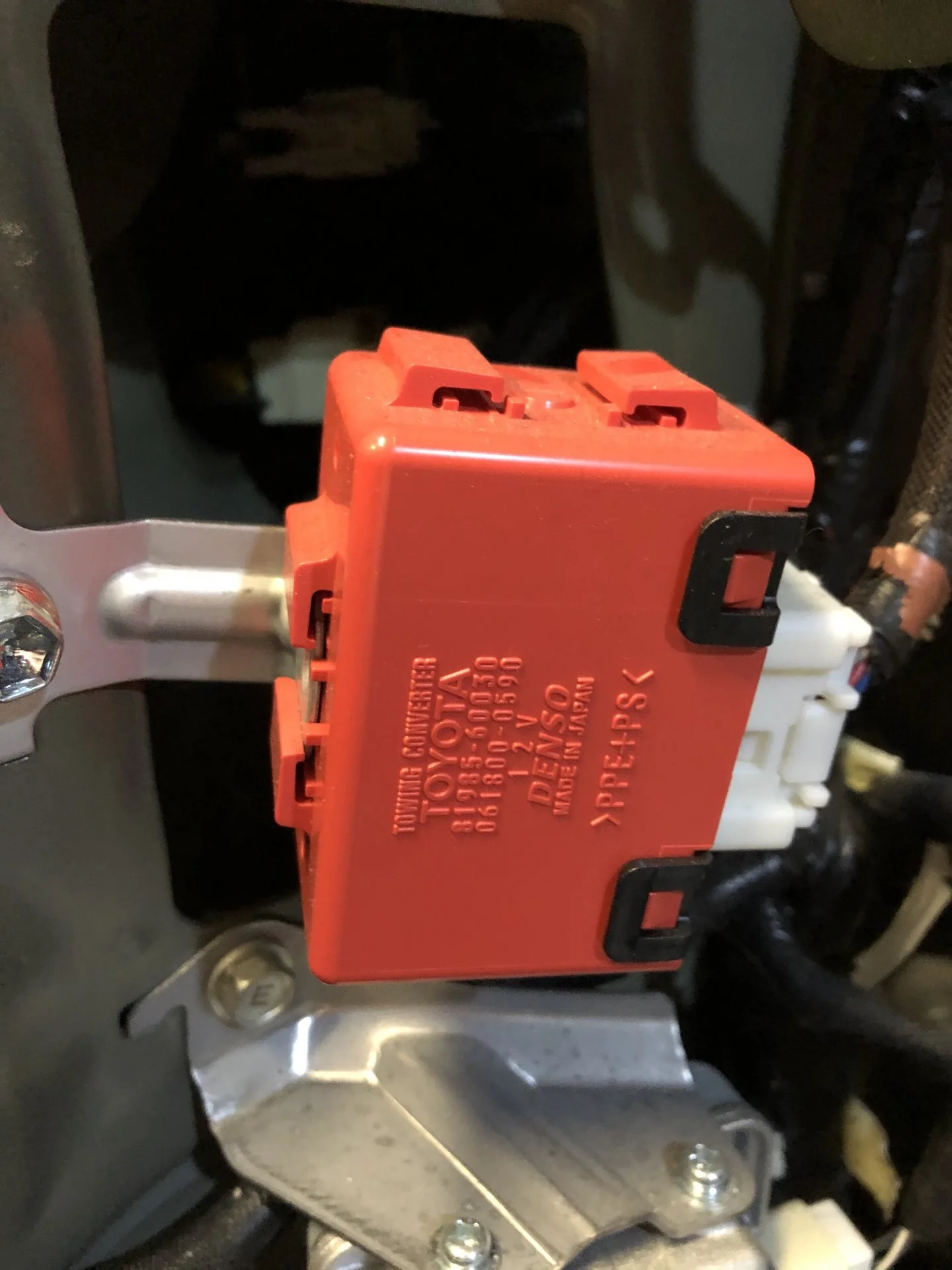

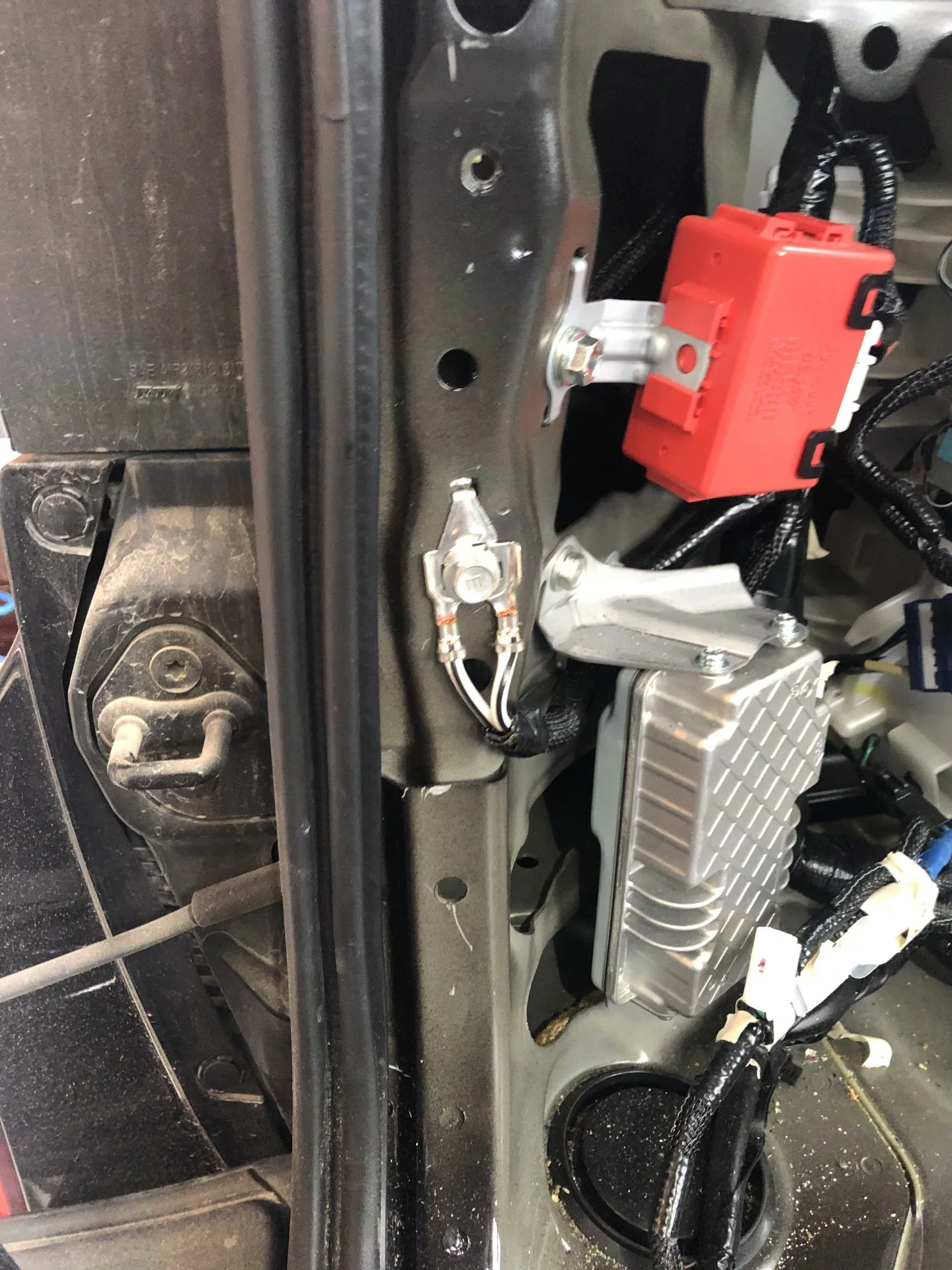

I found a switched lead at the trailer control box in the cargo area, if anyone needs one there. It is the thin black wire going into the red box. Confusing to me that a black wire is hot, but who am I to say.

Where is that trailer control box located, exactly?
Drivers side rear, red box.
Excellent, that’s pretty easy to get to. Thanks!
Yeah, I remember seeing that box when I added my rear outlets on the driver side last summer shortly after I bought the LC. IIRC, I used the ground connection that's just to the left of and below the towing converter mounting point in your previous photo to ground the circuits on the driver side. There's a pretty much identical ground point on the other side that I used for the passenger side circuits.

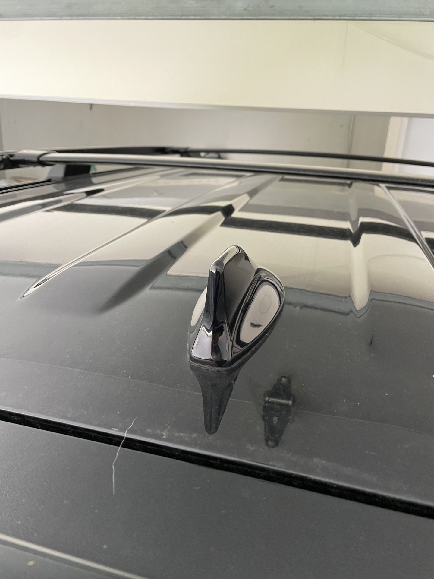

Does anyone else find that their shark fin antenna has a bit of play and has no rubber around it? I find that I can move mine around and up a little bit. Also there’s no weather sealant around the base as I’ve found in my other vehicles. Was wondering if this is just my truck or others find the same thing.
I’m concerned bc I recently went into a low parking garage which I think might if scraped it.

Same here

I was just up there sliding my canoe on the rack and checked the antenna. No visible weatherstripping and it does slightly wiggle.

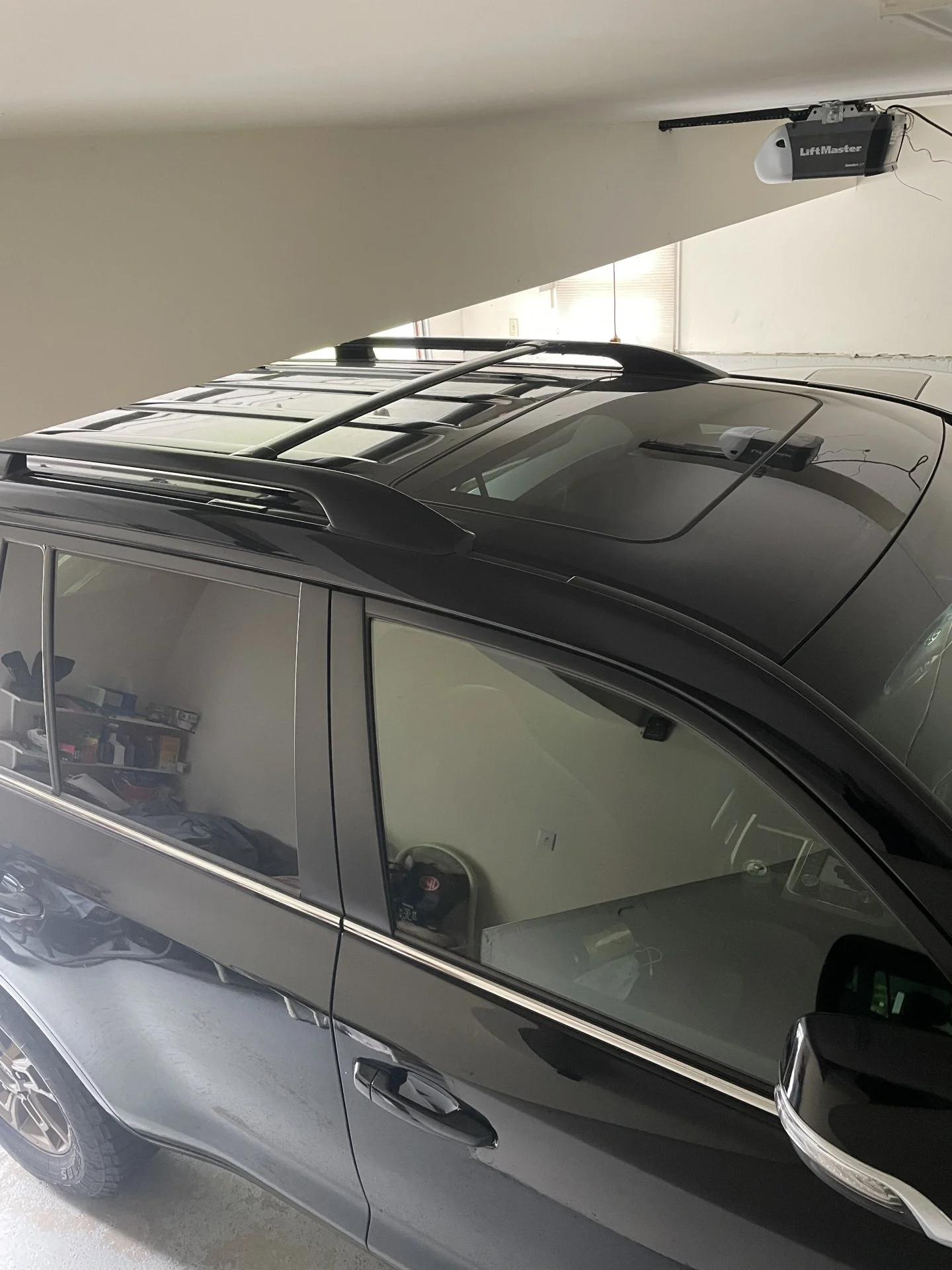

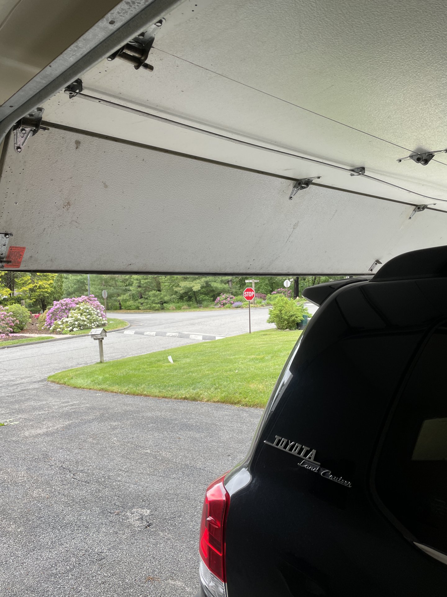

Thanks all. I done goofed. Visiting my parents I drove the truck on 32.1s (.5” taller than stock) into their garage. I only noticed afterwards that the garage door to ground clearance is only 75”.
I checked the truck for scratches but didn’t see any up front. The rear and shark fin does have scratches. I think it’s because the driveway is sloped so first 80% of the truck didn’t need to deal with the lower garage clearance. I only see some scratches on the rear portion of the rails and the shark fin.
The issue is I don’t have the luxury of driveway slope helping me with backing out.. Any ideas on how to get the truck out? Some I had:
  • Remove factory rails but that wouldn’t address the shark fin. Also the procedure appears to be a pain
  • Weight down the truck so it sits lower and back it out
  • Remove the other car in the garage and do a 3 point turn in the garage to benefit from slope
  • See if I can get the garage door to open up a couple more inches — I like this one the best since I don’t need to mess with the truck
PS yes I feel extremely foolish

Disconnect the garage door from the track by pulling the red handle. See if you can push it up further by hand.
If that doesn’t work airing down would be easier than adding load.
And also don’t cry over that dang shark fin.

Drop your air pressures to 15 psi (or as low as you are comfortable going) and drive out slowly. Have a spotter on a step ladder make sure you are clear as you SLOWLY back out. Air up once you are out of the garage.

Quick update: I brute forced the garage door open basically standing overhead press to get it up 2-3 inches while wife backed it straight out. Even then the cross member hit and the rest barely made it through. Would of been pretty bad otherwise so happy to escape with a few scratches.
This would of been a GREAT idea that I didn’t think of hope some other poor soul comes across it

For next time, there should be a dial adjustment you can turn with a screwdriver to set the stopping point for the door. Based on the limited pics, it looks like it should have some room left on the track to roll higher.
