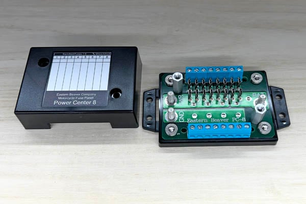

If you aren't tied to a specific fuse block, there are options that can handle switched/unswitched circuits in a single block. Here's 1 example I found that might be a good option:
It sounds like it was originally designed for motorcycle use, so it's compact.

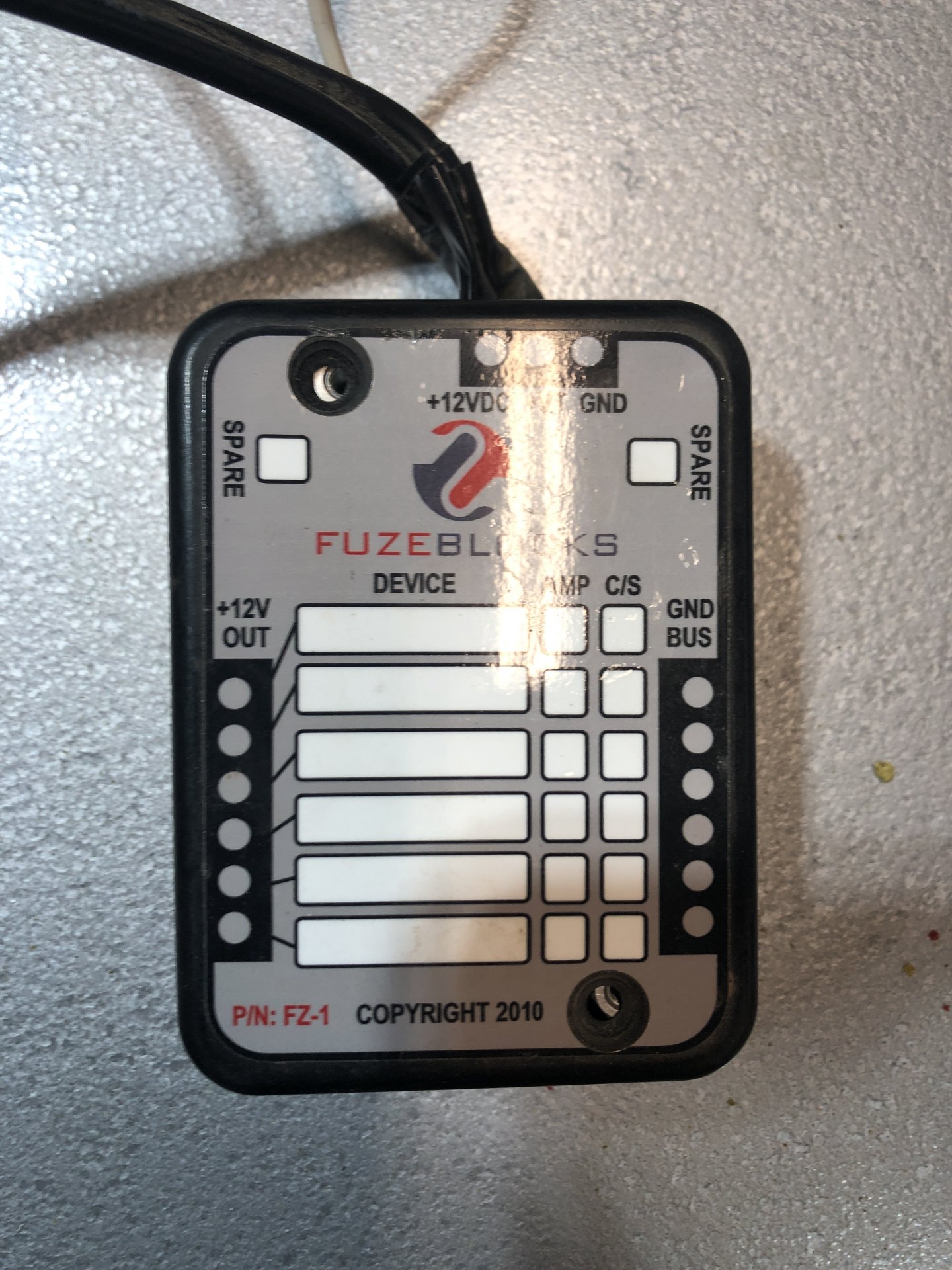

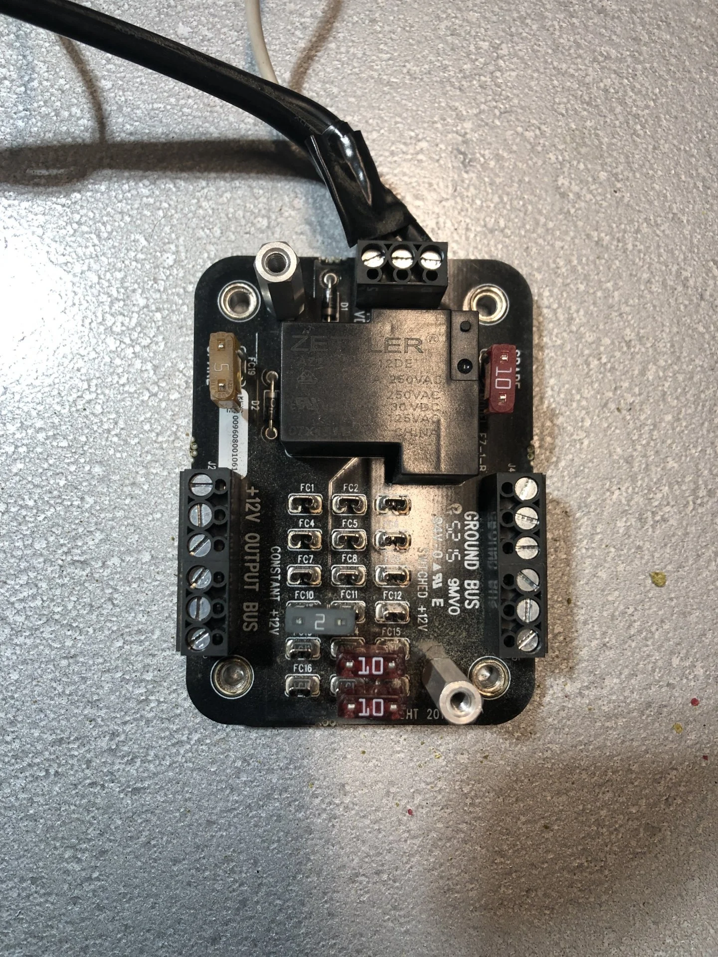

@linuxgod This post made me think of a device I have from a motorcycle called a Fuzeblock FZ-1 - it is similar form factor, but has the ability to have both ignition and always on, depending on how you place the fuse.
The only thing is, it has these screw clamps where you connect wires directly, not using a terminal like you would on the BlueSea panel.
It might be an alternative so you can have both switched and unswitched circuits.
The black module at the top of the unit is a built-in relay. On this one, there are only three fuses, the others are “off”. you can place the fuses to decide which circuits are constant on versus switched.
In mine shown above, the 2 amp fuse is set up for constant power, whereas the 10 amp fuses are set up to be energized when the ignition is on (or whatever 12v signal you might use for switching). I seem to recall having my auxiliary lighting on the ignition switched circuit and my gps on the constant, or something like that.
I could imagine using the switched circuit on your daughters phone charging port, and constant power on interior led lights and some other bank of charging ports that you use with the vehicle off, for example.
One thing is that you may be limited in the amount of amperage you can handle. These wires I used on a motorcycle are MUCH smaller size than the large gauge wire I ran to the cargo area in my last land cruiser.
Maybe you could run your large gauge wire back to the 100amp blue sea distribution panel, and then use one of the branch circuits off the BlueSea panel to run to this device that you run your additional switched circuits off. It would basically be the same as the relay idea proposed earlier in this thread, but a lot more tidy an install to handle multiple circuits. And you could hook up the more power intensive loads like fridges, etc, to the BlueSea.

Nifty. I might have to try that. Thanks!

This made me think of a device I have from a motorcycle called a Fuzeblock FZ-1 - similar form factor, but has the ability to have both ignition and always on, depending on how you place the fuse. The only thing is, it has these screw clamps where you connect wires directly, not using a terminal like you would on the BlueSea panel. It might be an alternative?
The black module at the top of the unit is a built-in relay. On this one, there are only three fuses, the others are “off”. The 2 amp fuse is set up for constant power, whereas the 10 amp fuses are set up to be energized when the ignition is on (or whatever 12v signal you might use for switching. I seem to recall having my auxiliary lighting on the ignition switched circuit and my gps on the constant, or something like that.
That's just about a perfect option, including the super small size. The 12 gauge wire limitation on the power input is a bit unfortunate, but it would probably be fine to use 8 gauge from the battery for the long run to reduce voltage loss and then use one of those reducer butt connectors to go from 8 gauge to 12 gauge for the last few inches for connecting to the terminal block. The ability to choose constant or switched power for each circuit is really nice, as is the integrated relay.

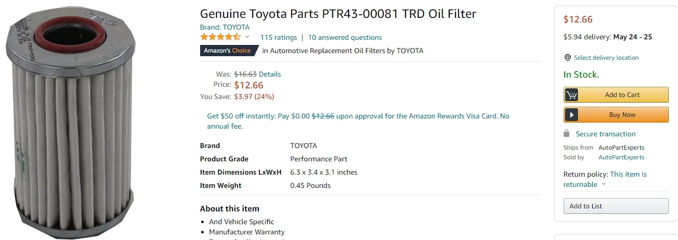

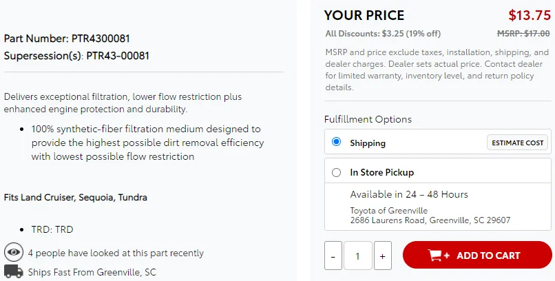

Getting the stuff to do my first oil change on my 21 HE. The McGeorge website says I should use the TRD oil filter: 2007-2021 Toyota Trd, Oil Filter PTR43-00081 | Toyota Parts - https://toyotaparts.mcgeorgetoyota.com/oem-parts/toyota-trd-oil-filter-ptr4300081 at 13 bucks each.
Is this different than the standard 04152-YZZA4 filter? Can get a case of 5 filters with O rings on amazon for 25 bucks from a dealership.
Any reason to use the TRD version?
Yes, it is different. Both the standard and TRD cartridge filters fit, but the TRD one seems like a more substantial and solidly built item with a metal cage and nicer gaskets. Who knows if it filters any differently? Not sure I’ve seen anyone test them. For a couple of bucks difference, I use the TRD filters. You should be able to find more feedback if you use the search feature.

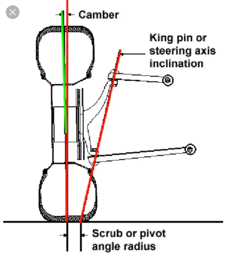

@linuxgod are those spacer sizes for each tire size assuming stock height? Once you lift the vehicle, don't you need more spacer to compensate for the scrub radius changes (moving the centerline of the wheel outward to dial out changes in the scrub radius)?
@TeCKis300 is the expert but I believe the answer is that lift doesn’t matter since you’re only changing the “neutral” point in your IFS suspension arc and thus the kingpin angle stays the same. I may be mistaken though.
Agree with @linuxgod. Simple answer is that scrub radius geometry is not directly affected by lift.
This diagram may help. You can see that the scrub radius relationship to the tire footprint is defined by the pivot points on the suspension upright. That doesn't change with lift, i.e. angles of the UCA/LCA.
