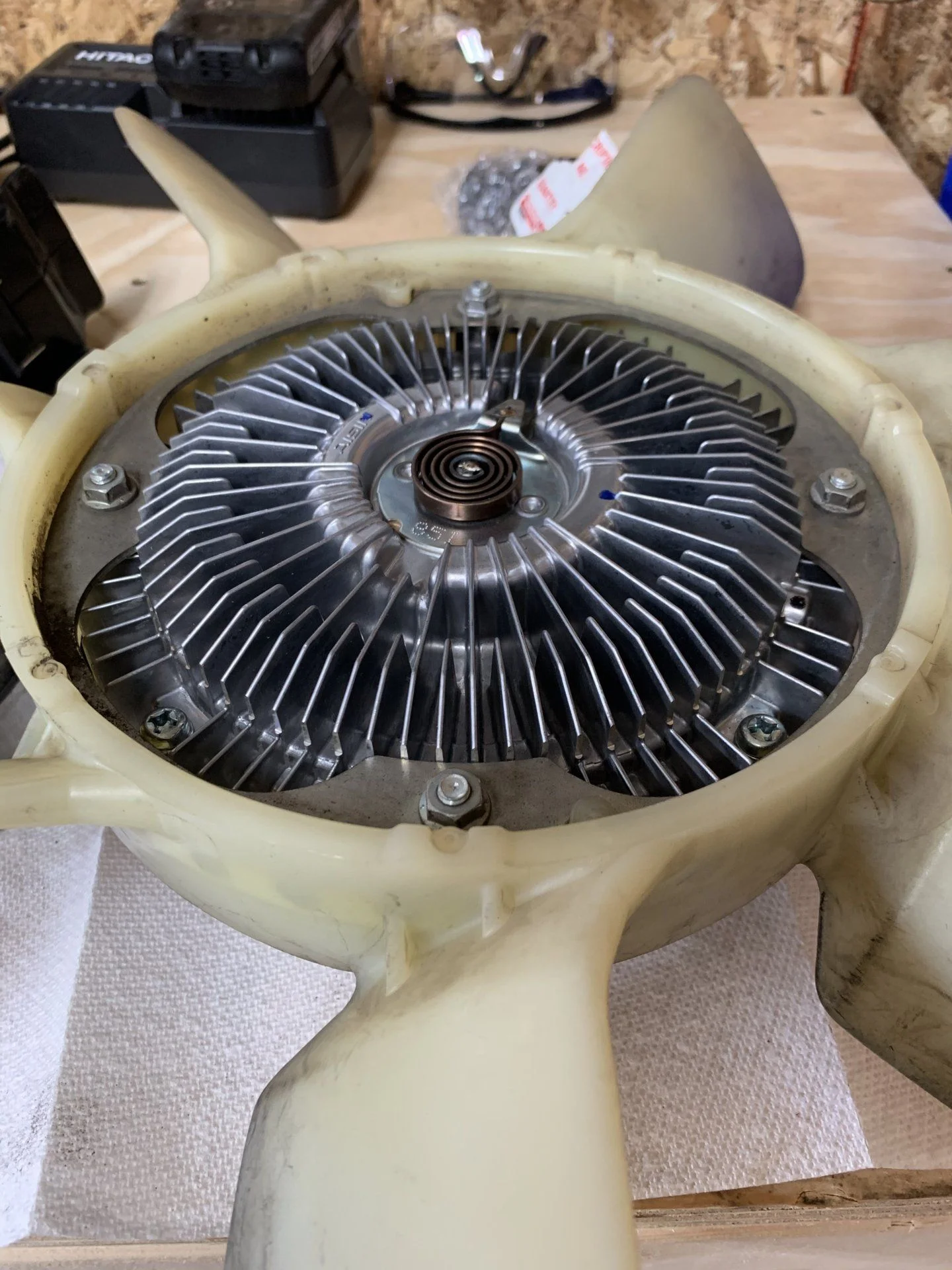

Do I have this fan clutch/blade in the correct configuration? Matches my 80's set up where the fan blades deeper pocket side goes towards the clutch.

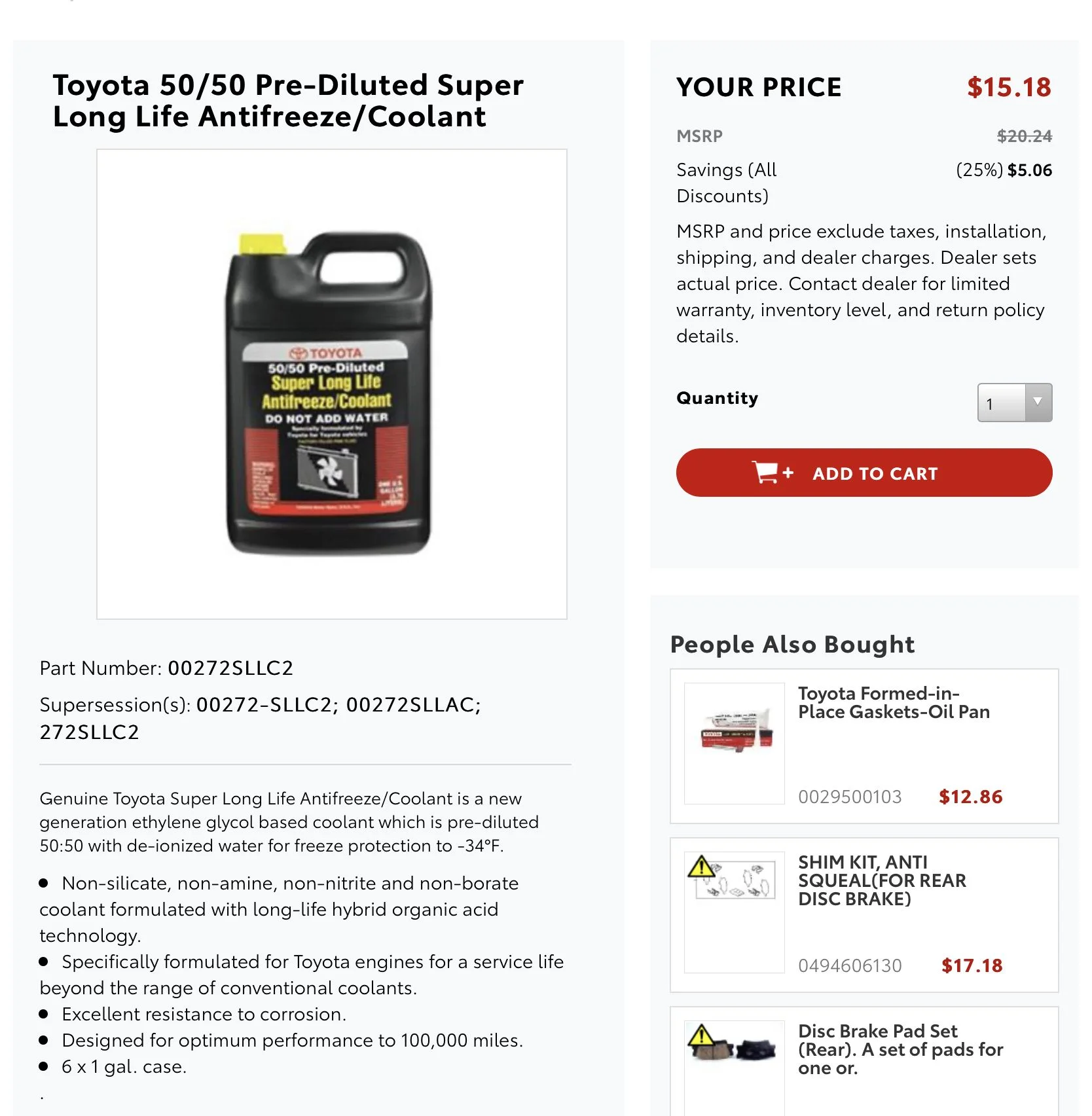

Yeah thank you. I remember it being at full at the start of winter too. I know there is a Toyota specific “red” coolant, and there is a thread from a long time ago about red vs green. What is everyone using for the red?
toyota super long life only
Your truck calls for Toyota SLLC (super long life) which is the pink coolant.
00272-SLLC2 about $15/gal
