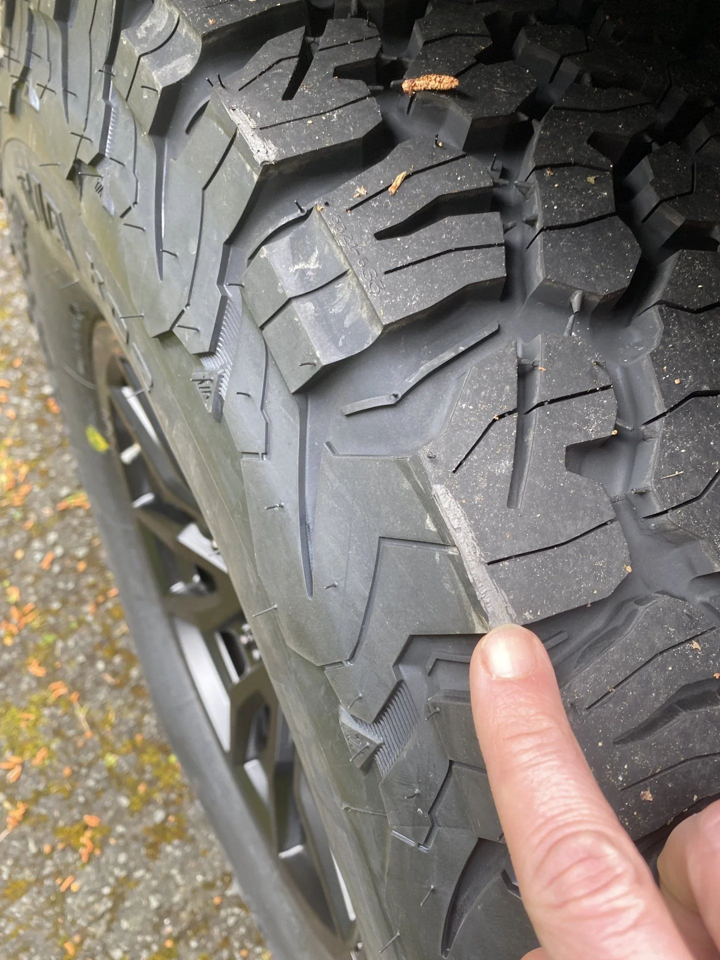

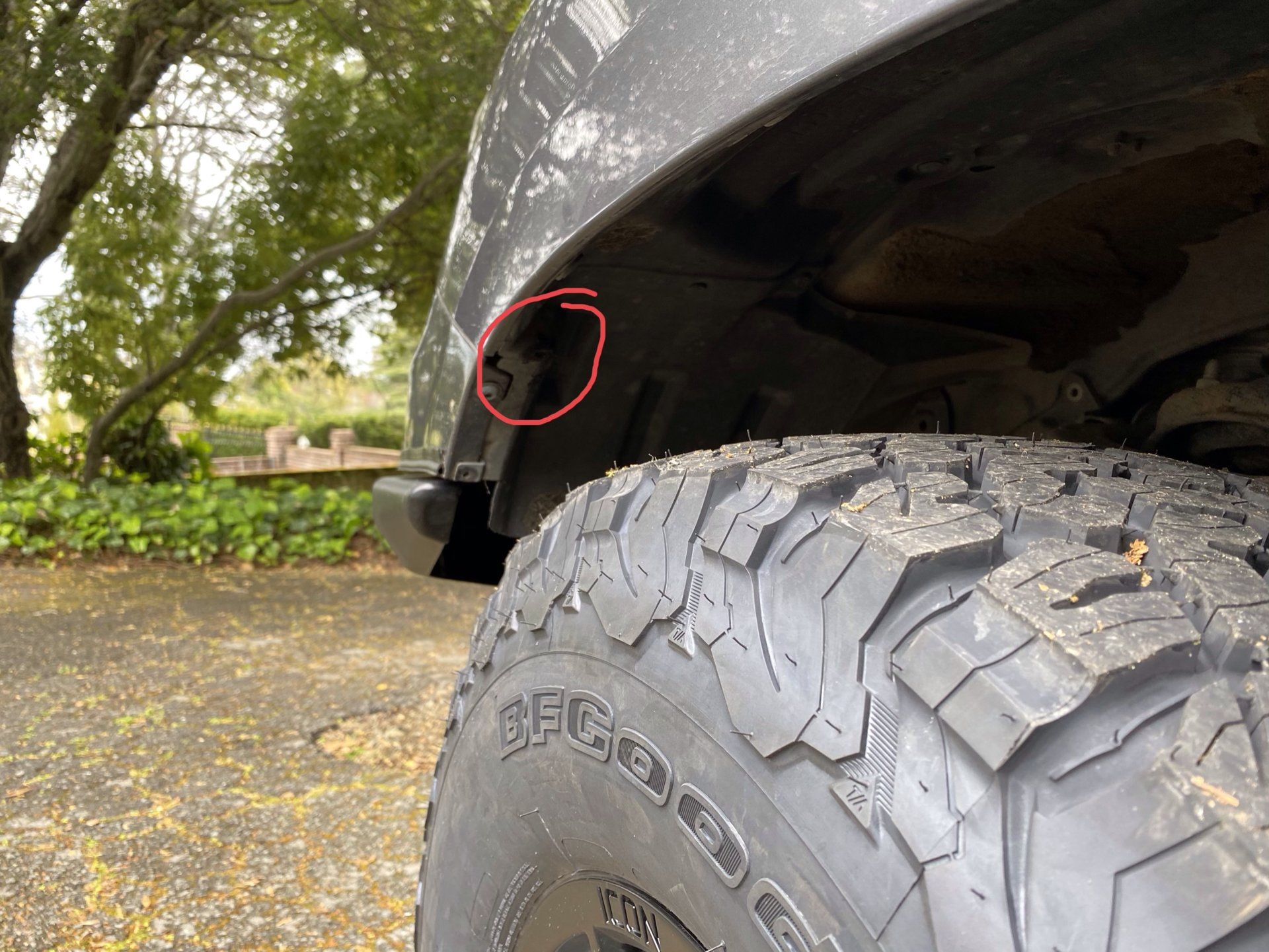

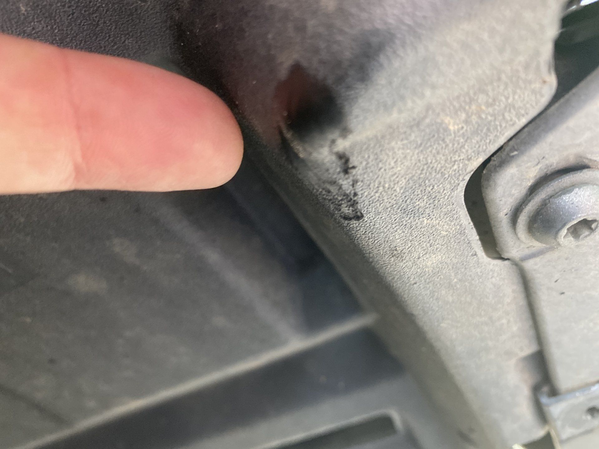

Ok. I posted this question in the LX pic forum but though this might be a better place. I just installed 17” wheels with 285/75/17s. While I have no rubbing on full lock as far as I can tell at this point, what I do have is occasional rubbing while driving at speed on the highway and hitting a dip that causes deep compression. The rubbing is on the outer edge of the tire against a protruding edge of the liner just inside the wheel well. I am trying to figure out how to handle this. Any suggestions would be much appreciated:
View attachment 2252394View attachment 2252395View attachment 2252396
Top plate spacer might give you just enough clearance to prevent this. ...And it would level things out a bit.
Part# 43136-60020
Part# 43136-60020
Thanks.
I’ve been considering this anyways, but I was hoping to wait for a while. If i can’t find an easy solution, I may need to move this near the top of the todo list.

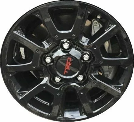

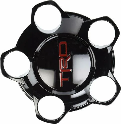

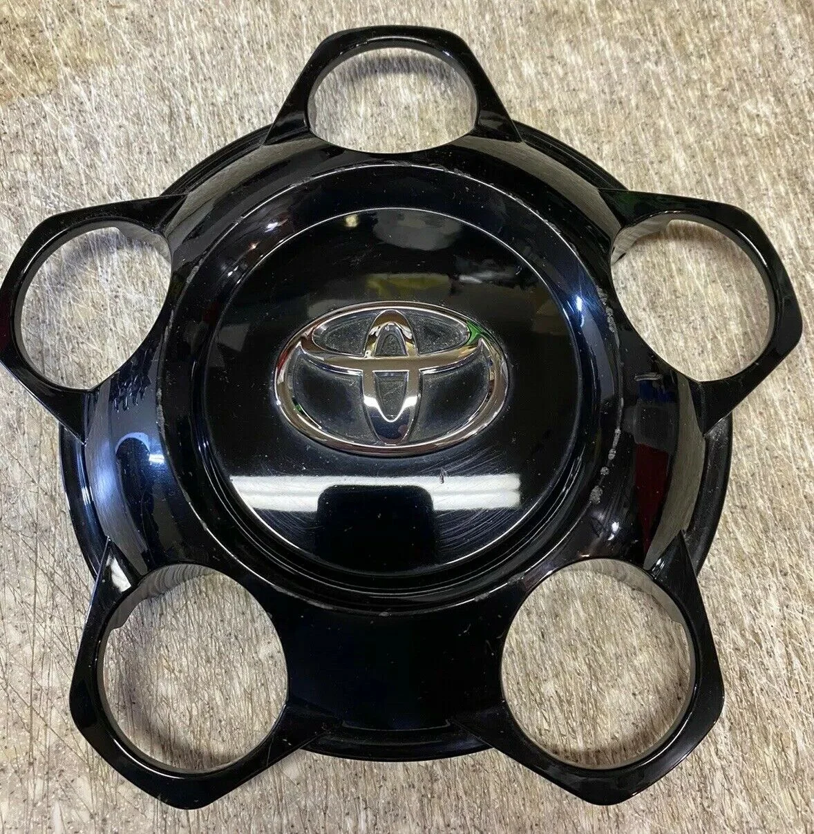

I am going to be removing my winter set-up in the near future. I will be mounting KO2s on a set of TRD Pro rims. I have the previous generation TRD Pro rims. See pic. I have TRD Pro center caps. I am wondering if the regular Tundra center caps that are all black with the silver Toyota will fit the TRD Pro rim...? The part number for the all black center cap is 4260B-0C040. Looking at pictures they look the same...but would like to confirm they fit before I buy 4 of them. Anybody here running all black center caps on TRD Pro rims? It's not that I don't like the TRD Pro center caps, I just prefer the all black. TIA!
