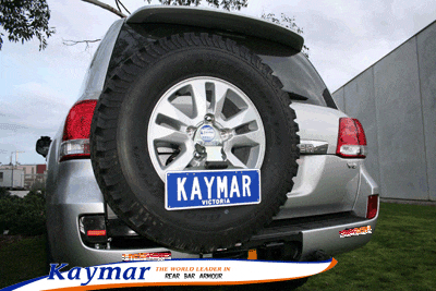

On my 2016 LC I would love to be able to mount my spare on the rear of the vehicle without having to add a metal bumper. Do I have any options at all or do I have to add the heavy arb style bumpers ?
I know when I visited the middle east a few years back I saw spares on a 200 series mounted on the rear without an arb style metal bumper.
I know there is a hitch mounting tire setup but the huge gap would drive me crazy.

The hitch-mounted option from Wilco is actually pretty nice and there's not a ton of space between the vehicle and the tire. I ran one for a while. In any case, technically, it'd be possible to cut a hole in the plastic bumper and weld something into the rear cross member that could handle a bumper. It'd be a neat custom project. Do some searching in the 100 series forum... I feel like I've seen this somewhere.

Will do thank you. Did you have any pics of your LC with it on ?
I came across these:
They are custom-ish. Much less space between hatch and spare.
That is exactly what I want. Thank you ! Now continuing to read indycole's beautiful build thread!
I love this forum.

Get a Kaymar tire swing. It mounts to the frame (super robust) through a reflector hole and doesn’t loose departure angle like a hitch mounted tire carrier does.

They work for all 200s. The cut lines are different that’s all. I’ve installed those swing arms on a 2016, they fit beautifully.

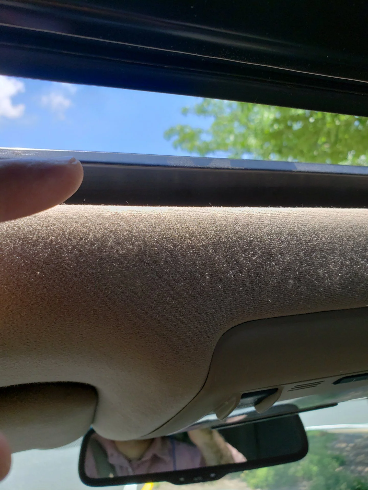

Opened the sunroof today, and now it's not closing. I'm heading into work so don't know how to play with it to fix it. But the deflector that comes up when you open the sunroof isn't closing properly. Would some WD40 make it work again? Here is what the problem is..
