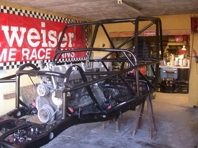

Here's what she looks like tonight, all naked and ready for a bath and some make up!

Damn I got a s***load of work to do before next Wednesday. The painters have the skins, and AJ has vowed not to let me see the finished "bling ass" paint till he attaches the panels and rolls it out in the daylight. Stay tuned......................

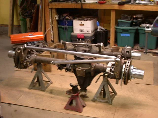

Mike, I can't wait.....got a little work done on mine last night, actually "suspending itself" entirely now.
gotta like the <bling bling> 6016 aluminum t-case plate adapter....hehehe

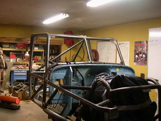

White boards in the shop. Great idea. I've got a list on the window of each project with all the crap yet to be done. Works in my situation, but if it was my own personal garage, the white boards would be a good idea.
I like the super secret engine cover too. :D

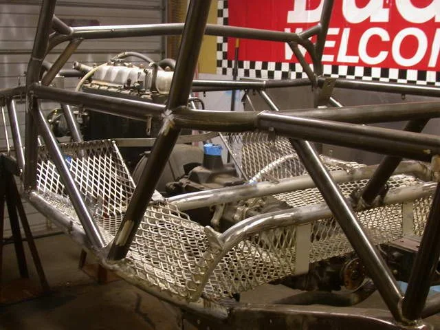

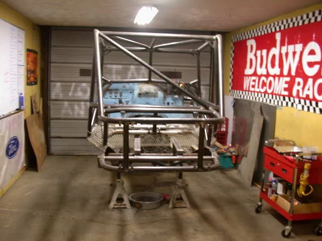

Last pics before the chassis is painted today. Cut the firewall back and made the footwells out of expanded metal. Firewall will bolt in, whats left of it.

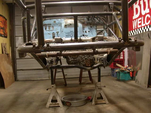

Winch mount welded in. The mounting holes will be sleeved thru the tubing once the 'NEW" T-MAX http://www.t-maxwinches.com/winches/winches1.html arrives. Yes thats a lot of frame hanging out front. Rules require it to extend past the front edge of the tire.

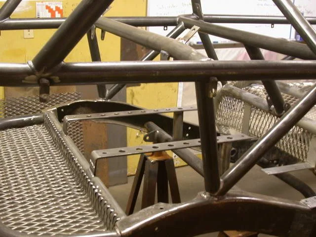

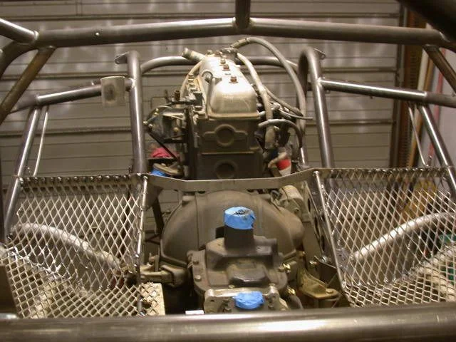

Expanded steel basket across the inside of the ass end. Gonna hold those "cold refreshments" and recovery tools. The fuel cell mount is just in front of it.

Another shot of the floor and firewall support. New aluminum tranny cover will be fabbed later.

Looks great man! Hell, Tanny, engine and hood make it more Cruiser than mine I think ???
Anyway, I love it!
2 Questions,
1) what happened to the *BLING* bezel you guys guy out of metal, all the shots I see of it now have a flat plate up there.
2) How hot is it not having a floor in that thing? I cannot imagine! I guess when you make the full dive next year to V8/Auto you will get the FULL heat treatment ;)

We made a bib out of 1/8th aluminum and it's out with the panels being painted. Airbrushed grille (right side up). It's been trimmed to fit the tires at full stuff/lock. No electric lights at all are planned as of now.
The floor open may actually be cooler. If I was moving faster it might heat up, the exhause was run right under my seat before. regardless I never had a heat issue that I noticed. The floor rules for next year require closed panels, so this would have to be changed if I run this rig again.

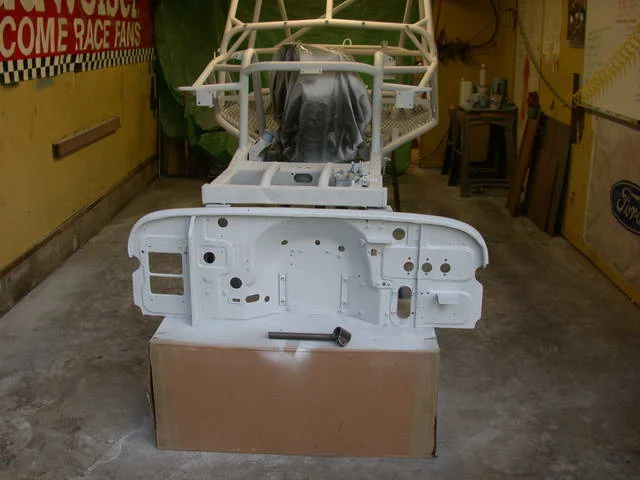

The primer is down, gonna let itcure overnight and shoot the black on Sunday.

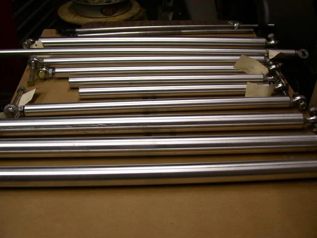

Some bling, cause I can! All 7075 aluminum links, 2" and 1.5" uppers. The chassis paint is going on now, tubing is a bitch to paint even with a decent gun.

damn....I shoulda painted my links in alum-colored paint! SUHWEET stuff there!
